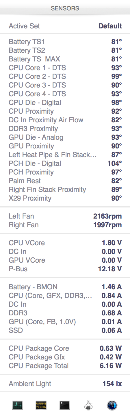

I got a 15" Late 2013 rMBP. That's after running it for about 2 hours just doing Word and Chrome at about 75% brightness. I have no cases or skins on my macbook.
Edit Removed the picture because it was huge. Click the thumbnail.
Those temperatures are pretty high, but thats also largely in part by the fact that your fans are still at minimum speed.
These temps are sky high

I had about a dozen or more rMBP late 2013 15", fully maxed out. I got at minimum 90C when working, and up to 100C. Keyboard was hot and not usable for me.
Apple is horrible at designing proper cooling.
Actually, no, they are not. They are within normal tolerances for the CPU. There is not a single thing wrong with them.

Incorrect again. iStat reports temperatures for the heatsink on the CPU, not on the die themselves. Its value is correct for what it is reporting.

As has already been demonstrated in the thread you created on this issue, the cooling is fine. The heatsink could be better designed, and the thermal paste could be of higher quality and better applied, but there is not a "problem" in any way, manner, shape, or form.

That person is getting 100 C on his CPU while running Word and Chrome, and you are saying that is absolutely normal?
Probably. We don't know whether he has the dGPU, but either way, Chrome can be brutal and, if he has the high-end model, will fire up the dGPU. If Chrome means a bunch of Flash-intensive stuff running plus Hulu/Netflix/etc., temps can spike. If he posts something where he's not running anything for a while, and those numbers look abnormal, then something may be wrong. But using the word "Chrome" as if it were synonymous with "low load" is silly and wrong.

Sorry if I forgot to clarify, that's fahrenheit.
I have the dGPU, but it wasn't running.

Sorry, I'm not trying to be obnoxious by double-checking here, but are you sure? Chrome often fires up your dGPU, unless you explicitly use something like gfxCardStatus to tell it not to. I just want to be sure.
Can you perhaps boot up your machine but keep all apps closed for, say, 10 minutes, and then post a screenshot of your temps then? That would be instructive for creating a baseline.
