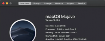

I run my iTunes server off a similar Mac Mini:
As storage I used to have a cheap NAS but they are all quite underpowered (as long as you are looking at ARM-powered models).
So I went back to a DAS - Drobo 5C.
Mini is connected to aTV 4K via gigabit eth, AirPort Timecapsule 4gen being the hub.
Your problem must be somewhere else, this combo should be perfectly capable of serving iTunes library.
