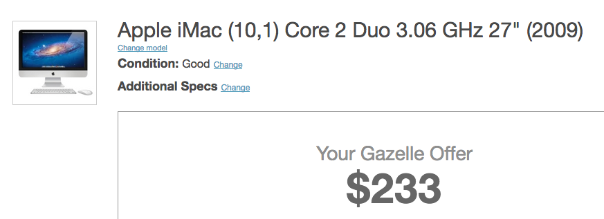

If the above looks decent for what he's selling it for ($800) then I will try the diagnostics that you kindly mentioned.
Gazelle.com purchases this model for $233, so $800 sounds like a high price unless new hardware has been added. A 1 TB HDD and 4 GB of RAM is very minimalist these days and I would consider it under-powered for the development work you mentioned.
DONT purchase it if it's $800. You can get a used 2011ish one with higher end specs for that much.

To the OP: I would not go any older than 2010, the core2duo is really too outdated now. For that spec I would pay a max of 300-400 USD if you still consider, 800 is a joke.
