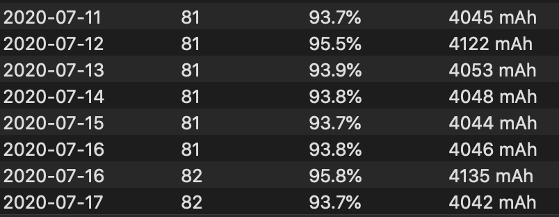

Basically popping back from 96% to 93% and back.
This doesn't bother me, just want to make that clear - just an observation. 🙂

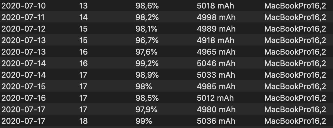

Here's the last week for me:
I think I'll have to wait and see how the condition changes over the next few months, while using Al Dente. If it remains in those high percentages then I'd be very glad!

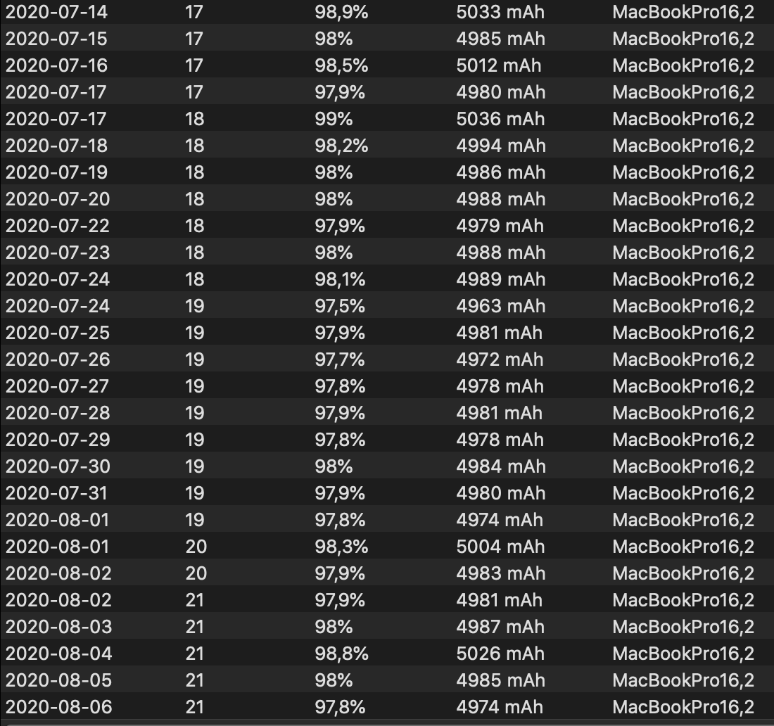

Here's how the history from the last few weeks looks like: (I do 1 full cycle every 1-2 weeks but I plan to do that more rarely in the future)

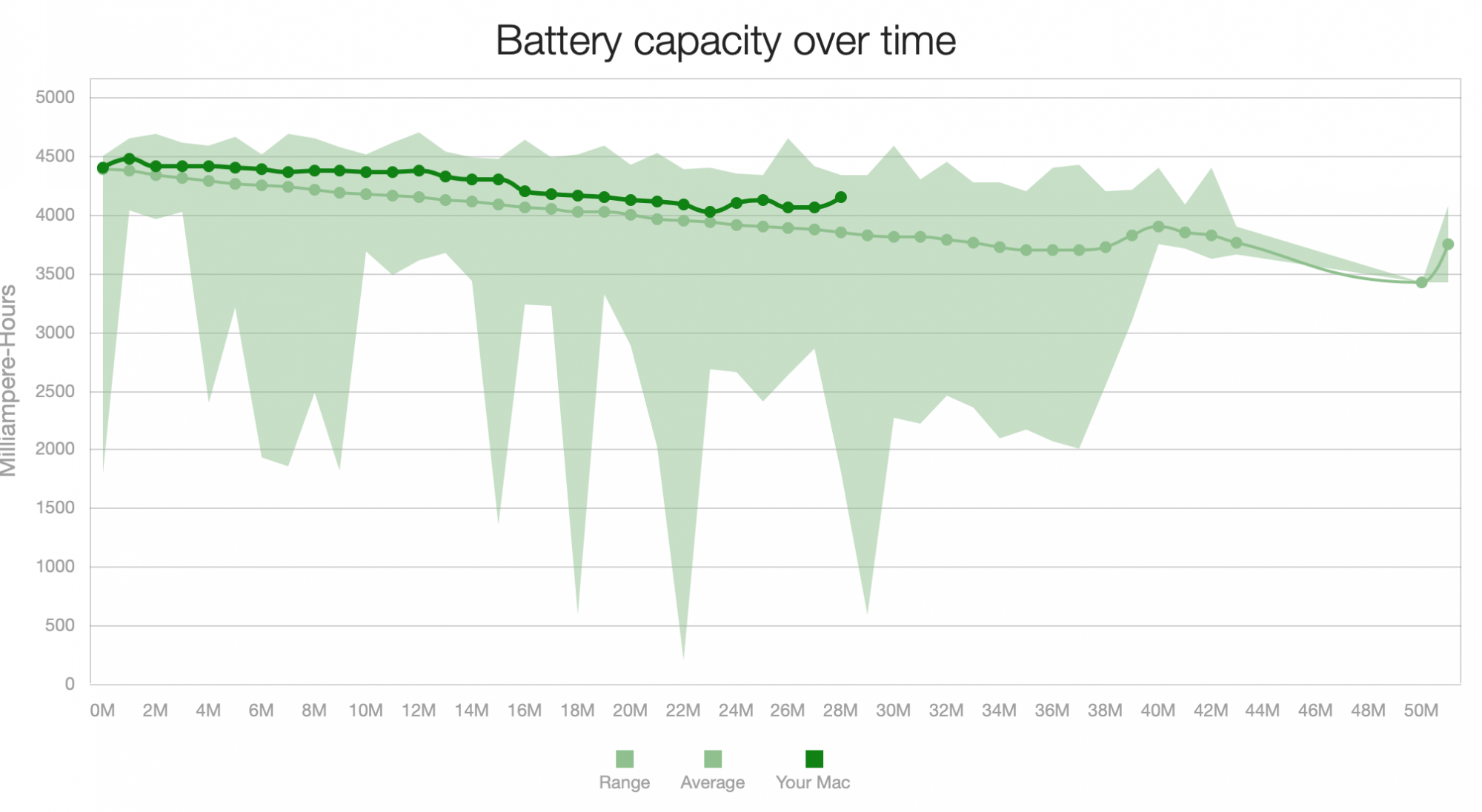

Just checked coconutBattery history online and wow...
If this isn't a stark reason to use Charge Limiter ... I don't know what is. Health is going back up! 😛
28 months old now.
