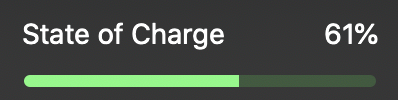

Here's what my data is showing at the moment. System info, coconut charge state, macOS charge state and AlDente limit setting.
I've been on 65% for a few days already but I am also using the macos battery health option and I do some mini-cycling every now and then below 65% and back up. Sometime next week I'll probably go up to 90-100% and let it drain to 20-30% or something, then back up to 65%. I'm not entirely sure if I can still maintain calibration if I do not go to the extreme ends.

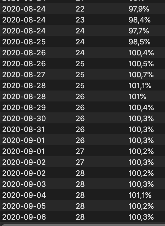

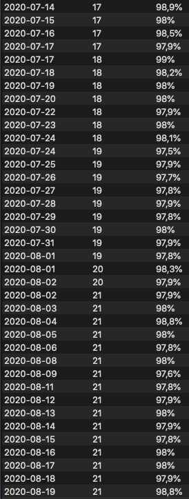

BTW, here is my supposed battery health log:
This is after my mac shut down at 17% and I did 3 full cycles and an SMC reset. IDK if it's correct but it's sitting consistently a bit beyond 100%. I'd like it to be correct, but who knows. 🙂
