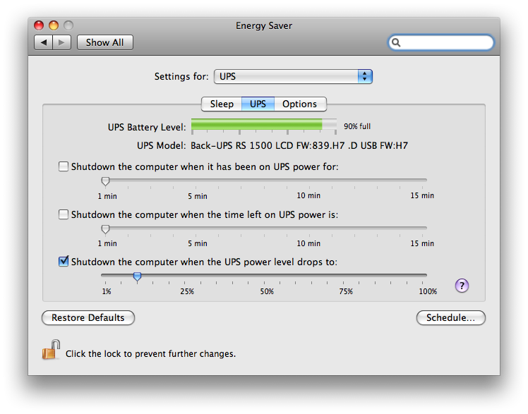

My UPS came today and I am very impressed. I have my friend's Mini, a 19" LCD and powered speakers and two external hard drives plugged into it, and this load is 5% of what it can handle according to the LCD on the outside. Also I plugged the USB cord into my hub and I got this in energy saver: Picture 5.png
Very awesome. The battery was a bit difficult to connect but I got it after a minute or two.
