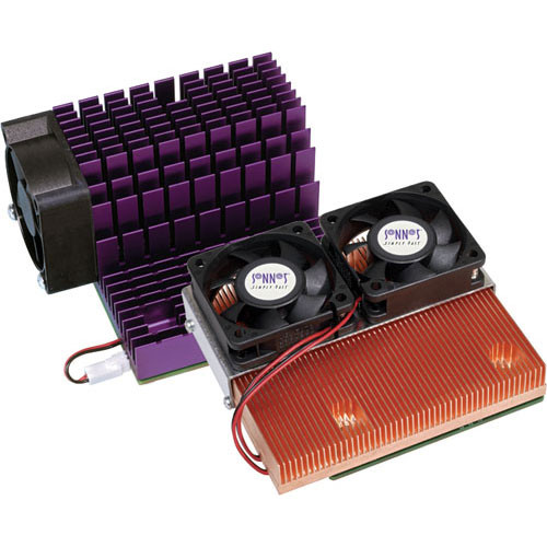

No idea. I have a Sonnet, and I had a single Sonnet before that.
But they looked like this when I bought (had) them.
But I contacted the seller cause in the listing it said he has a heat sink for it and to contact him and he will include it.
OK, well that's good then. Hopefully 'heat sink' also includes the fan(s). I've never seen a G4 Sonnet without a fan for the heat sink.

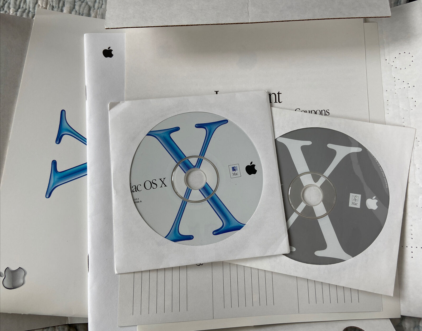

I used the ones I bought that said they were for PowerMac G4 and the OS X disk won't boot for some reason keeps giving me error 1 on reboot though I can see the cd or DVD whichever it is and I used the one labeled PowerMac disks and they get to near the end of copying disk 2 and error out. I know the disks are not scratched, the CD/DVD Drive works cause I can use the emac OS X Disk and it works fine and I burned an iso of OS 9.2.2 and that works fine as well, The HDDs all sound good and hear no clicking or anything.
Check your firmware version - like the sawtooth and gigabit Ethernet it has to be 4.2.8f1 - odd the discs you have are not working, but you can find the original ones on the garden. I am surprised the eMac disc set us working on it, but it isn’t normal as you should be able to use the original discs it came with - try to download the original DA disc set from www.nacintoshgarden.org.
Yeah I did Update the firmware and still nothing though I can use the emac ones that came with it (which is weird cause they are definitely not original to this machine) when I bought it and they work fine with no issues.
That is messed up man.. maybe a logic board issue ?? But do this goto the site I left for you and try to download, burn the DA original disc sw set. Maybe the original discs you bought (assume eBay) ? were no good and not working. Try the garden and let me know - if after that and the originals from there work - kewl beans, otherwise dude your discs are probably messed up( the DA ones). But even so, eMac shouldn’t work on that machine. WEIRD !
Yeah I'll do that, I wonder if the data on those disks is corrupted somehow?
Edited: I'm wondering if the disk is suppose to have another disk with it? because when I search for a retail version it looks like this with 2 disks:
Mine looks exactly like the disk with white background and blue x but did not come with the grey disk?
Those look like retail discs.. But, again check with www.macintoshgarden.org under Digital Audio G4 install media. Download those files and burn them - try again. No way an emac disc set can work on the DA, unless if it was altered to run.
I am downloading a DVD iso of OS X 10.4.11 Tiger I figured that might be a little easier. I noticed that on the emac DVDs they had the Mac OS X 10.3.5 on them separately and I think that is why it worked if I tried anything else on the DVD it would tell me it was the incorrect Macintosh.
