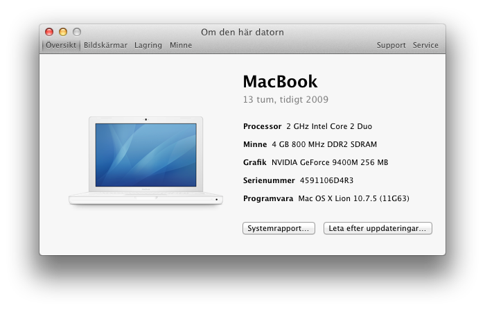

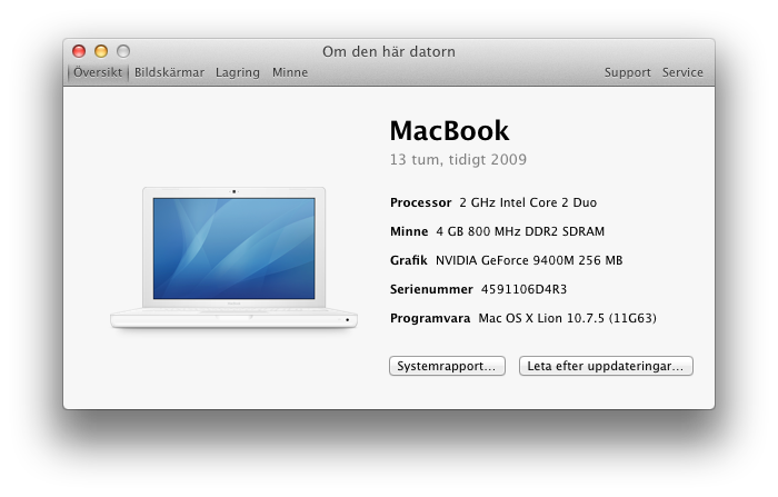

No, that is not entirely true...
I'm currently running a Early 2009 Macbook White, which according to all the spec documents should only be running DDR2 at up to 667MHz, whereas it is running my sticks at 800MHz successfully (of course, then RAM sticks in it was specced for 800MHz, and I was counting on it to clock them down to 667MHz when I put them in). I attached a screenshot (sorry for the swedish, "tidigt 2009" means early 2009, the rest is hopefully quite self explanatory) showing my current MacBook.
As said, for the 2011 Mini, it is specced for 1333MHz, whereas most users runs 1600MHz without any issues, and some users are running them at up to 1866MHz without any issues as well.

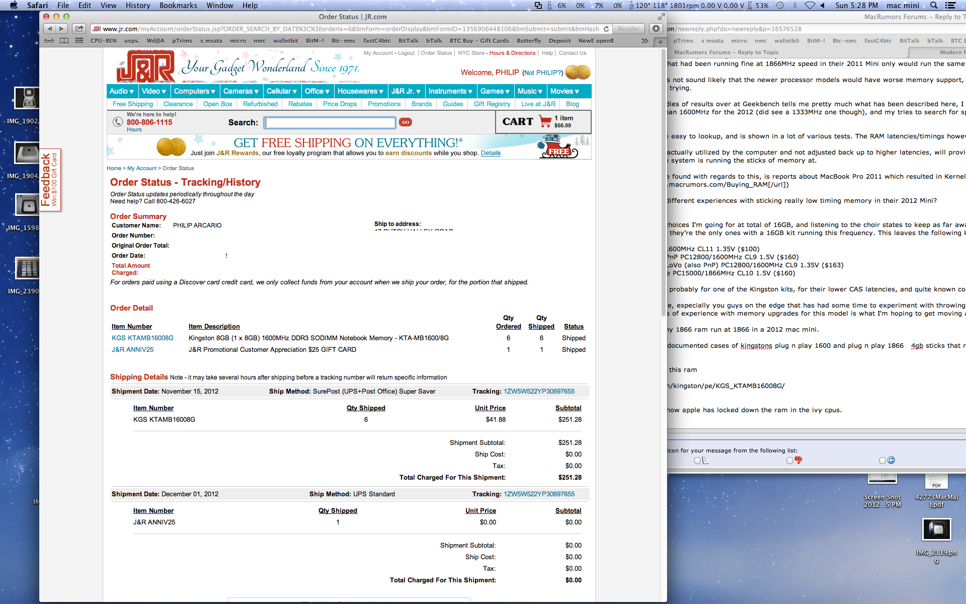

no one has had any 1866 ram run at 1866 in a 2012 mac mini. by this no one has shown it to work at 1866.
But there have been documented cases of kingstons plug n play 1600 and plug n play 1866 4gb sticks that run in the 2011 mac mini at the higher speeds not down clock to 1333. I ran kingston plug n play 1600 in my 2011 mini. I ran tests and posted the slight boost that they give over 1333. there were posted corsair results that also ran 1600 on the 2011 mini
no one has done this with any ram in the 2012 mini all higher ram speed dropped to 1600.
my advice is use this ram
http://www.jr.com/kingston/pe/KGS_KTAMB16008G/
I have ordered it more then once
it works and for now apple has locked down the ram in the ivy cpus.
http://www.amazon.com/Kingston-1600...56906896&sr=8-1&keywords=kingston+ktamb16008g
I have used 10 sticks all good. amazon has some in stock.
