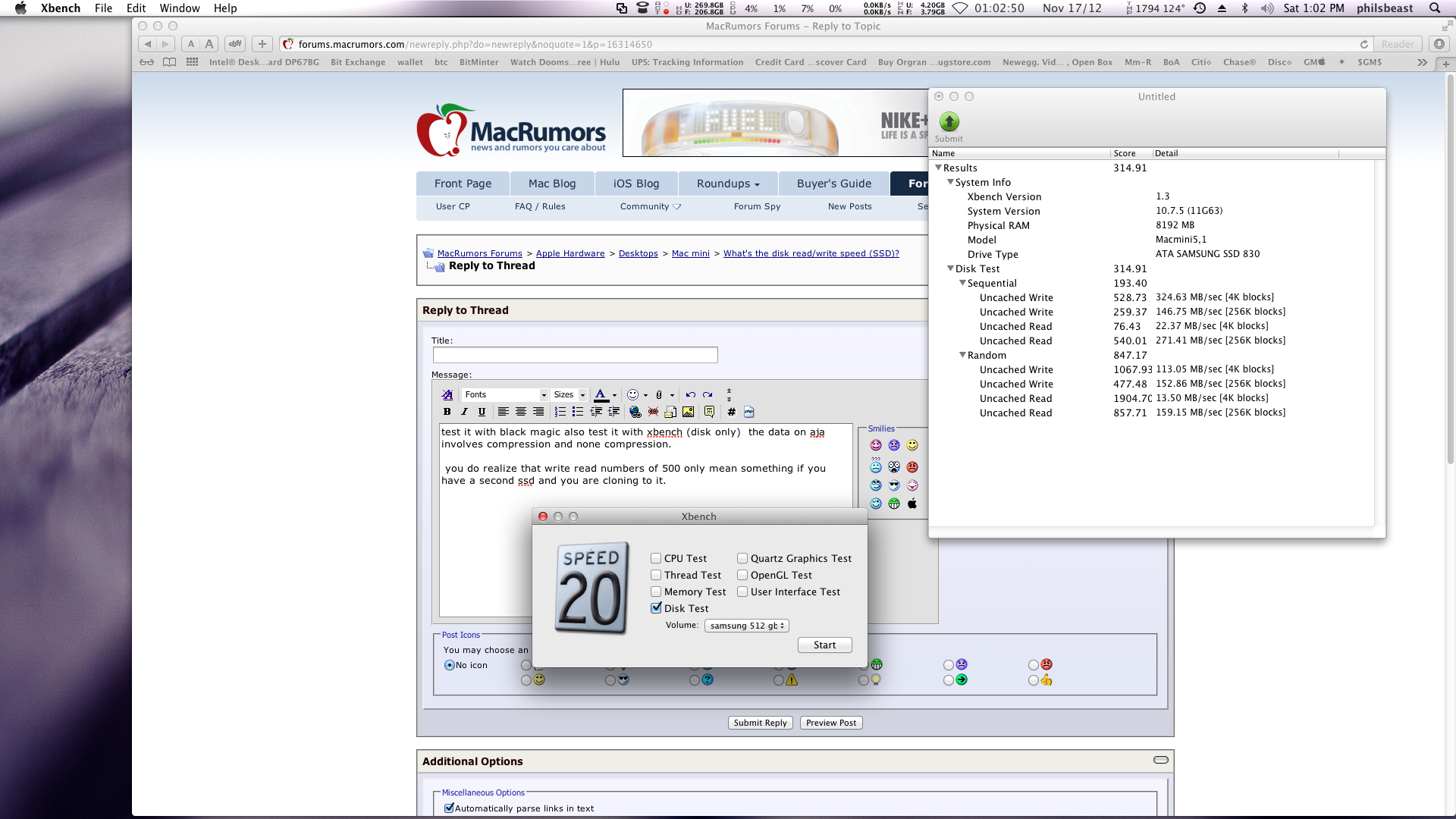

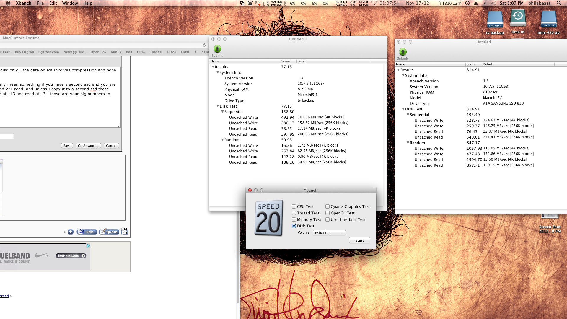

you do realize that write read numbers of 500 only mean something if you have a second ssd and you are cloning to it. on the test below i do 324 write and 271 read. and unless I copy it to a second ssd those numbers don't help me. but on random 4k I write at 113 and read at 13. those are your big numbers to worry about. the second test is on a raid0 2x 2tb = 4tb volume. compare it to the first test.
it will allow long fast copies but it won't do short random work well since it is a pair of mechanical hdds that is normal. I do long copies to it from my samsung ssd. and then use it to host tv shows in my house. see what you get for your xbench scores and black magic scores

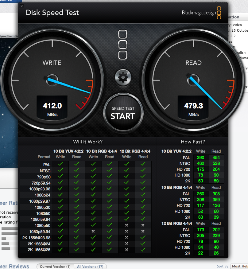

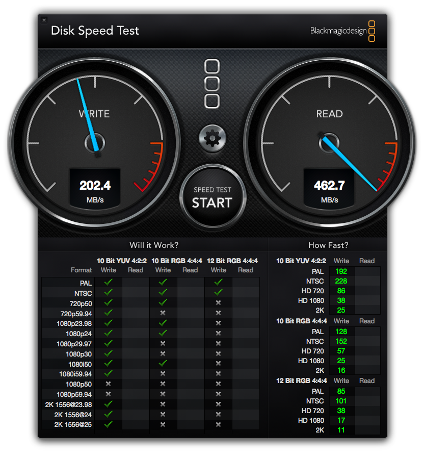

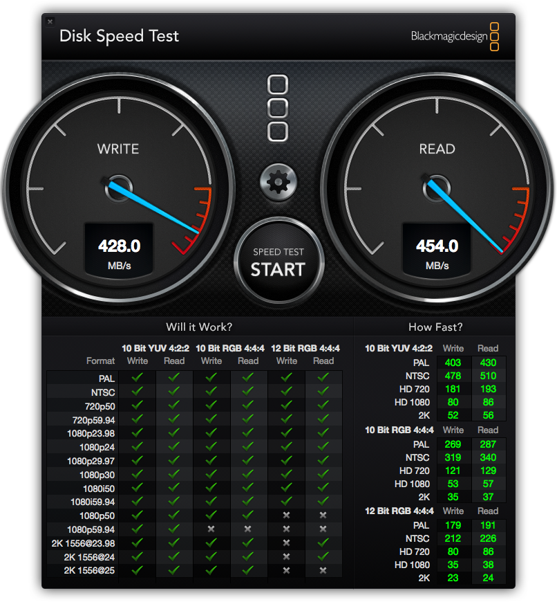

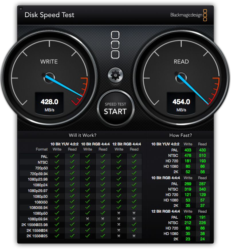

2012 Mini. SSD from Apple, (Samsung 830 with custom firmware)

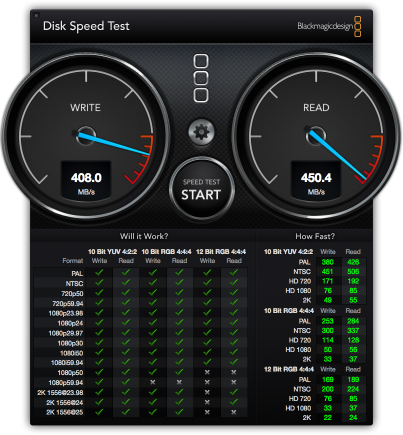

my speed:
how do you guys able to get so much write speed...
yes i also have a second SSD, but currently USB 2.0 because i still need the SATA cable to make that a second SSD.

[/COLOR]how do you guys able to get so much write speed...
Well, I guess your drive doesn't use a Sandforce Controller. Check the MBA forum. People who got the 128GB are getting lower speeds than the ones who got bigger ones. Why? Because 128GB drive is Toshiba and the others are Samsung's 830 series. (250/450 vs 450/450)
First one doesn't use Sandforce Controller, second one does. Difference is no sandforce controller doesn't like uncompressed data as much as the other one.
