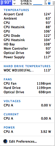

iMac 24" running temp ?
I have iMac 24" and build early '08. Upgraded to 10.6 Snow Leopard. My iMac running temp as screen shot below, is it normal temp (in F degree). Please guide me. Thanks.:apple:
