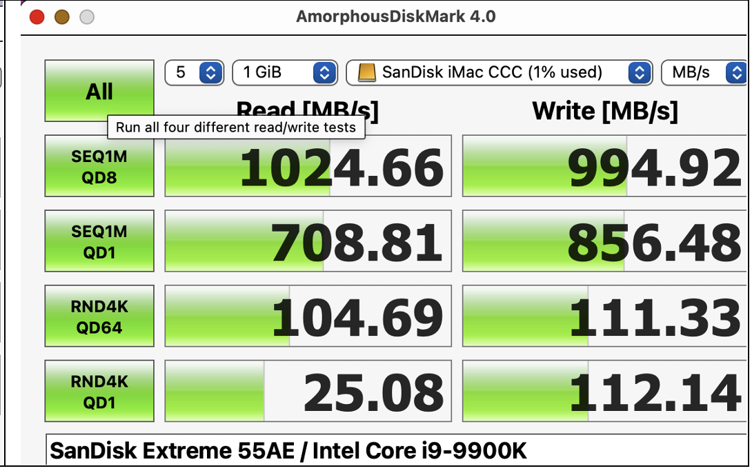

On both a PC and an Intel iMac, the SanDisk Extreme V2 gives 900 MB/s R/W in Blackmagic. Since the Extreme Pro V2 is limited to USB Gen 2 speeds on TB3/4, I'd expect you'd see about same. Thus your transfer times are going to be 900/800 – 1 = 13% longer. [And real-world transfer differences will probably be less than the differences seen with this synthetic benchmark.]
Apple surely knows about this, and hopefully it gets fixed. I vaguely recall this is less of an issue with the Studio...
If you want to compare, in more detail, how your Extreme Pro V2 runs on an M1 vs. how an Extreme V2 runs on an Intel iMac, run Amorphous Disk Mark (free download from App Store) with the default settings:

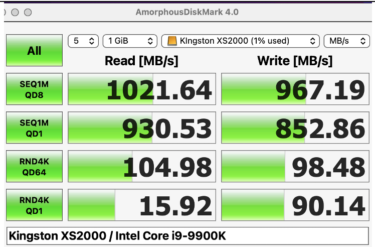

And here's a Kingston XS2000. Like your Extreme Pro V2, it's USB Gen 2x2, and is thus 20 Gb/s-capable, but is downgraded to 10 Gb/s in TB3:

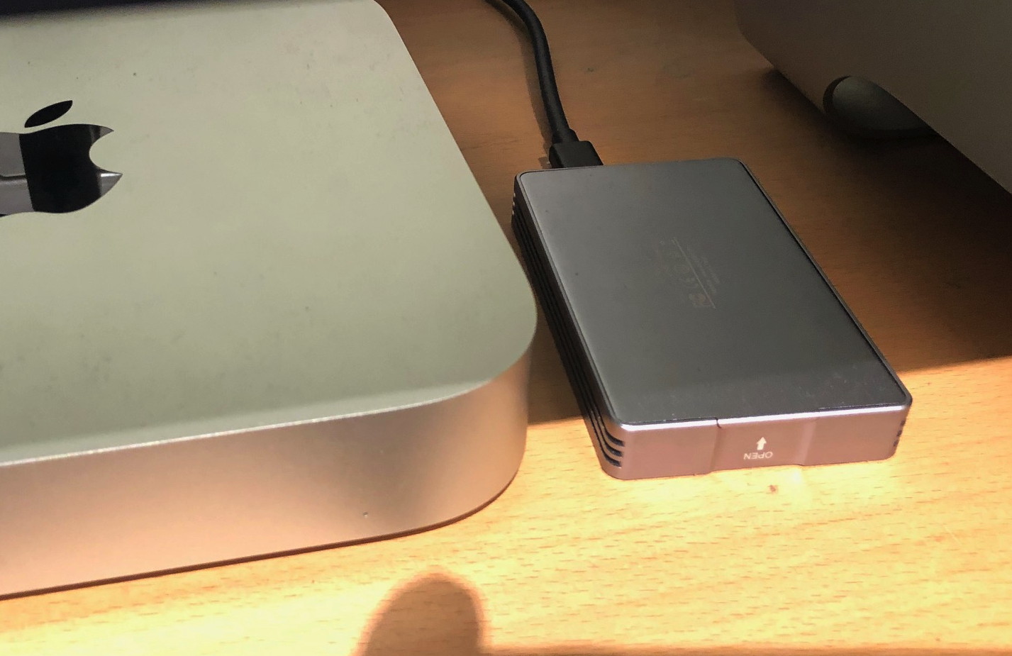

If I want to max out my Sandisk (which is just an M.2 stick)on a Mac, I'd have to put it into a TB3 enclosure.
