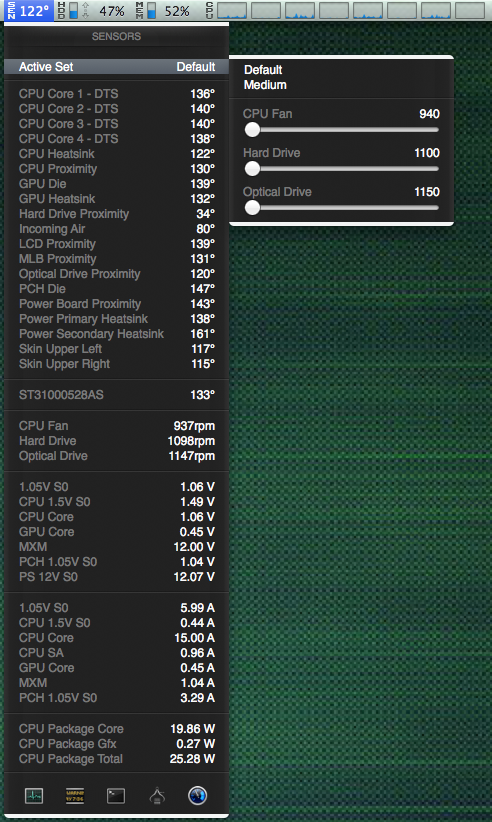

Overheating?? Maybe?? The back top part (where the facetime camera is located) does feel a bit hot.. But as I move my hand down the back, it's cooler.....
This is a screen shot of the temp and fan speeds per iStat Menus....
Do they look ok? Should I adjust them?
I'm on my iMac right now, and as of right now the temp is at 123...

Sorry, but could you clarify that this is in fact in degrees F? I work in degrees C... This is 50, which is good and should not be a worry. The HDD of the iMac is located in the top centre, however not fully top, which is true of both the old and new designs.

The hard drive can behave irrationally under high heats, however 50/123 does not seem high enough. In sleep however the hard drive may have become corrupted if the iMac overheated. This would also explain the fact that it turned off automatically as well. How long did you leave the machine on its own and were you running any processor intensive applications? The processor should not get this hot however...

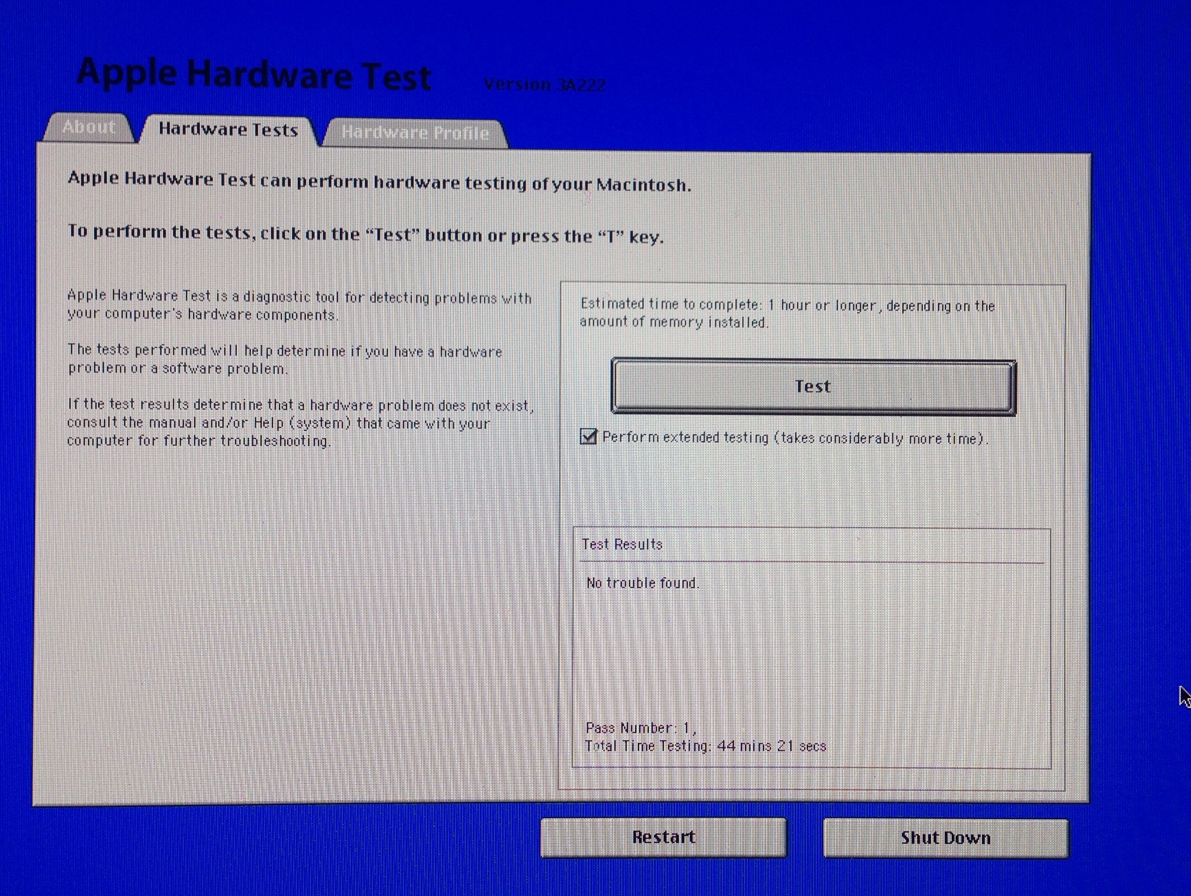

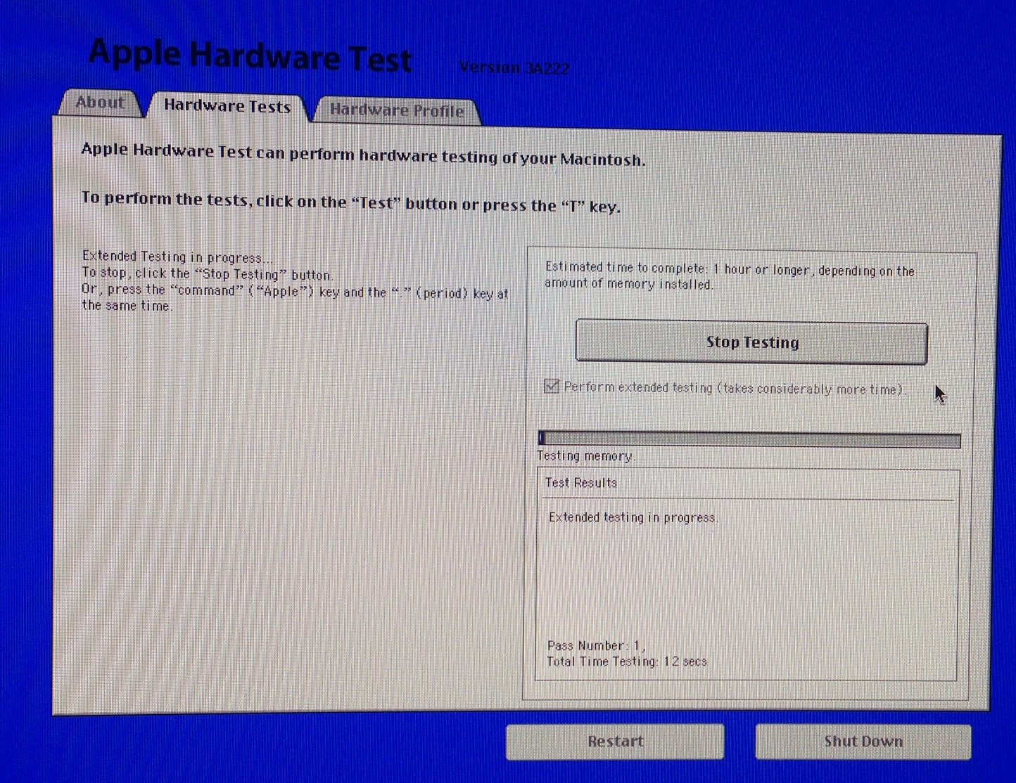

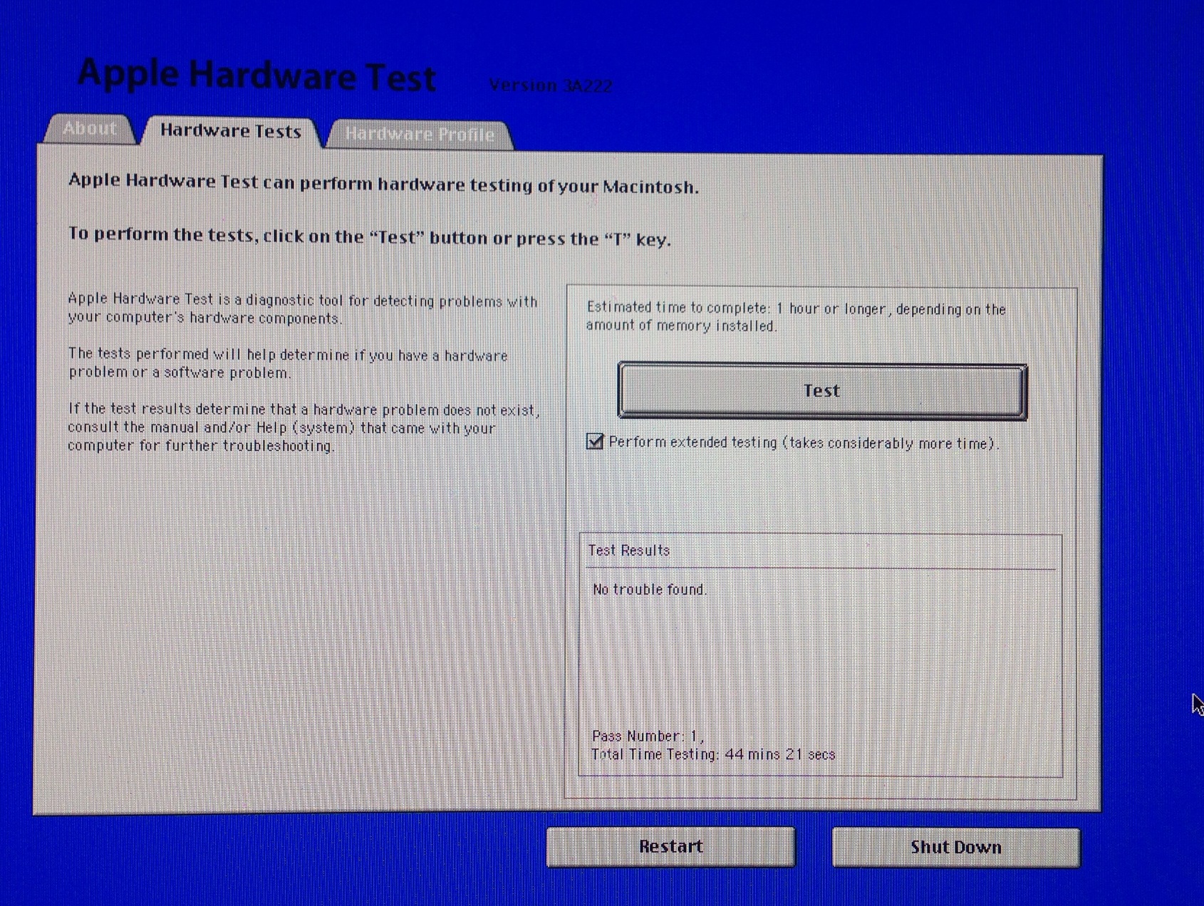

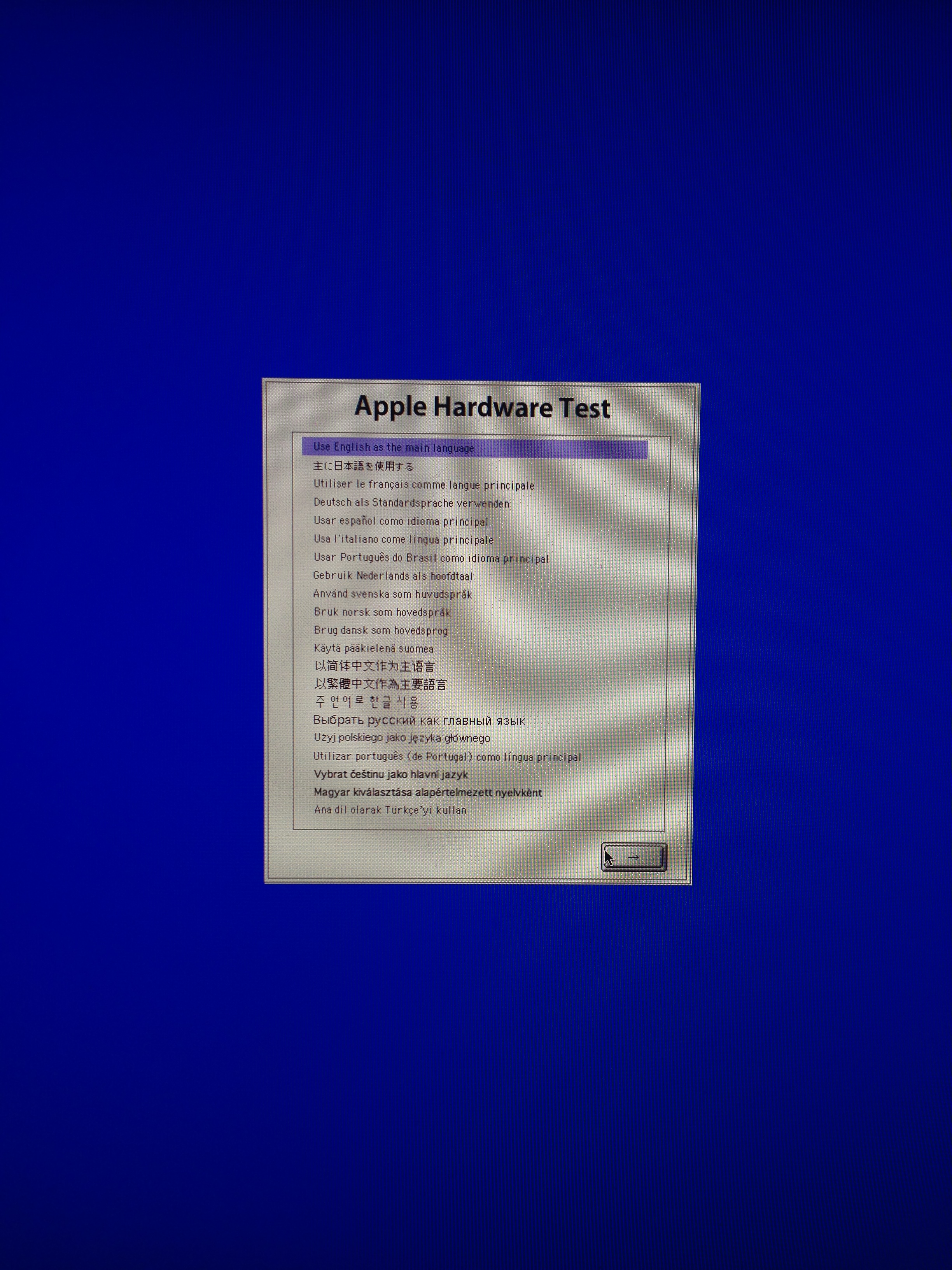

Holding Option-D worked... I'm in the hardware test... It's gonna take a while cause I chose the "Perform extended testing".... I'll post some results when it's done...
Thank you all for all your help and input... 🙂

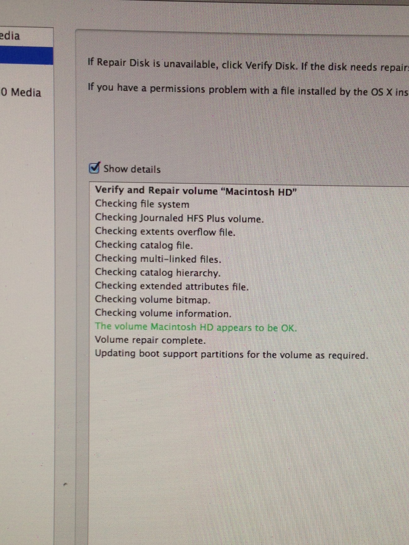

UPDATE - Well, I hit restart after it finished with the test and same results... It starts up to the apple and lil wheel working on the bottom, then the white screen....
I was also thinking that it might be a heat issue cause after the test, the top part was pretty hot... But then again, I left if off overnight and it still didn't boot up this morning...
This is pretty frustrating!!! 😡😕

jamesjingyi - I just checked.. Yes, those degrees are in Fahrenheit...
Also, I turned up the speed of the fans to keep it cooler...

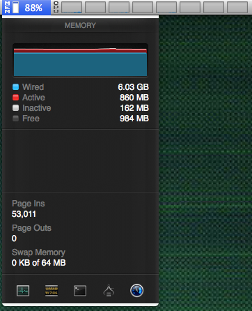

UPDATE - I just restarted and it's working... I have Mail and Firefox open.. My memory is at 35%.... Temp is at 99 degrees... Let's see how long it stays on before the white screen...

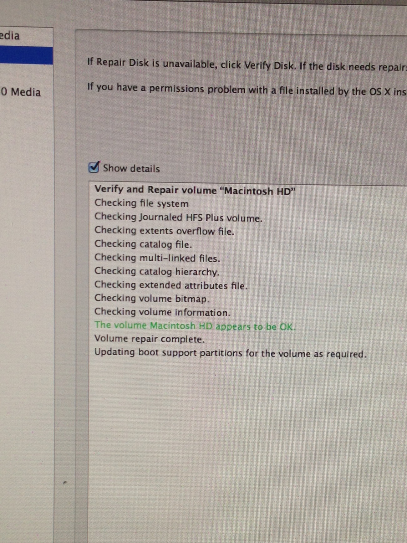

Type '/sbin/fsck -fy' (no quotation marks) and press Enter.
If it says 'the file system has been modified' after it's completed the repair, then that means it's done some changes. Press the 'up' arrow key if it says this, press Enter, and keep running the repair until it says 'The volume Macintosh HD was repaired successfully'.
If it just keeps saying 'the file system was modified' without ever fully repairing it's likely your HDD's kaput.
Another update - It was on last night up until about 2:30am.. It was running at a temperature in the high 80's, low 90'sI was able to re-boot into my ML external and run Disk Utilities... My main drive is ok.. After that, I re-booted into my main and again had Mail and Firefox... After about 10 mins, the screen freaked out and turned white..
I haven't been able to boot into it since.. It gives me the white screen again after the apple and spinning wheel stop spinning....

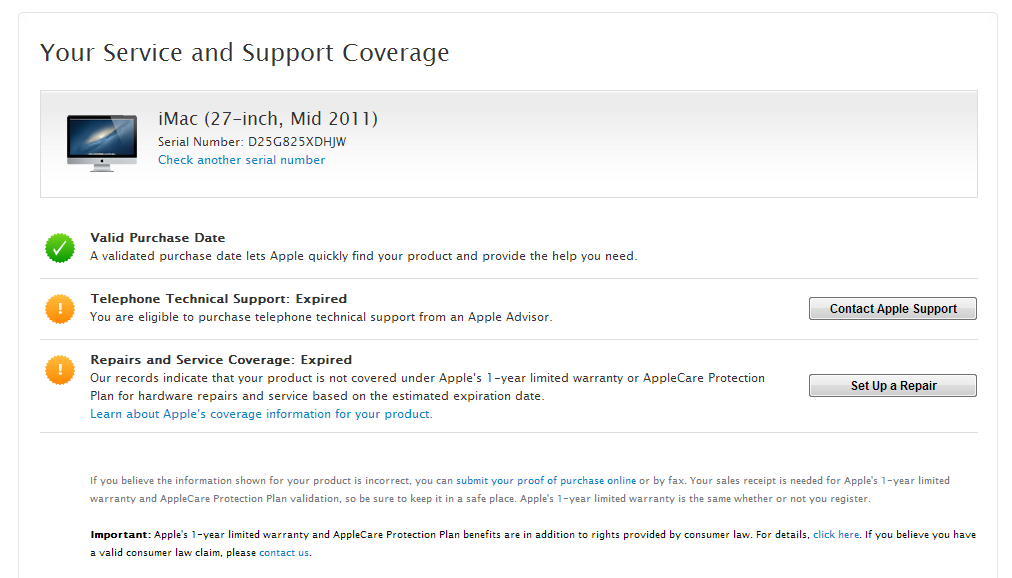

Also, I can't find the guy that I purchased this iMac from... How can I find out when it was purchased? Maybe I can still get applecare? 😕

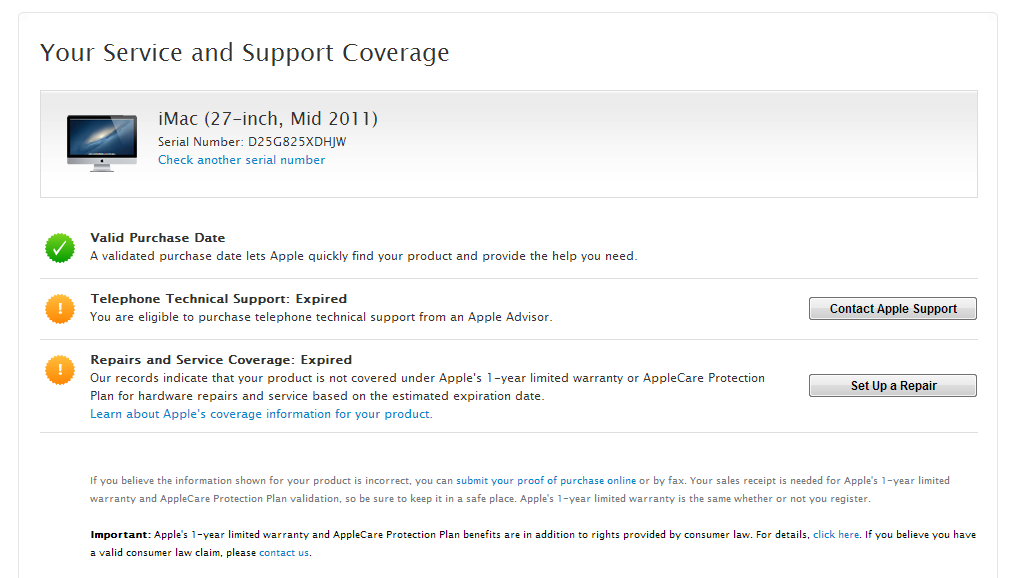

Also, based off of your screenshot, your 1year warranty is up. Once it's up you typically can't buy full AppleCare.
