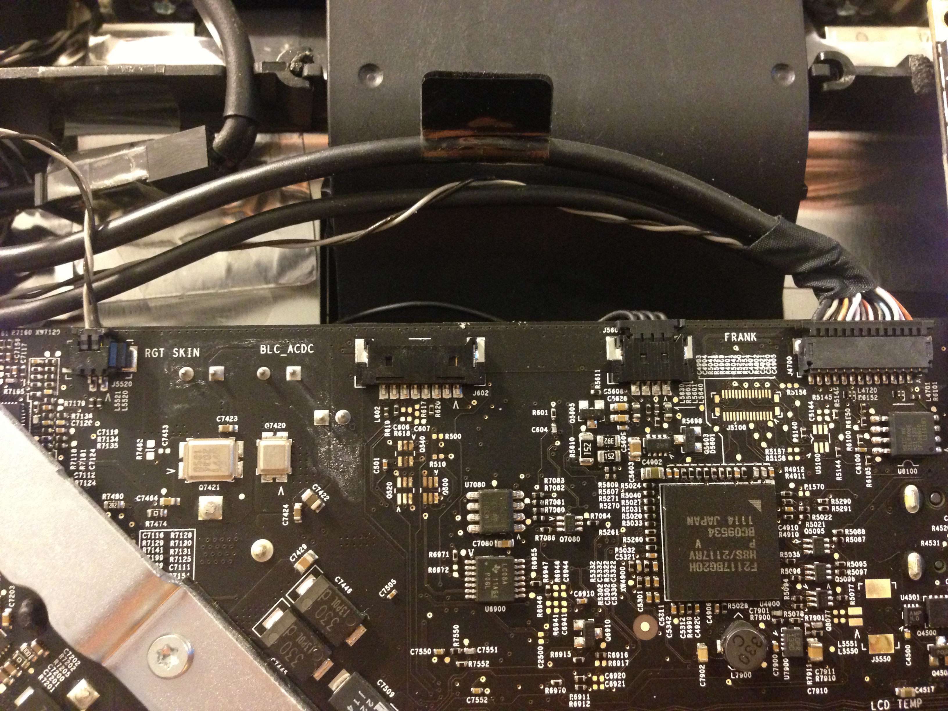

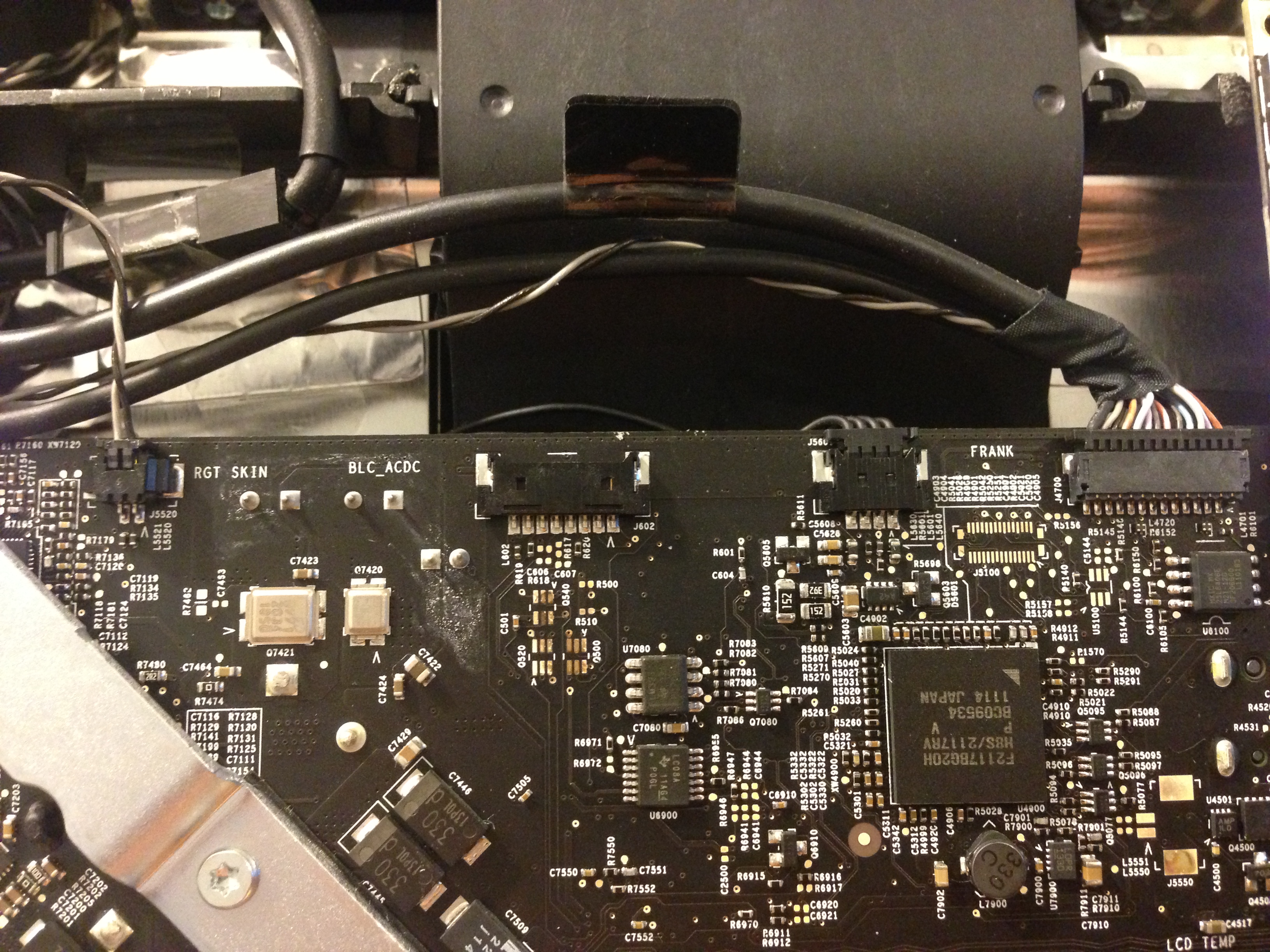

UPDATE - I opened 'er up and removed the gpu.. I did one of those DIY repair options from youtube...
But as I'm putting it back, am I missing a connection? The one to the right of BLC_ACDC... I can't find a plug for it...

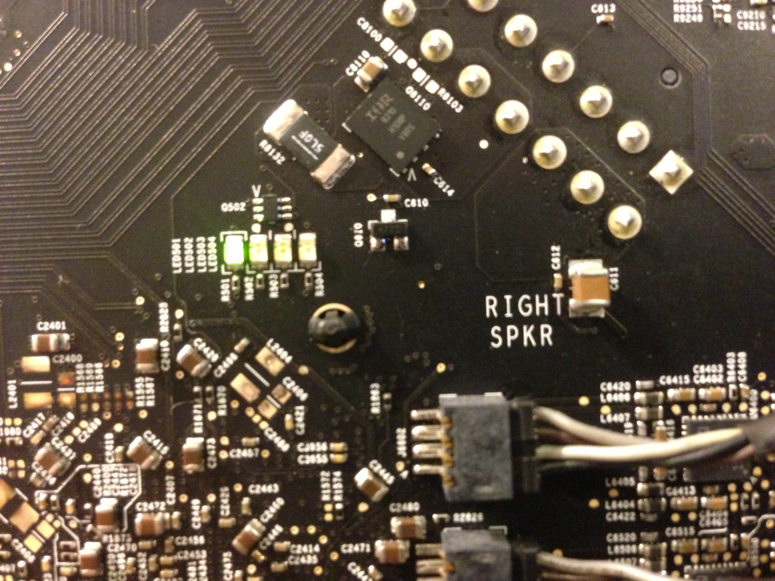

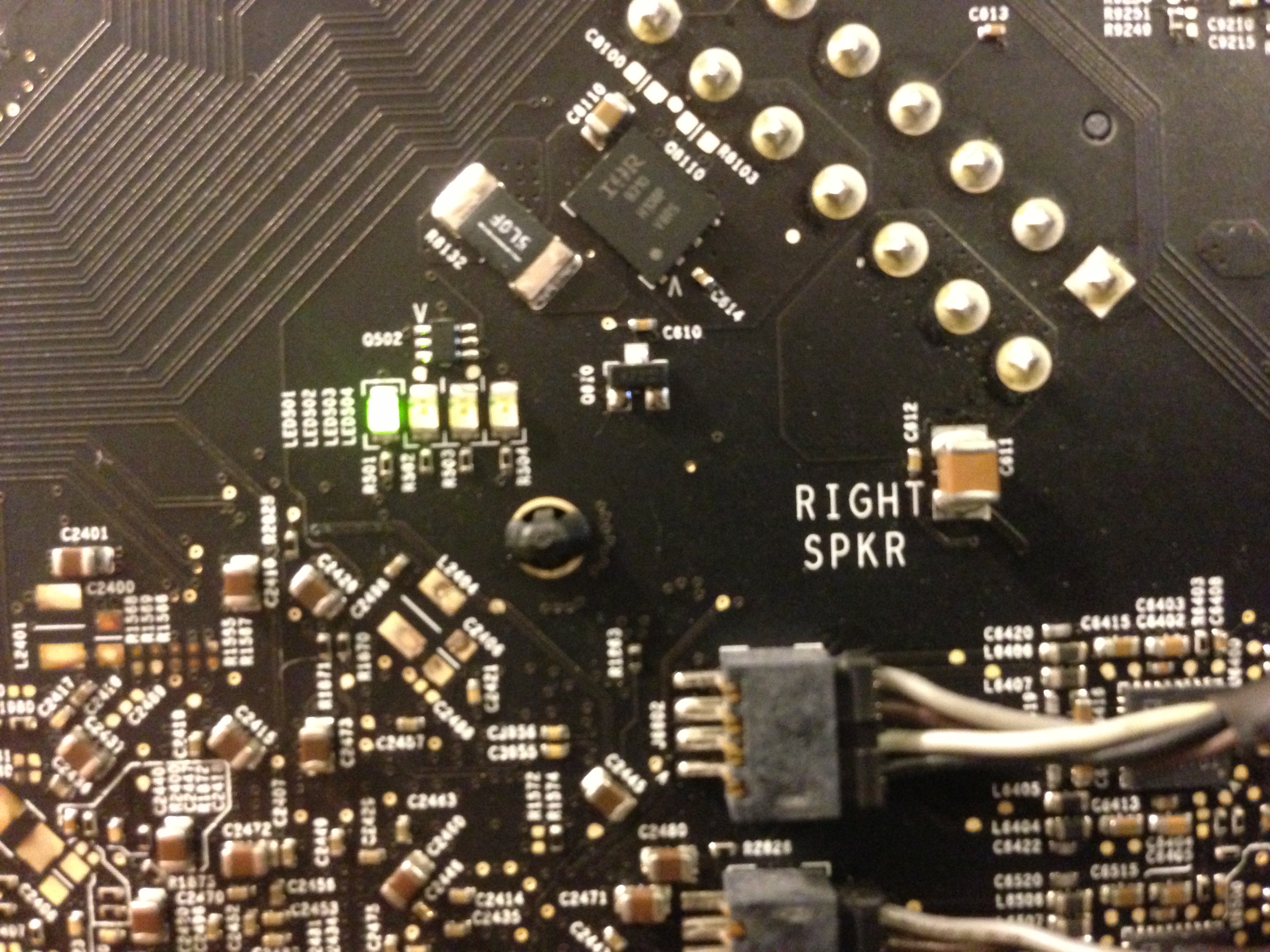

Also, in the other pic, I connected the power and only noticed one of those 4 lights on... Are all 4 supposed to turn on?
