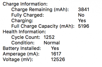

Out of curiosity, how many charging cycles does your Mac show it has been through?
my late 2013 has over 1200 count. Still works fine...

This is the only metric I've seen Apple post:
Your battery is designed to retain up to 80% of its original capacity at 1000 complete charge cycles. The one-year warranty includes replacement coverage for a defective battery.
http://www.apple.com/batteries/service-and-recycling/
