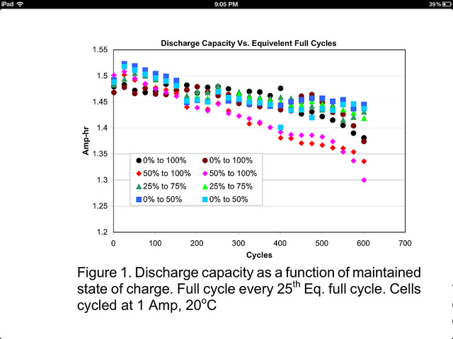

Here's an interesting study done by the US army how Li-ions age with different charging habits.
http://www.cerdec.army.mil/directorates/docs/cpi/Cycled_Aged_LiIon_Cells.pdf
Bottom line, Li-ions age fastest when charged to, and maintained at, high voltages (ie, at and near full capacity).
Reppans - are you aware that the first link you provided has data that completely contradicts the chart you have posted?
I don't think the two perfectly corroborate each other, but I wouldn't say they're contradictory... what part do you think is contradictory?
The problem with comparing the two is that first discusses wear factors in isolation, while the 2nd tests them in combination.

Ah, now that I read your post, I think I see where the confusion lies. Batt Univ does mention 1) the shallower the DoD the better and 2) reaching and maintaining high voltage the worse.
The army chart is basically saying reaching and maintaining high voltage is significantly worse than deep discharges, although deep discharges are bad too.
Cycling 100-0-100 averages at 50% voltage (or capacity) while 100-50-100 averages 75% voltage, and this higher voltage average is worse for the battery than the deeper discharge. When both average at 50% voltage (100-0-100 vs 75-25-75) the latter shallower DoD wears the battery less. When both are cycled a shallow 50% DoD (75-25-75 vs 50-0-50), the lower average voltage of 25% wears the battery less.
