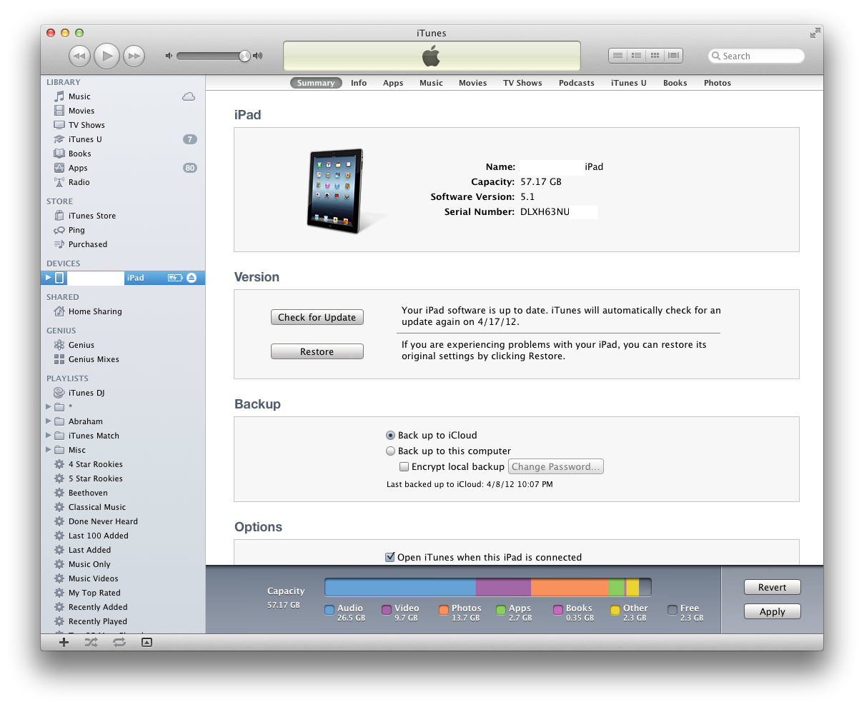

One thing though; of course I have renamed my iPad (we have three iPads in the family, all synced with one instance of iTunes). Where in iTunes will it state if a connected device is an iPad 2 or 3?

I think it should be on the main screen once you connect your iPad. Same screen that allows you to update firmware, backup, restore, etc. I don't have access to my home computer right now, otherwise I'd take a screenshot 🙁
Or better yet, go to Manage Devices for iTunes in the Cloud. Should be able to tell you there. 🙂
FWIW, mine doesn't show the iPad hardware version there. 😕
