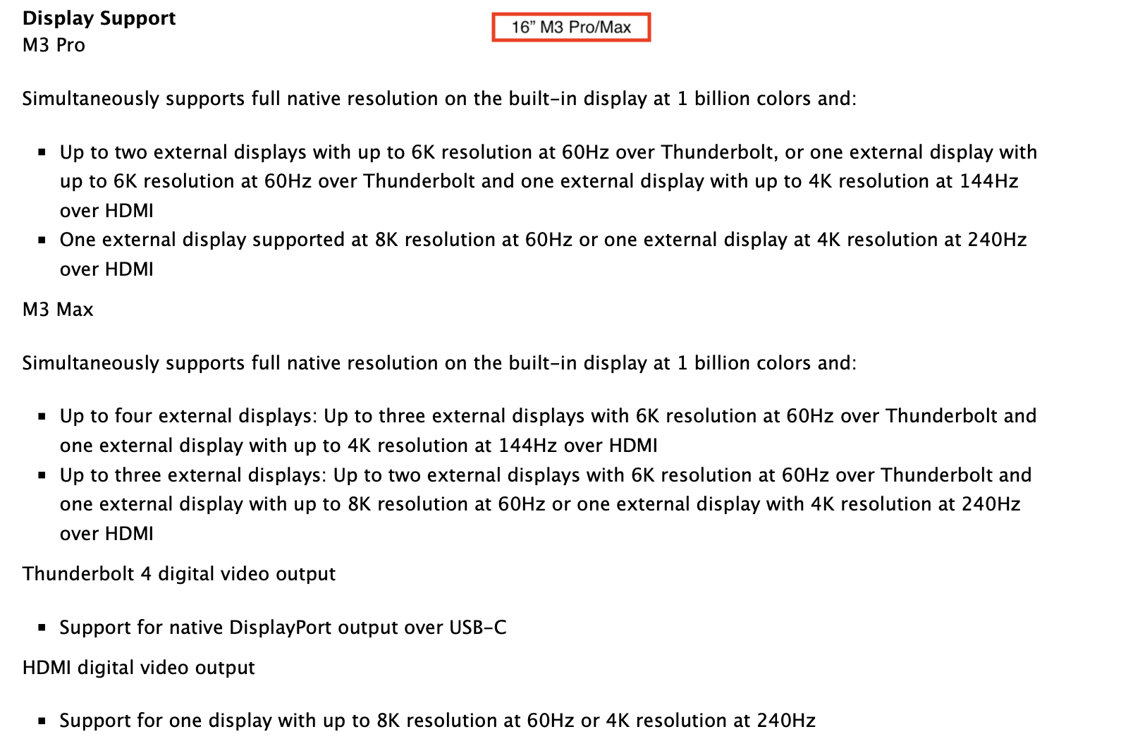

I am asking myself (I should also Apple Devs but it is hard to come to them) when will Apple on Apple silicon start support for Billion of colors aka. 10-bit output ?

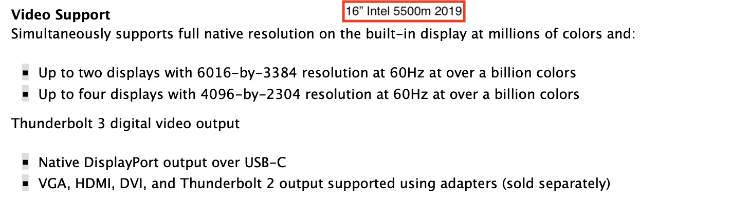

This is when it was introduced for Intel and worked on all later Intel machines .... Intel start of support for Billion of colors
.... where on any Apple silicone there is no support for 10-bit at all !!! or ?
Here was talk about it: is the M1 chip true 10 bit capable, not 8+2 FRC, over hdmi or display port?
You can also clearly see that Intel machine support it on External monitor where Apple silicone supports it only for Built-in display :

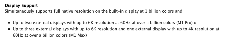

Don't they already? Here's the tech specs of the 16" M1 MBP...and that one does state "billions of colors".
I don't think Apple omitting "over a billion colors" on the newer models mean anything, unless I'm missing something.
Yes you are missing ... it exactly says "on the built-in display" where for Intel Mac's it says exactly for external displays (check image in my original post or pdf I attached) ;)

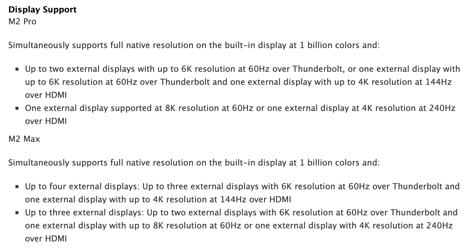

It seems to be just a copy editing issue. As @iStorm posted, the M1 specs explicitly state it supports a billion colors on externals, so surely the M3 is just as capable.
The billions modifier is also missing from the copy for the M2. I'm wondering if they accidentally removed it, and no one's fixed it yet:

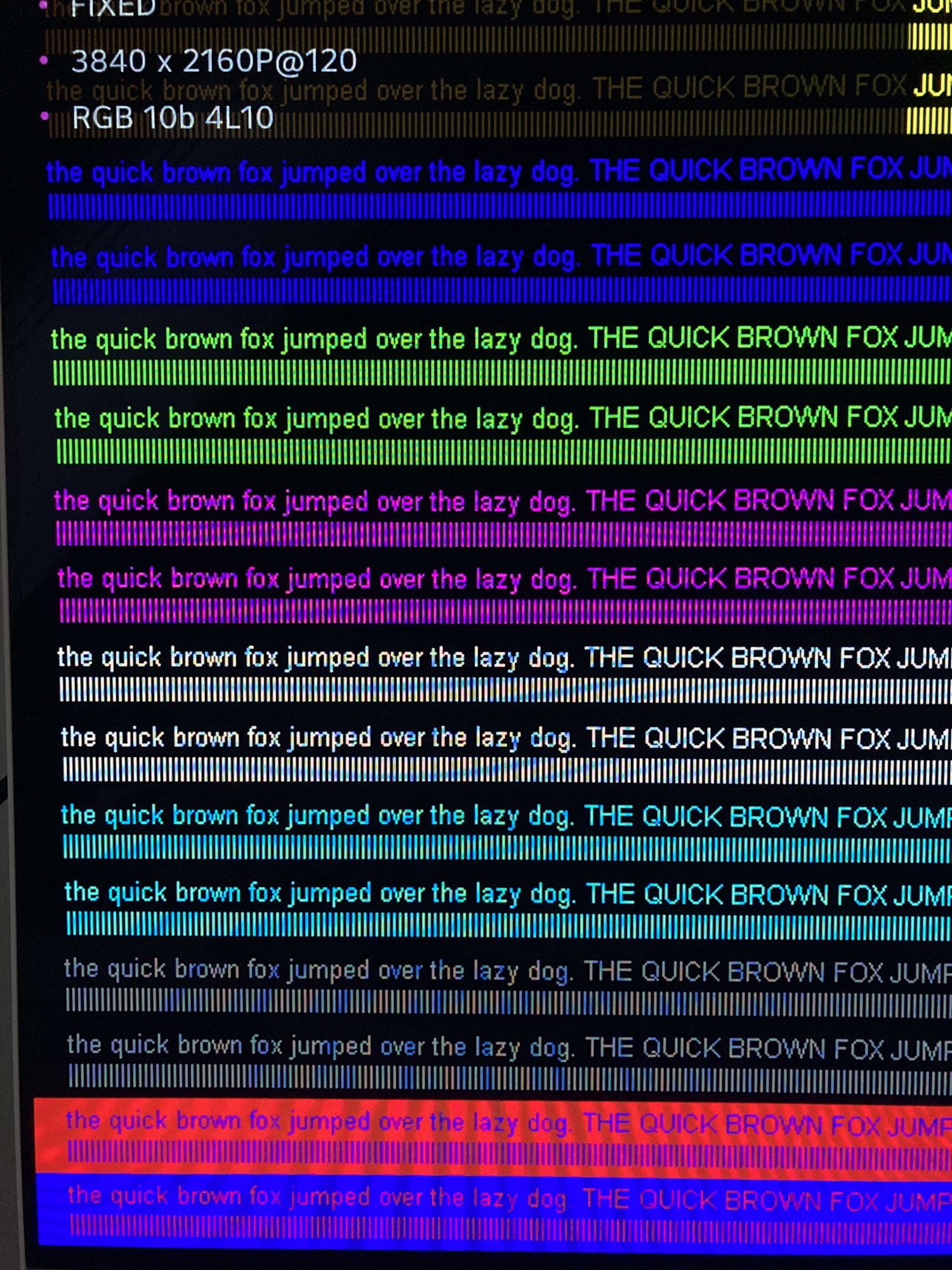

I currently have a M1 MacBook Pro connected to an OLED TV and get this information straight from it. It looks like full chroma 4:4:4 and RGB 10-bit (don't mind the moiré from the crappy camera).
