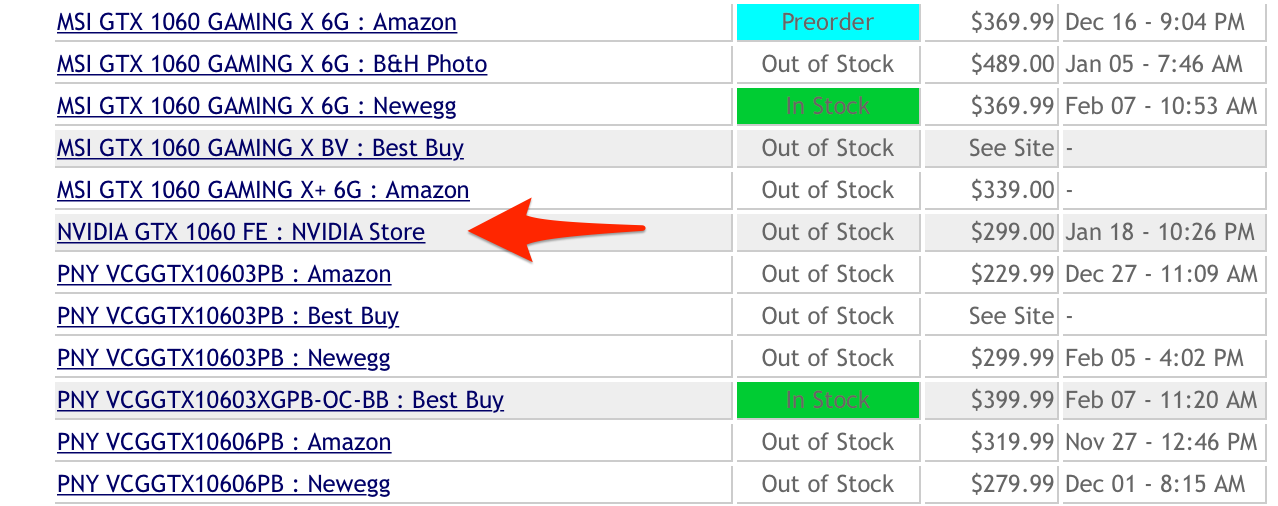

I got the best deal ever...got the FE GTX 1070 with the Vive VR. I essentially paid $200 shipped for it.
I don't understand why they didn't release drivers that work properly for the 1060 with the 10 series driver release? Do they plan to update this?
Maybe they do, maybe they don't. You'll have to search around.
The reason likely is because focusing on the 1070/1080/1080ti in one swipe is easier than the odd-ball 1060.
Are you sure you want a 1060? Great card for 60FPS 1080p, but that's really about it.

:( kind of sad to see the nvidia uk site say the gtx 1060 costs £190 and a look on amazon uk sees the cheapest at £303, but the gtx 1050 for £100 seems a good price. (edit - i dont know if the gtx1050 works or not)
one thing to mention is there will be a GPU refresh some time soon ish (half a years time?)
