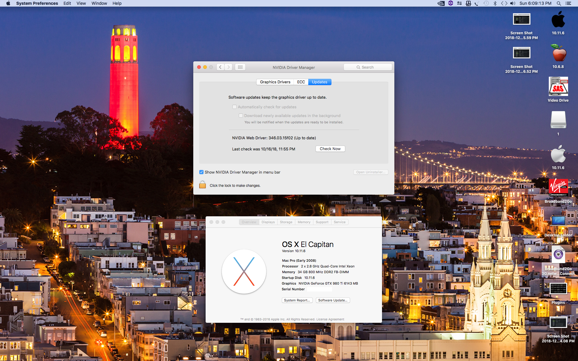

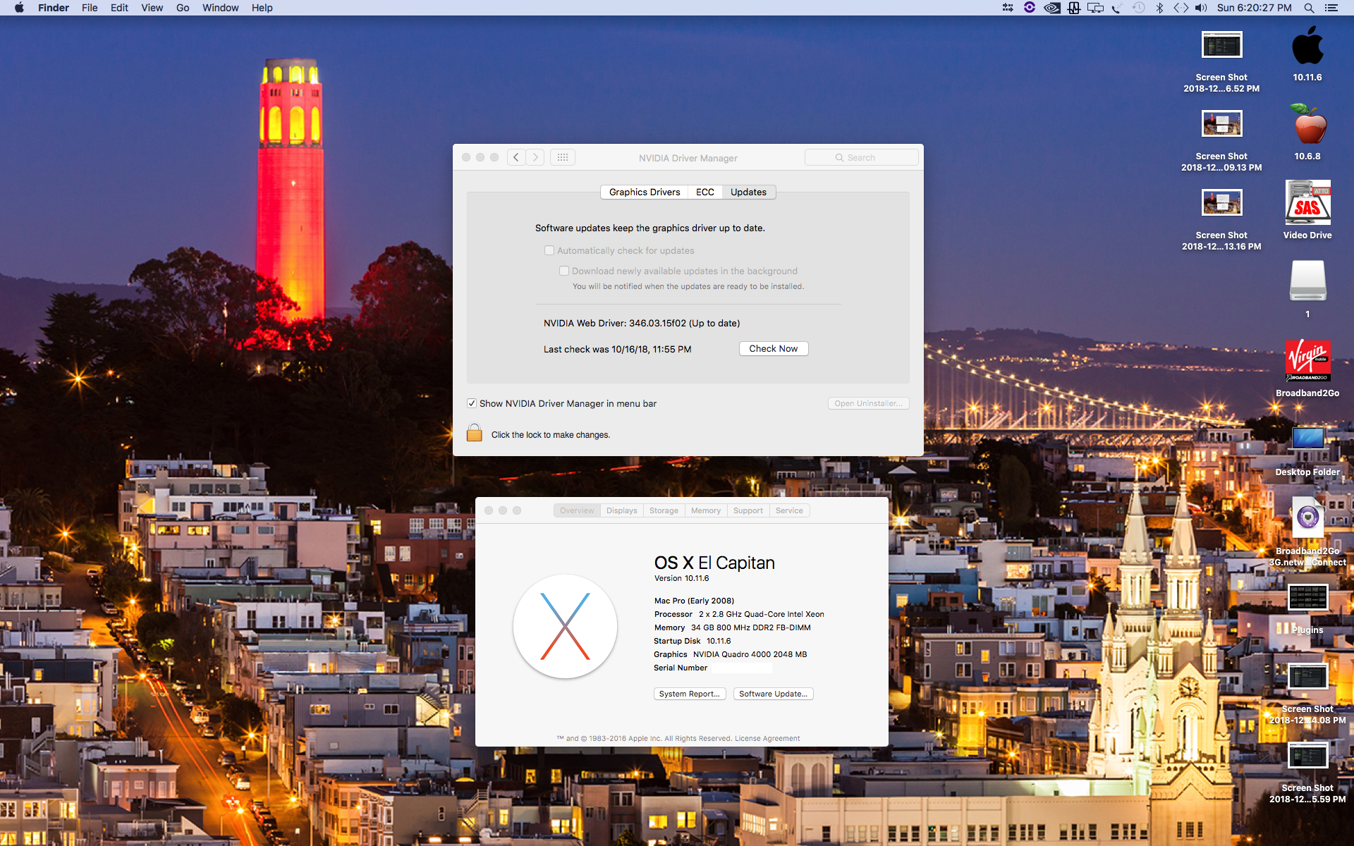

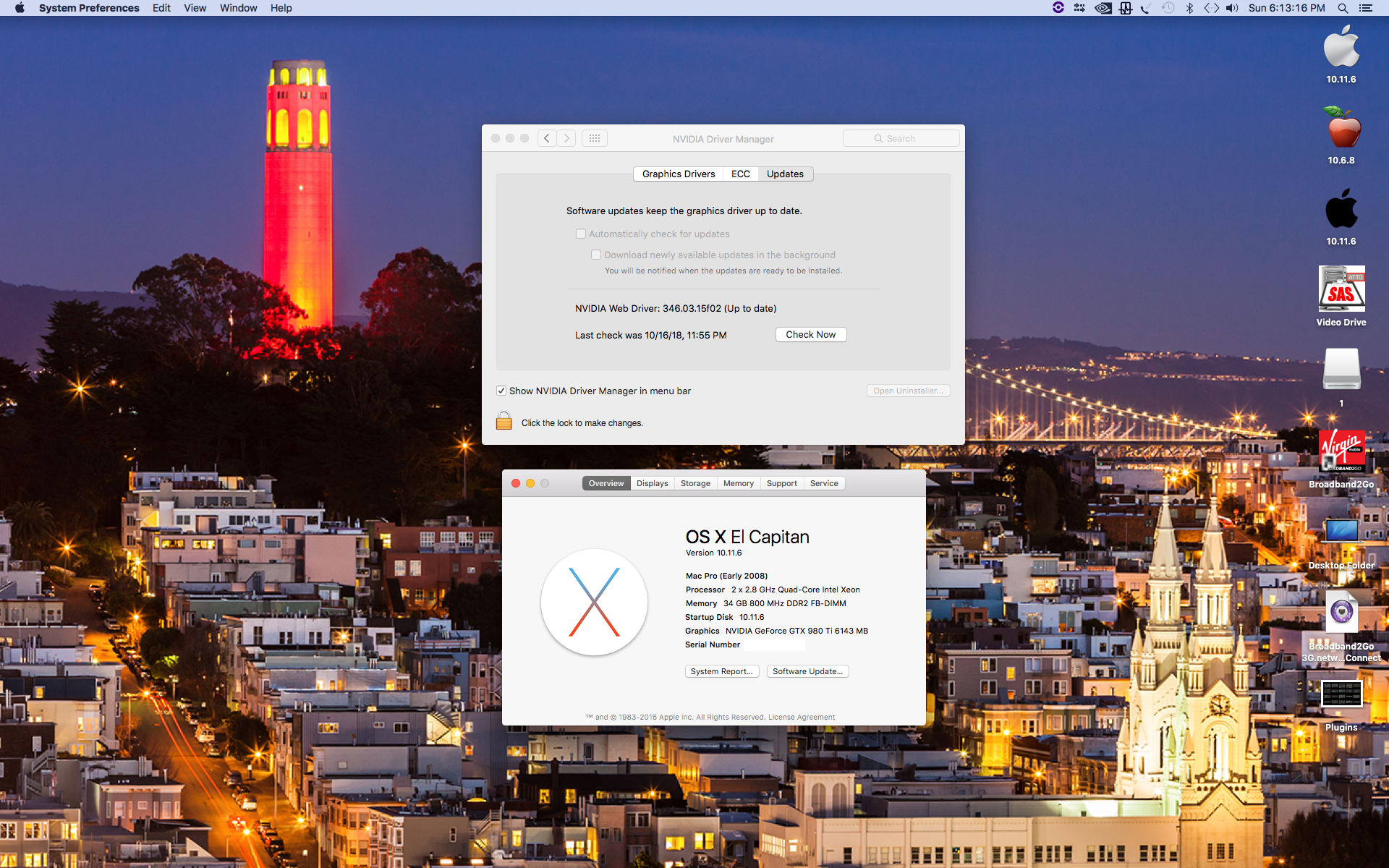

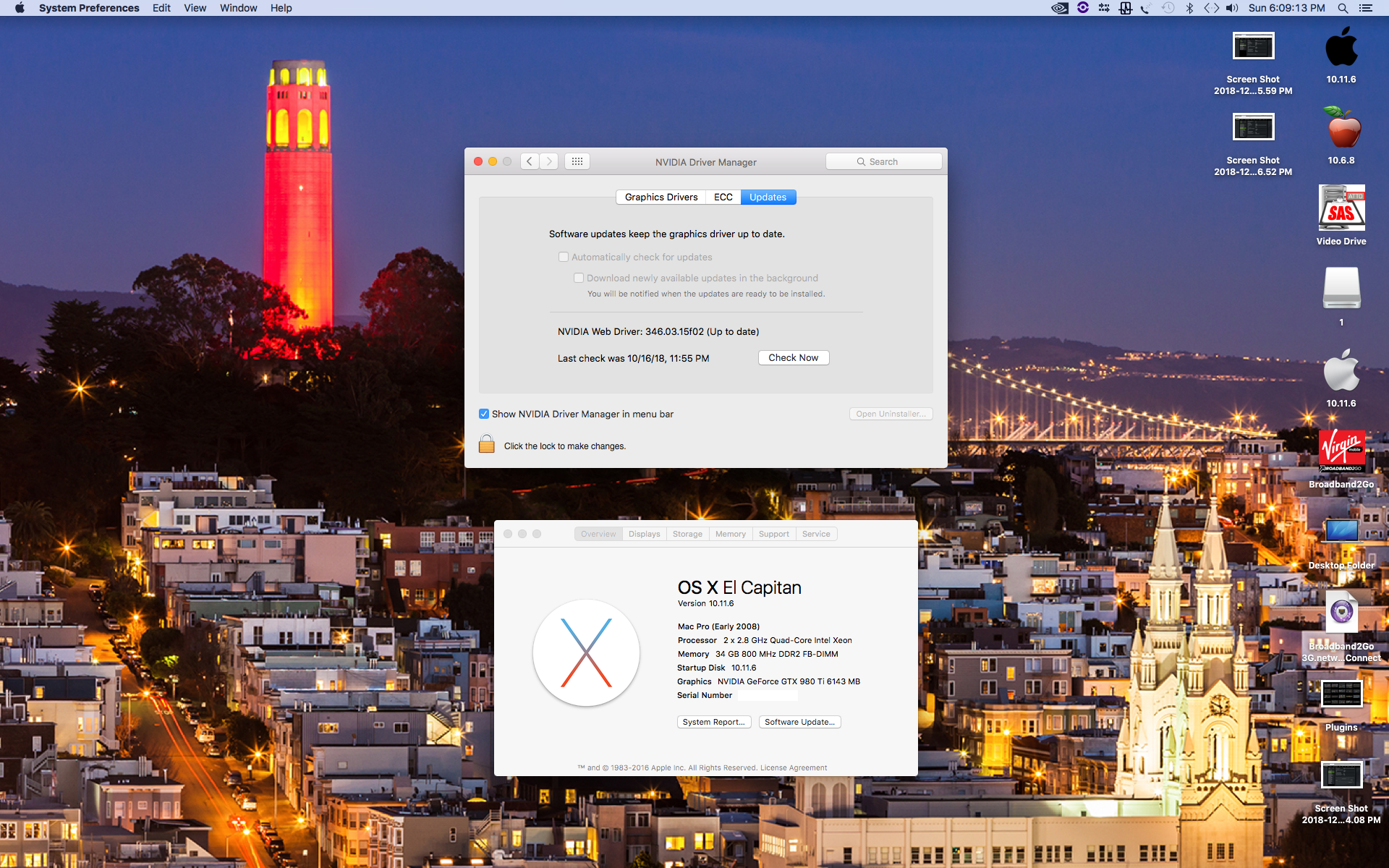

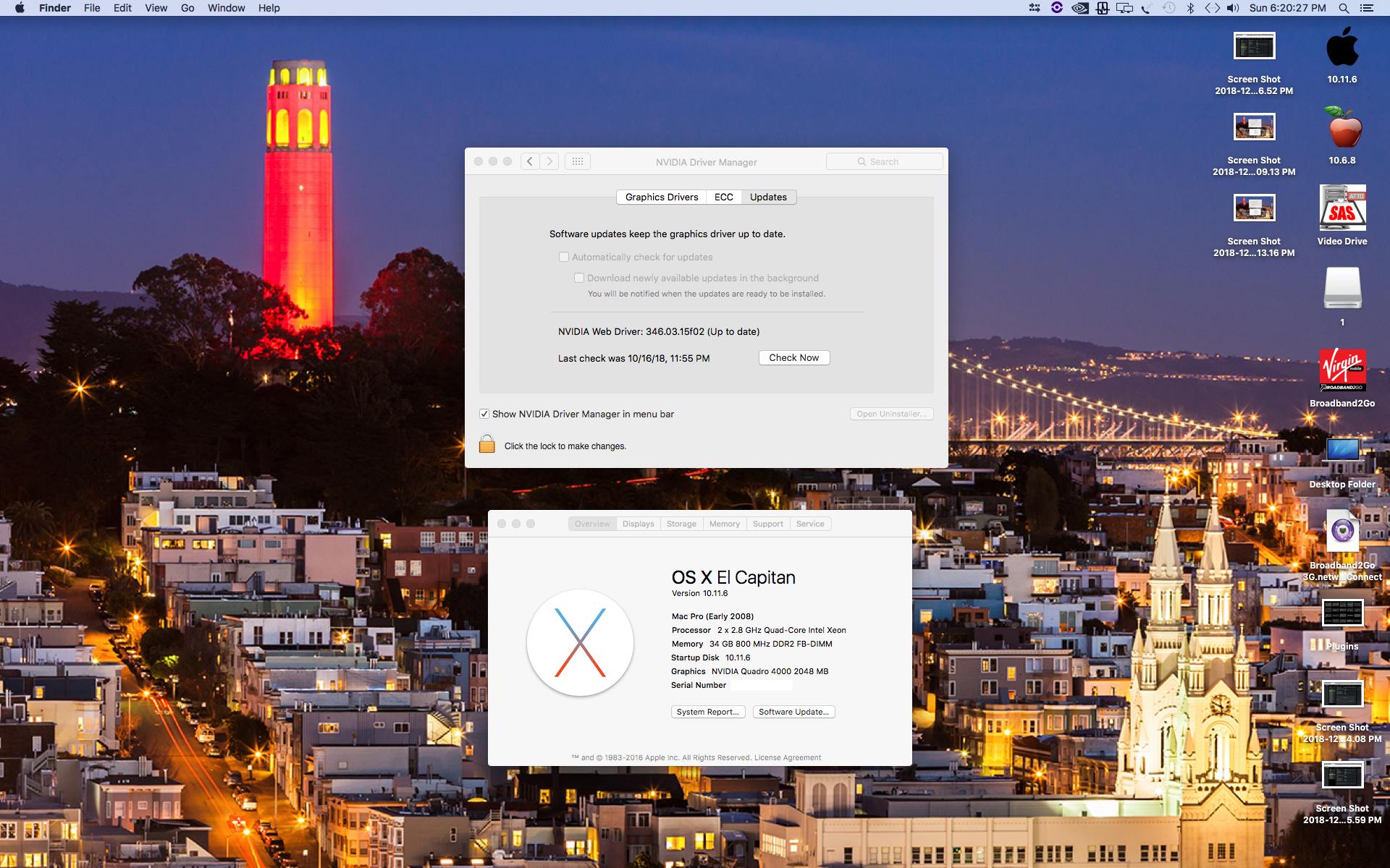

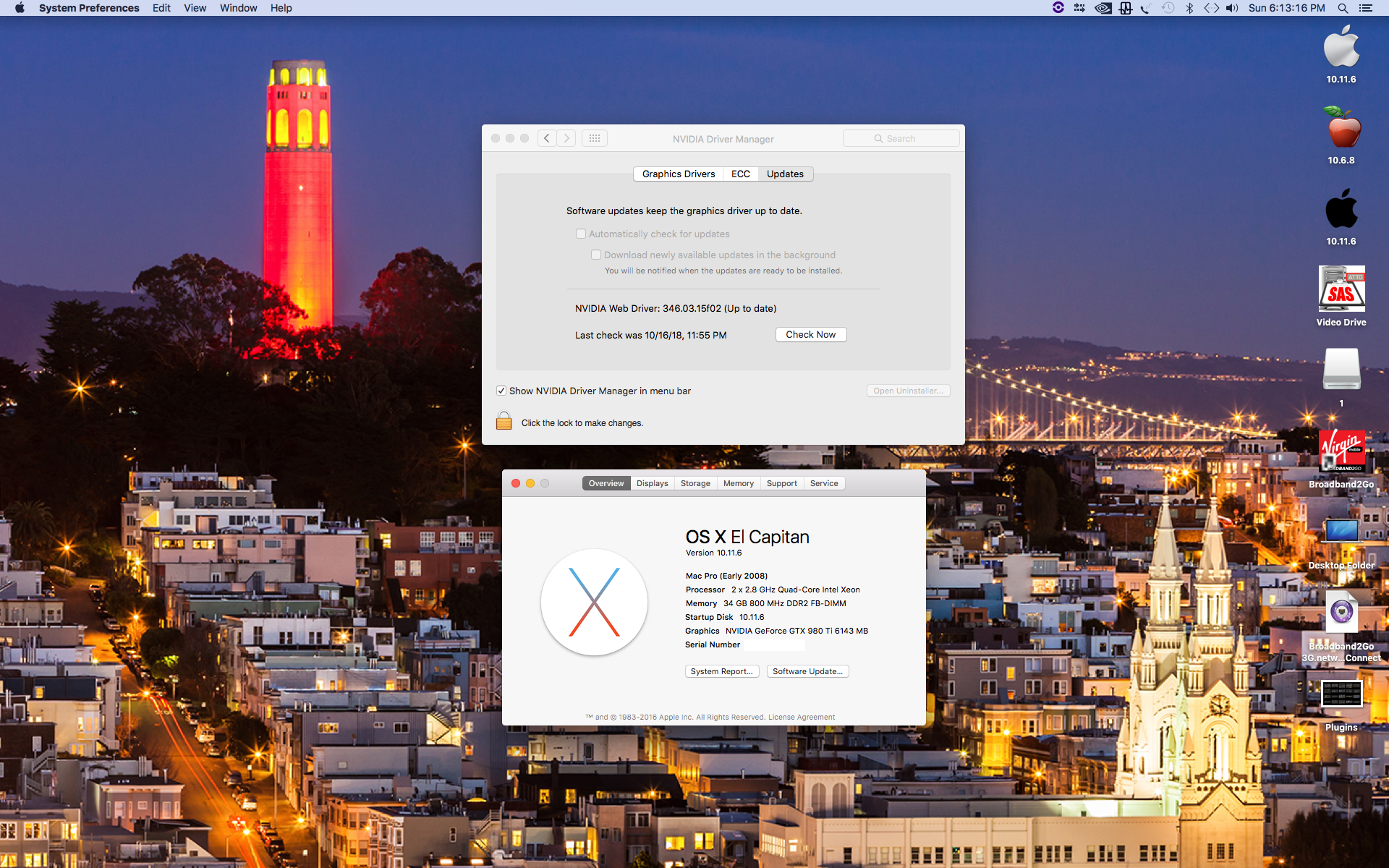

1. Showing GTX980ti that is installed in external Netstor box as GPU (connected just for screen shots) and booted from 10.11.6 SSD in MP
2. Showing GTX980ti that is installed in external Netstor box as GPU (connected just for screen shots) and booted from 10.11.6 SSD in Netstor
3. Showing Quadro 4000 that is in the MP and booted from 10.11.6 (regular setup) The GTX 980ti works in the MP's bottom slot but based on 250w and MP's 300w max, the 3 other cards in slots 2-4 won't allow it. Q4000 in bottom slot
Reactions: pullman

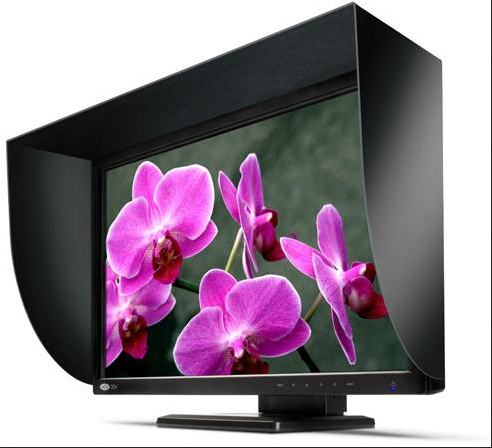

1. Since you are going for 10bit you need to stay with Quadro and not GTX
2. The 980ti is used for GPU in Resolve and the Quadro 4000 Mac is for GUI.
3. The ole Q4000's performance is limited to running an older laCie 324 with hood and a 24 inch tv as a 2nd monitor.
Nothing like running an EIZO 4K @10bit with a hood!
Sir! You are using a hood with the EIZO aren't you! 😱 Oh, the Humanity! 😛

Oh yes I have a hood for the Eizo, it's a fantastic screen 🙂

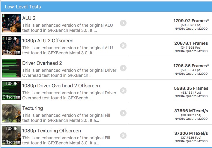

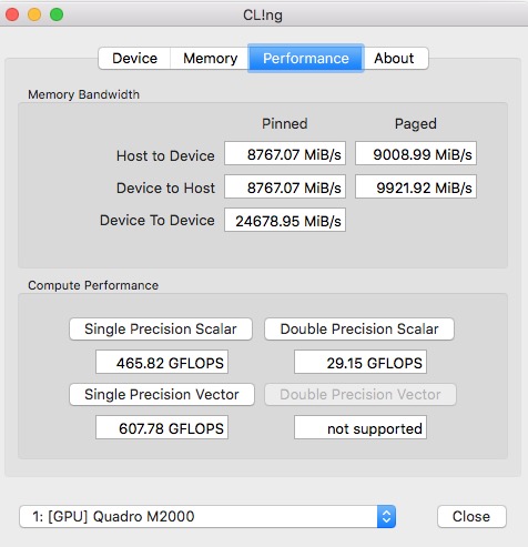

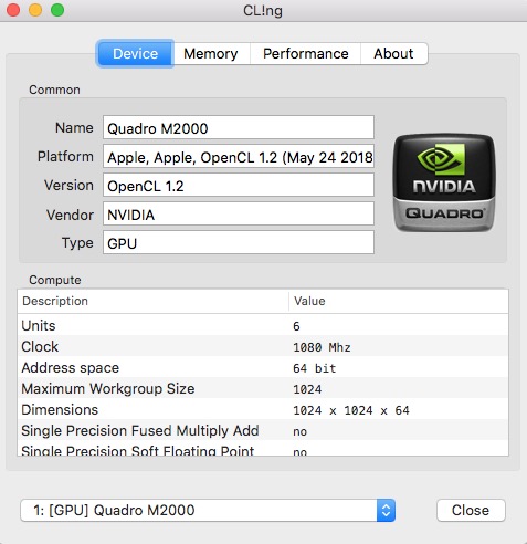

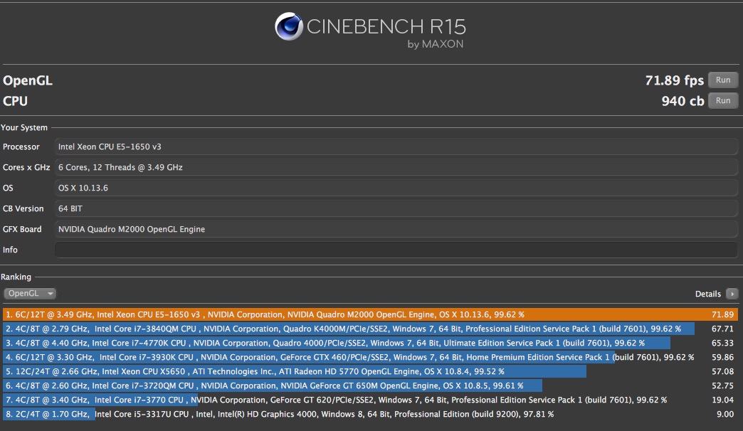

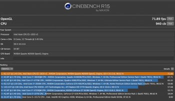

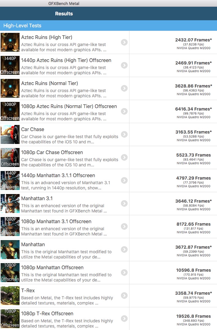

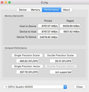

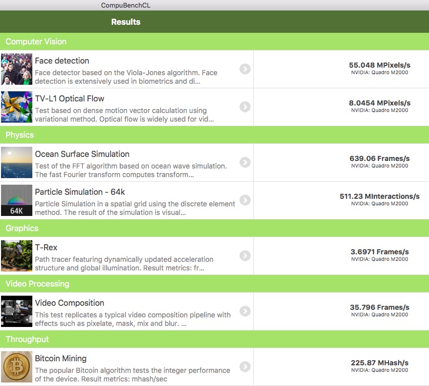

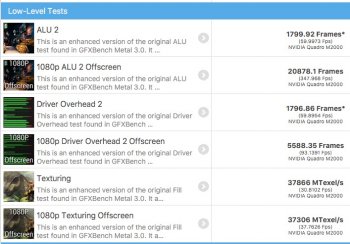

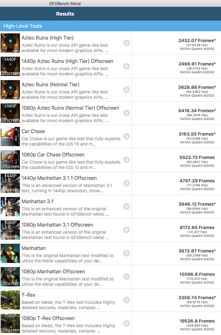

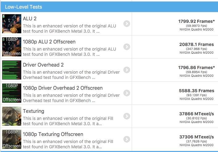

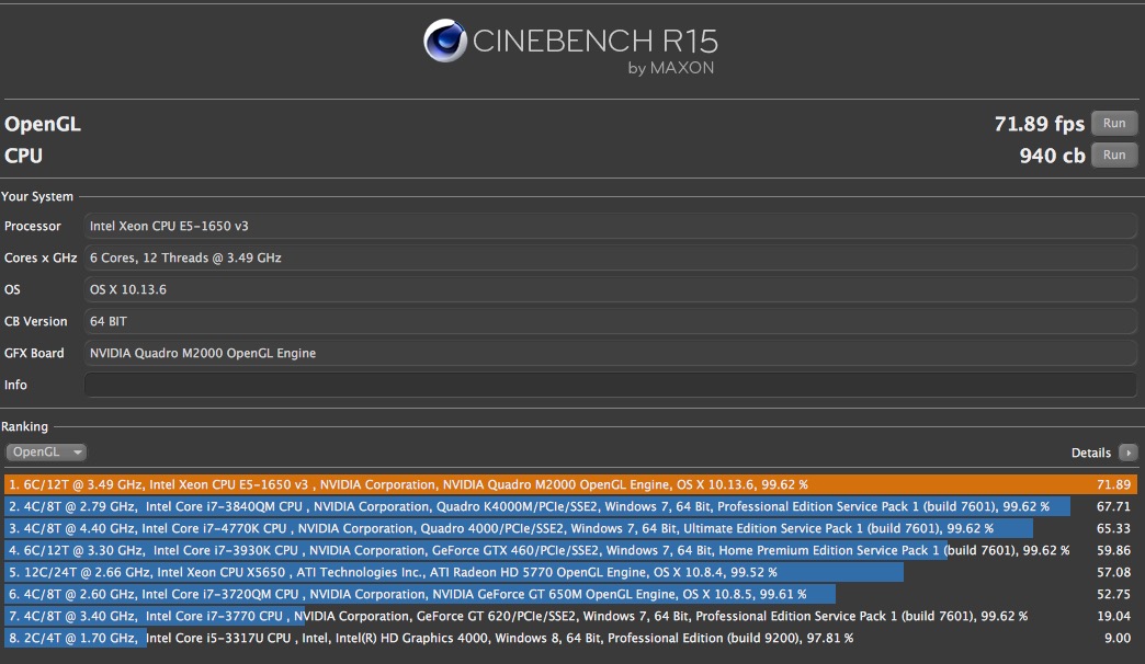

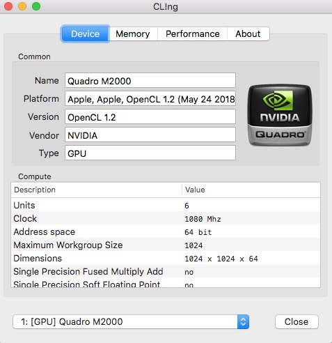

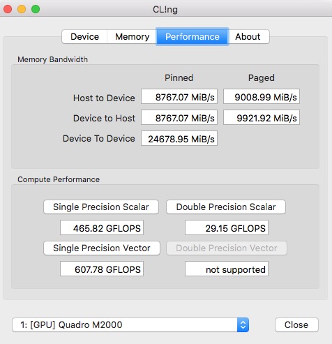

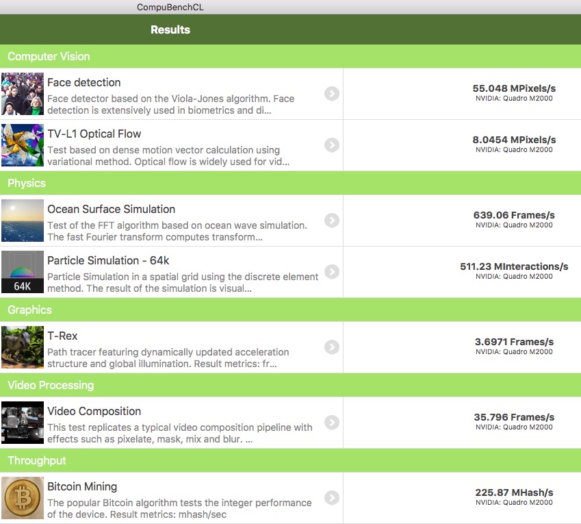

I temporarily had it in my Mac Pro 3,1 while I was testing some different GPU configurations in my latest hack to decide what machine to have the M2000 in. It does work fine in 10.13.6 and should run Mojave fine as it is a "Metal" card.
It does require the NVIDIA WebDrivers in order to have any acceleration in macOS.
I'm just using it to run multiple displays, 1 native DP and 3 via DP active adapters 2@ 2560x1440 1@ 2560x1600 1@ 1920x1080.
I'm not using it for any of the CUDA (I do, however have CUDA drivers installed and current) or real Quadro features.
It is currently in a hack that is roughly equivalent to a MP6,1 based on Geekbench scores ...
Dell T5810:
C610/C612/X99 chipset
Intel(R) Xeon(R) CPU E5-1650 v3 @ 3.50GHz
32Gb DDR4
While in the hack I did some basic benchmarks under non-ideal conditions (lots of apps open) so this may give you some ideas on the ability of the card.
I'd suspect that the 3,1 wouldn't be able to hit these same numbers with this card due to PCIe version differences and probably CPU / RAM differences as well. But I figured I'd try to give you some idea here.
Is there some specific test I could run for you?
Reactions: pullman
Dell T5810:
32Gb DDR4
