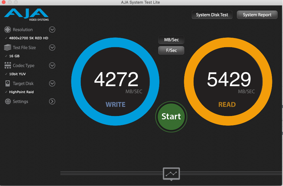

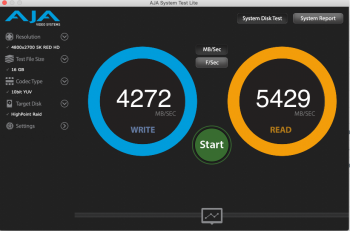

I found the HighPoint SSD7101A-1 pretty good. get this sort of speed with 2x 970 Pro in raid0. Due to the MLC on the 970 Pro the speed is fairly consistent

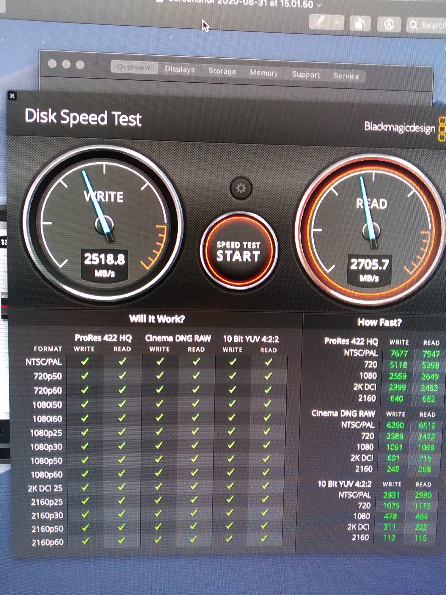

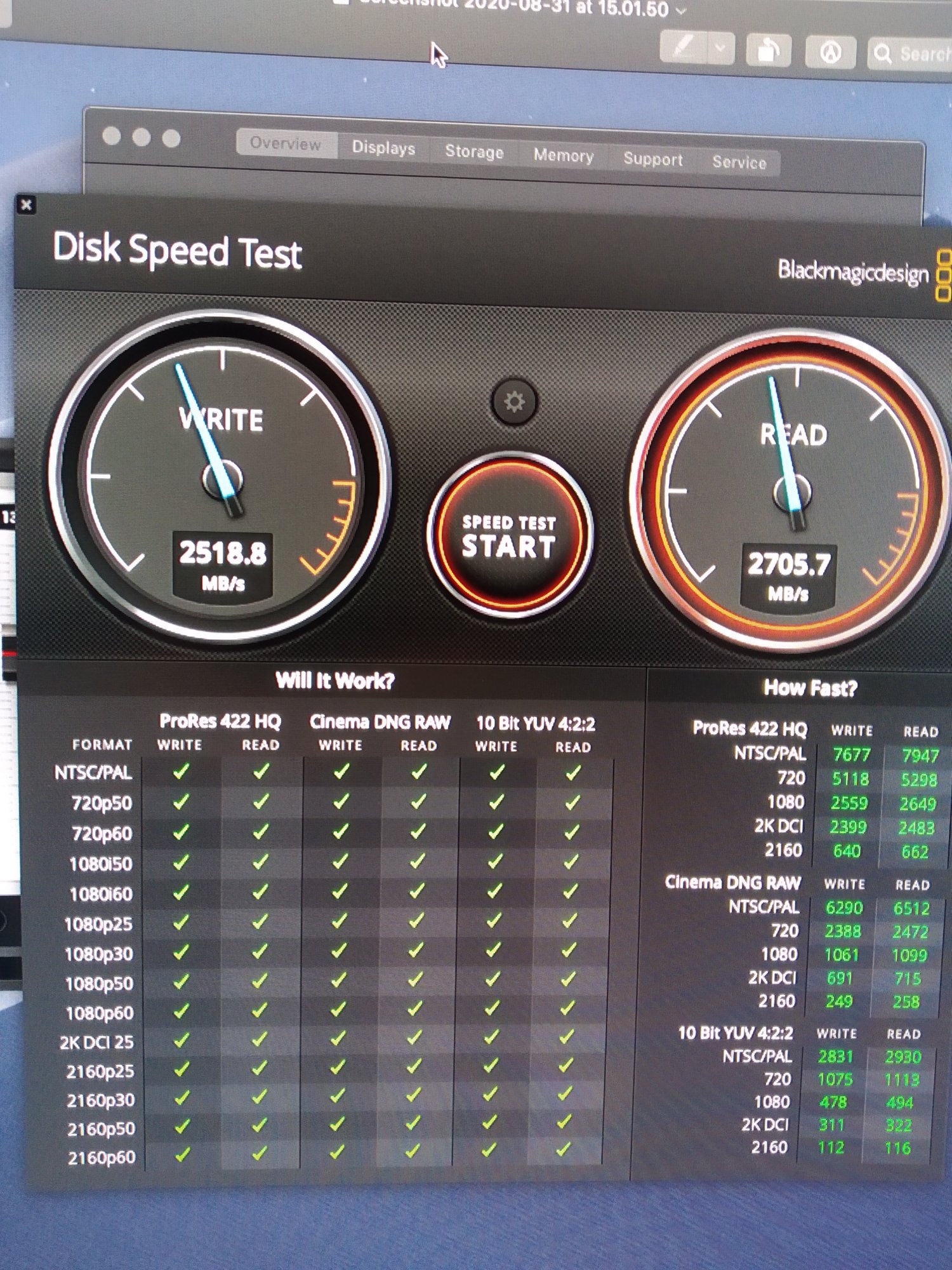

Last weekend I installed a 2nd blade on the Lycom DT-130 card. All problems solved! Here are my speed results with a Samsung 970 evo 1TB:
Only thing I experience is that when I test with large 4gb files the writing speed suddenly drops to about 50% after the first seconds. But reading speed stays high. When I select a 1gb file for speedtest then the writing speed stays high as well.
