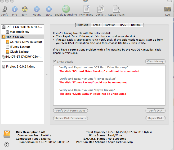

Am I doing the right thing here?

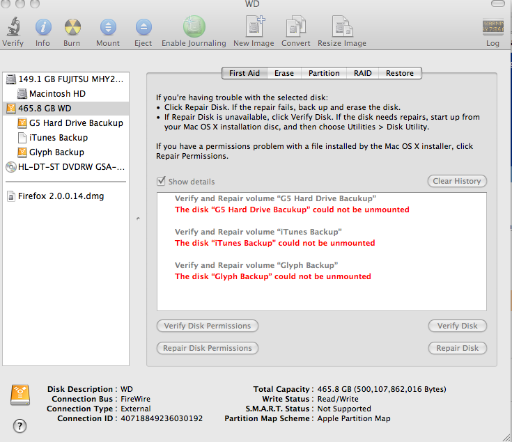

Update: Now I can't unmount any of the external partions. Grr. I have no idea where to begin.

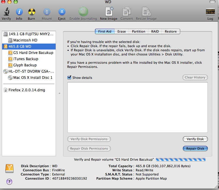

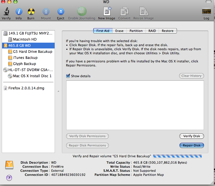

Ok... so what disk do I need? I just have the MAcBook install discs 1 and 2. 2 is jut xcode stuff and disc 1 is the Mac OSX install disc. I'm not sure what exactly to do though. I just what to Disk Utility and tried to repair my external HD is this is what I got:

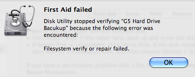

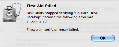

When I went to just verify the G5 CC I got the following message. I'm so lost. Please help!
The external drive does need to be unmounted for DU to work its magic. Can you boot your 'Book from your System Install DVD? Don't start the installation process, go to the Utilities menu, select Disk Utility, Repair Disk.
I can try. Is that where I insert the OSX disk and hold down the C key while it starts up?
Also, I should be starting up with my external HD unmounted, right? If so should I plug in the external afterwards so that when I click on repair disk in disk utilities it repairs the external?
Will do! I'm on it now and I'll have an update in 10 minutes! Thanks so much for the help thus far.
I ran disk utility from the install disk and clicked on repair disk for both the MacBook's HD and my external. It came back without one error. It said everything was ok? I'm a bit confused now. Well a bit more than I was before.

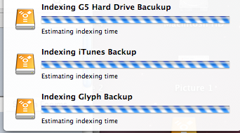

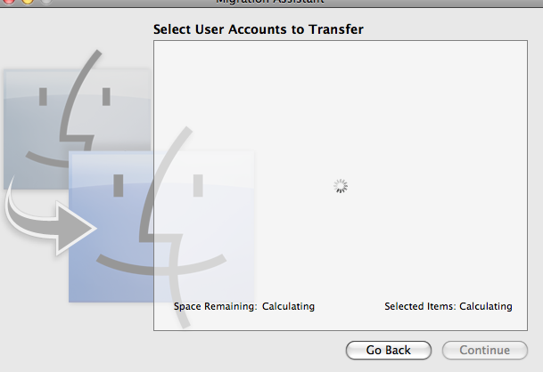

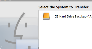

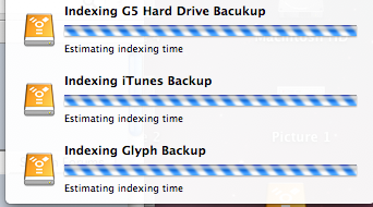

I just booted in safe mode and opened up migration assistant. I did see the drive this time, but like with some other unsuccessful attempts this go around shows the drive with no FW icon on it. I've never seen that until this issue. I am connected via FW 400. See the pic at the bottom.
Also, do you think Spotlight indexing my drives is causing an issue? Should I wait to try migration assistant until spotlight is done indexing?

I am surprised that Spotlight is indexing in Safe Mode. But I don't think that should kill the deal. Go ahead and try Migration Assistant, pray!

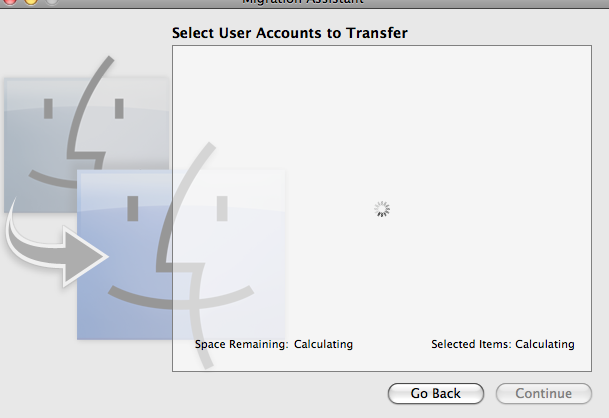

So now it's just hanging. It's been like 5 minutes. Hasn't quit though. This is all Ive seen the past 5 minutes:
