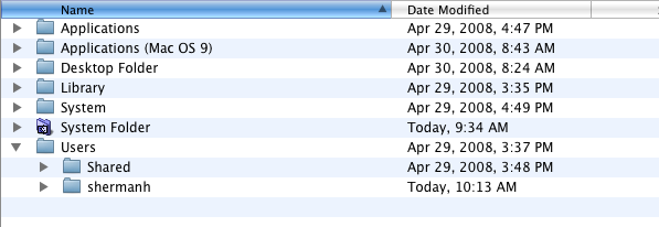

Give us a screen shot of what the root level of your G5 backup looks like. Double click it, view as list, toggle the Users folder open.

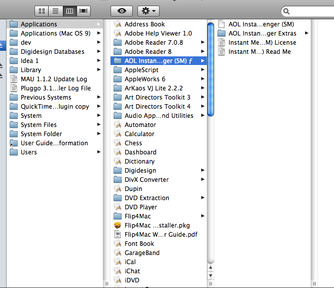

Weird. On my cloned drive, it showed up some folders, but there was nothing on my user account and look at these icons for my apps ????? One of my other partitions doesn't even show anything, when I click on it in my desktop, but the space there is still used.
