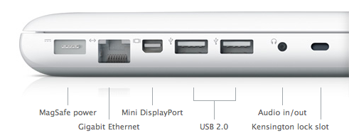

bought a new headset, it has 2 cables. one is the music one and the other is headphone.
i got the music one. which one is the microphone one? the 1 beside the music one? i have it plugged in but its not showing in the sounds in preferences
White MacBook
Aluminium Unibody MacBook, the same as with the white MacBook

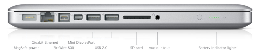

The White Unibody MacBook has no dedicated audio in.
The Aluminium Unibody 13" MacBook Pro also has no dedicated audio in.
So, I'm out of guesses, someone else has to tip in now and guess further what the problem could be.
So, what MacBook do you have and do those jacks connected to the headset have some kind of colour coding (green/reed/pink/...)?
Any more information you can give us, like OS version, software you use with the headset, ...?

MacBooks (even in the PowerBook days) do NOT have a microphone input jack. Line-in jack is different from microphone jack. A microphone input is an amplified port, whereas line-in is not (it is simply an audio input).
The reason your headset is not working is because the audio signal is not being amplified through the line-in port. I tried getting a headset before and used the line-in thinking it would work. Nope. Tried (and returned) two different headsets before realizing this. I needed a powered USB headset.
I guess either buy an external sound amplifier or get a USB-powered headset.
