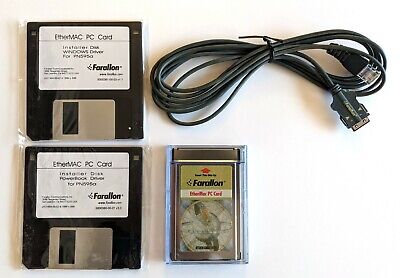

The 5300's use a PCMCIA card for ethernet .
Next to the battery is the card case with is released by a slider under the body.
It holds 6 std cards or 2 double thickness cards .
The 2 slots are next to the CD drive on the other side
I have 2 ethernet cards included in a bundle that I was going to give away with a working 5300 that has a broken lid hinge.
However that post will probably be deleted by a moderator when they see it as I am not allowed to buy swap sell or give away anything yet.
The 5300 had 2 slots & I think the WallStreet & Lombard had a single type 2 ( thick card or thin card ) and the Pismo had the same double slot as the 5300 series also had them then they were discontinued in macs however they are still available but I am fairly sure the PC ones did not work in a Mac .

As for the ethernet I was surprised to see them add it to the 5xx series and then remove it from all subsequent models until the arrival of the TiBook.
Will that PCMCIA card work with the 5300ce (MacOS versions 7.5.2 - 9.1)?
