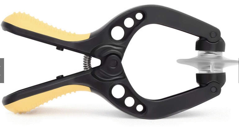

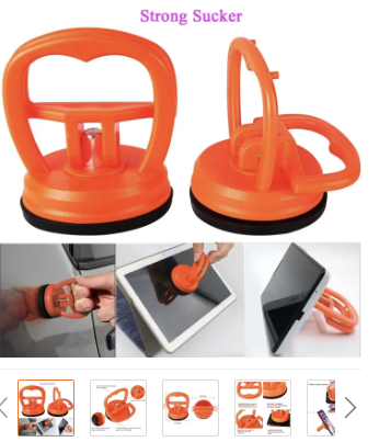

The suction cup I (I found laying around, it's used to suck onto glass to hang things) usually use that works with the iPhone 3G and iPhone 5 (granted their screen are not cracked, it's smooth) won't work with the iPhone 6s Plus. Which iPhone suction is best for cracked screen glass of the iPhone 6s Plus? Is it the big orange one (suction cup diameter is 5.8cm) or the one with two jaws? Should I just use silicone sealant oe similar let that dry (or even super glue, I also have the water based, milder Elmer's glue) onto then use my current suction cup to glue it onto the screen for more pulling force, so I don't need to buy? Other recommedations are welcome.

iPhone repair kits usually come with a cheap suction cup about 1.25 inches or less. What's the largest circle of unbroken glass on that phone?
Hi, unbroken glass near the Home button, the largest is about 1.5cm.
