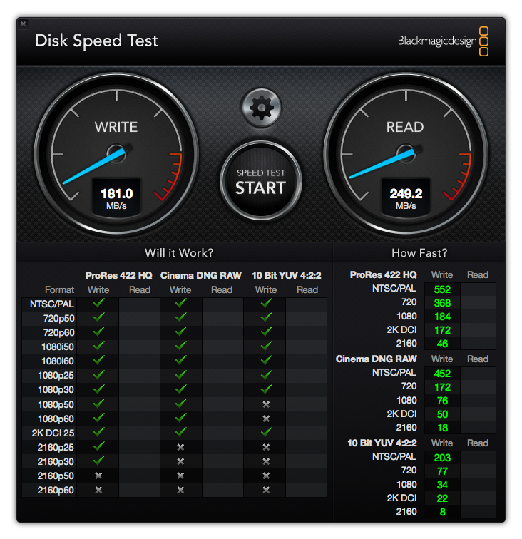

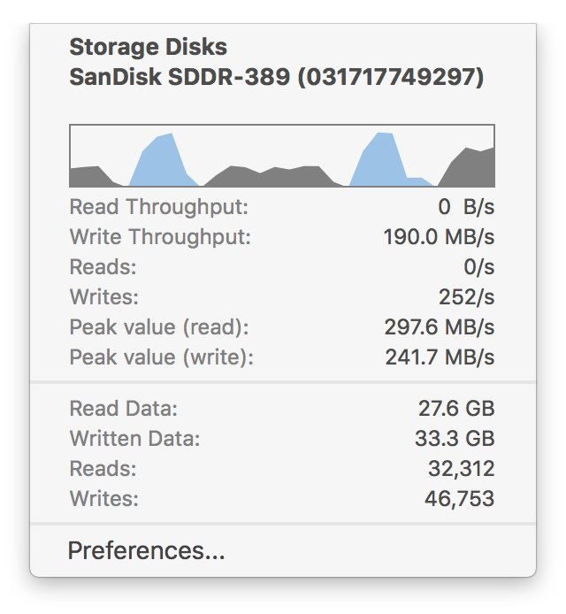

these are my benchmark speeds using a SanDisk UHS-II card reader and a Sony UHS-II SD card in the USB-C port of the Ableconn UP31 PCIe card:
Mac Fan Control:
Peak read 297 MB/s
Peak write 242 MB/s
BlackMagic Design Speed Test:
Read 181 MB/s
Write 249 MB/s
