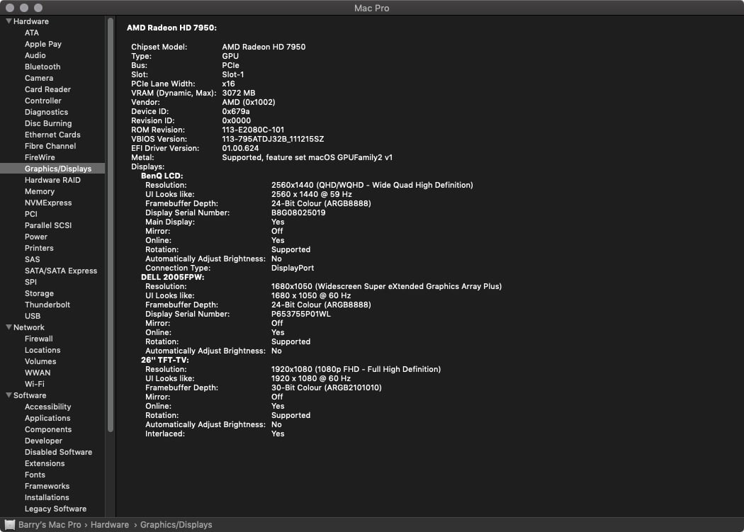

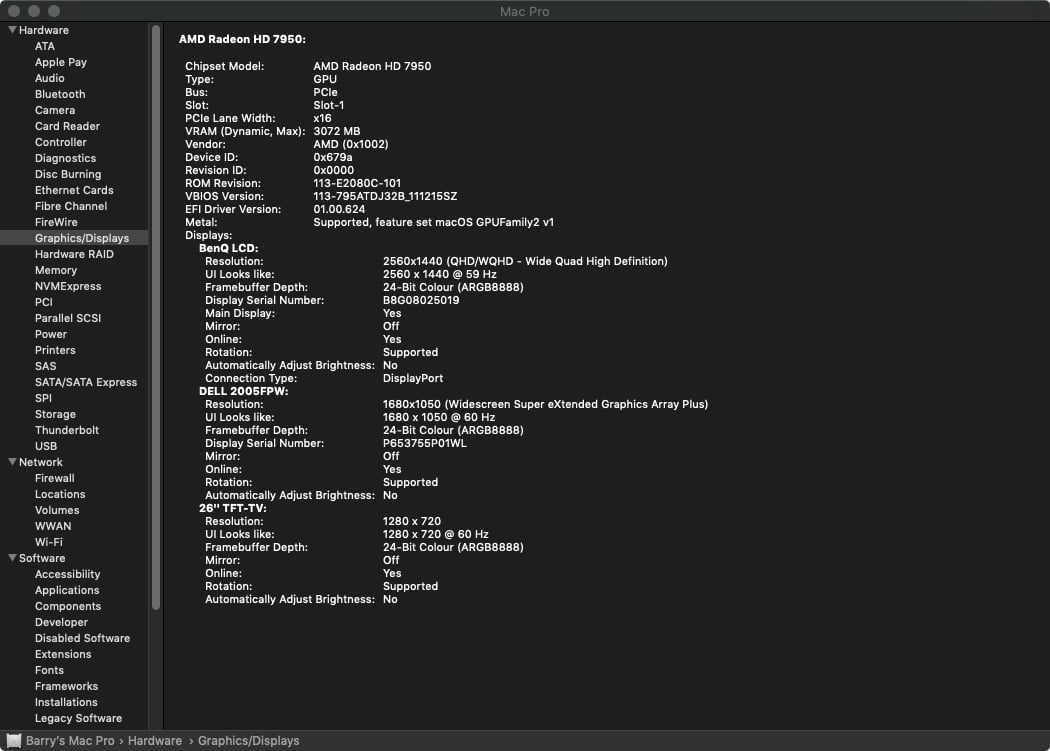

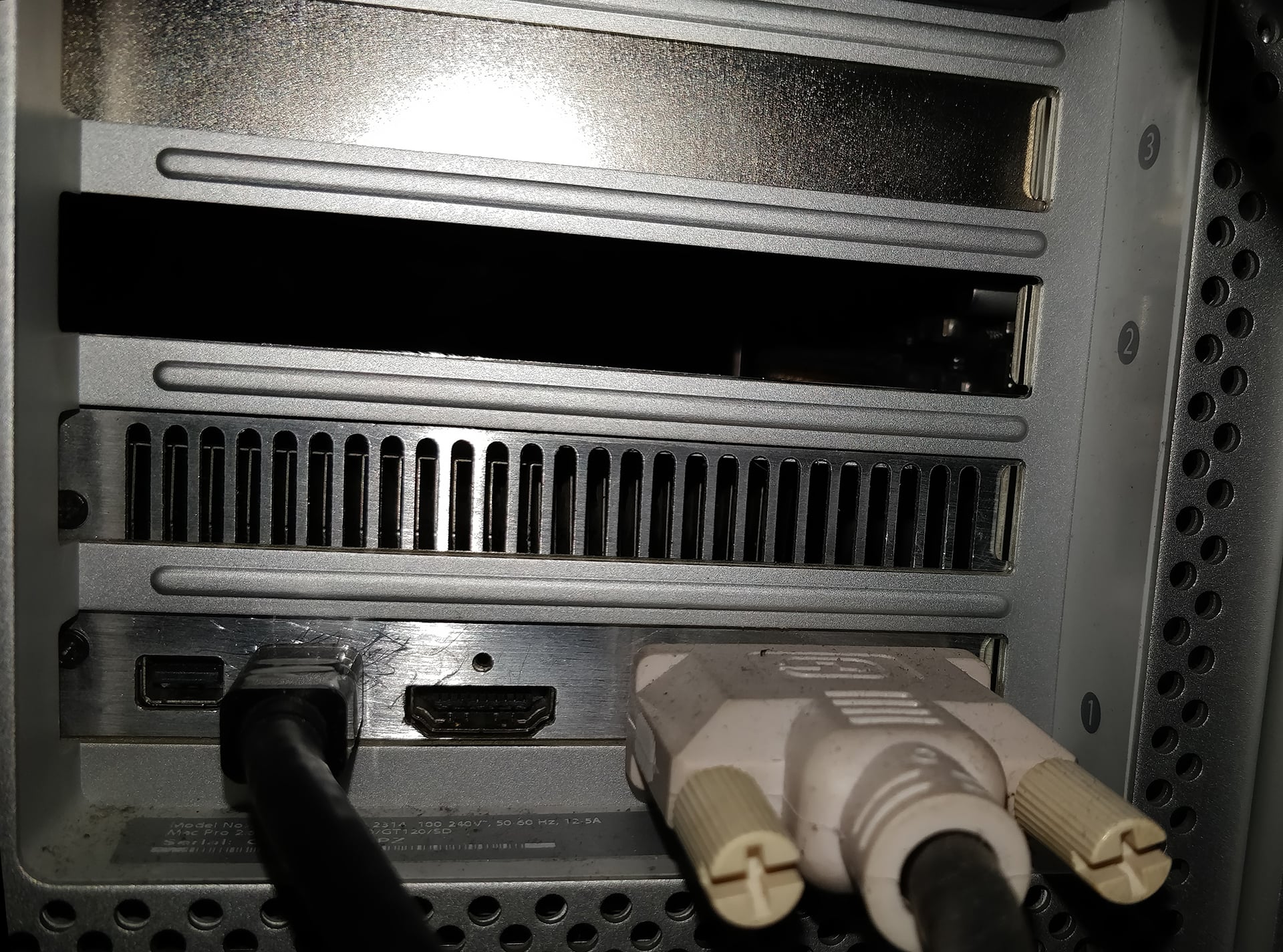

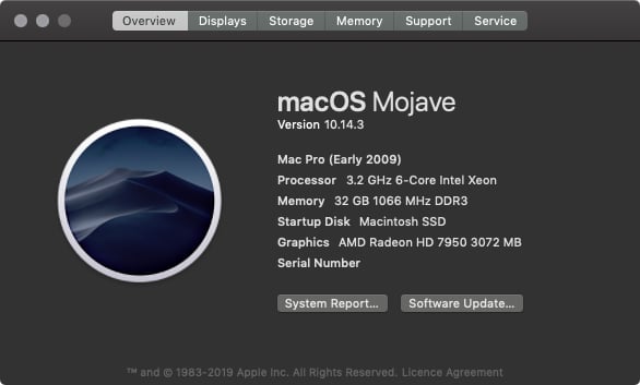

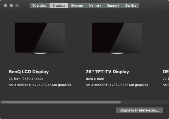

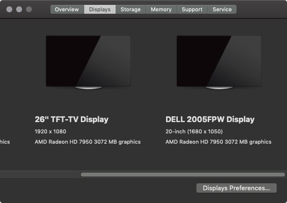

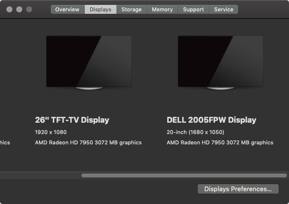

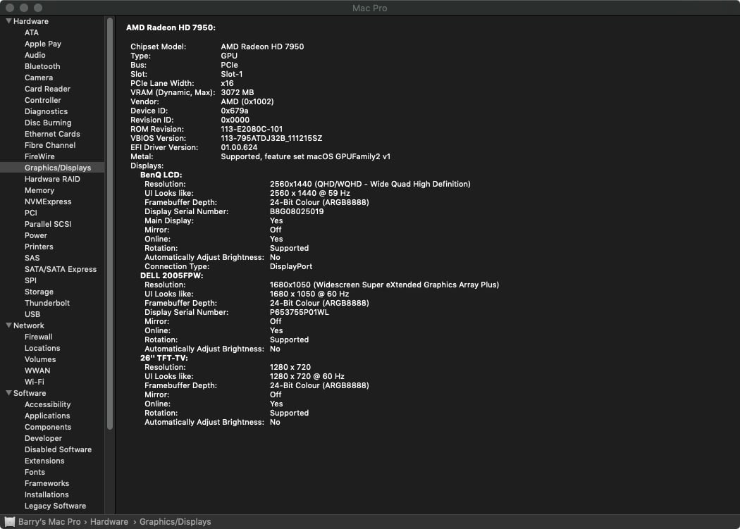

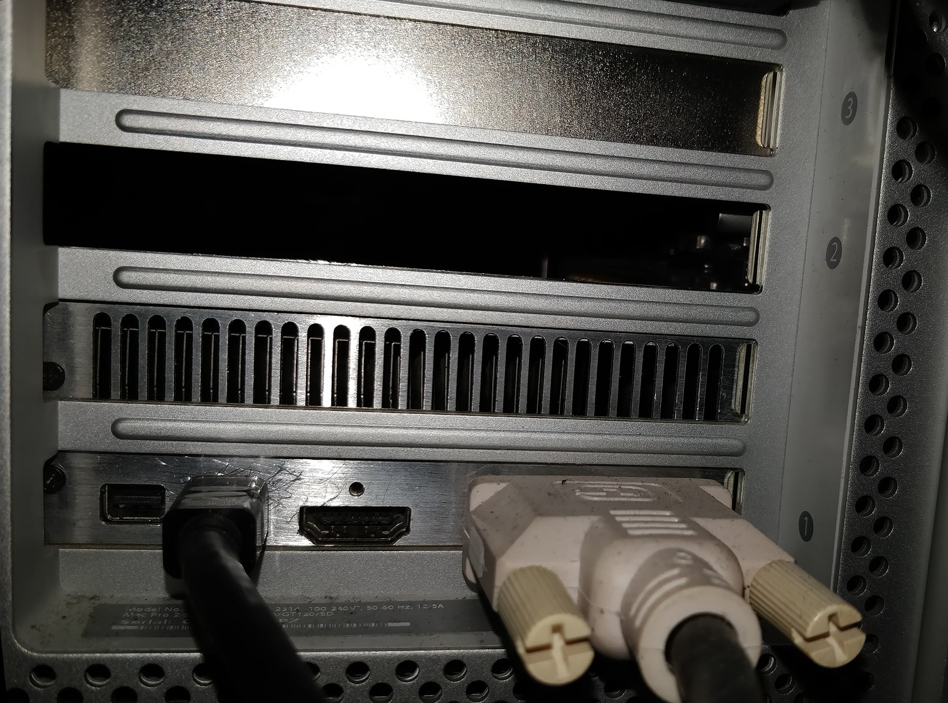

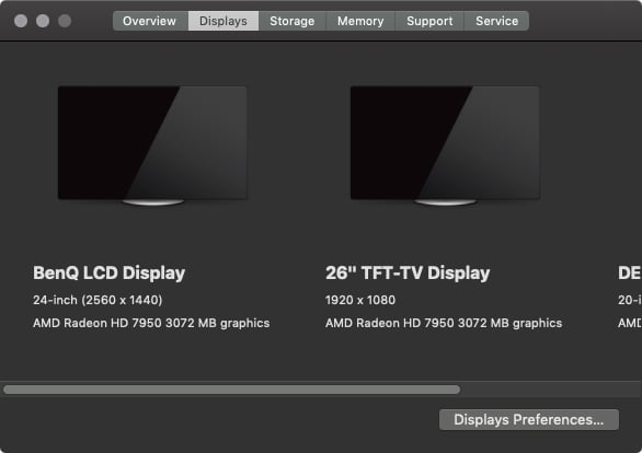

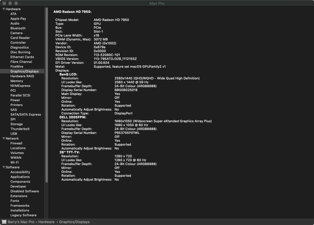

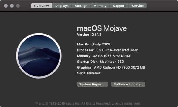

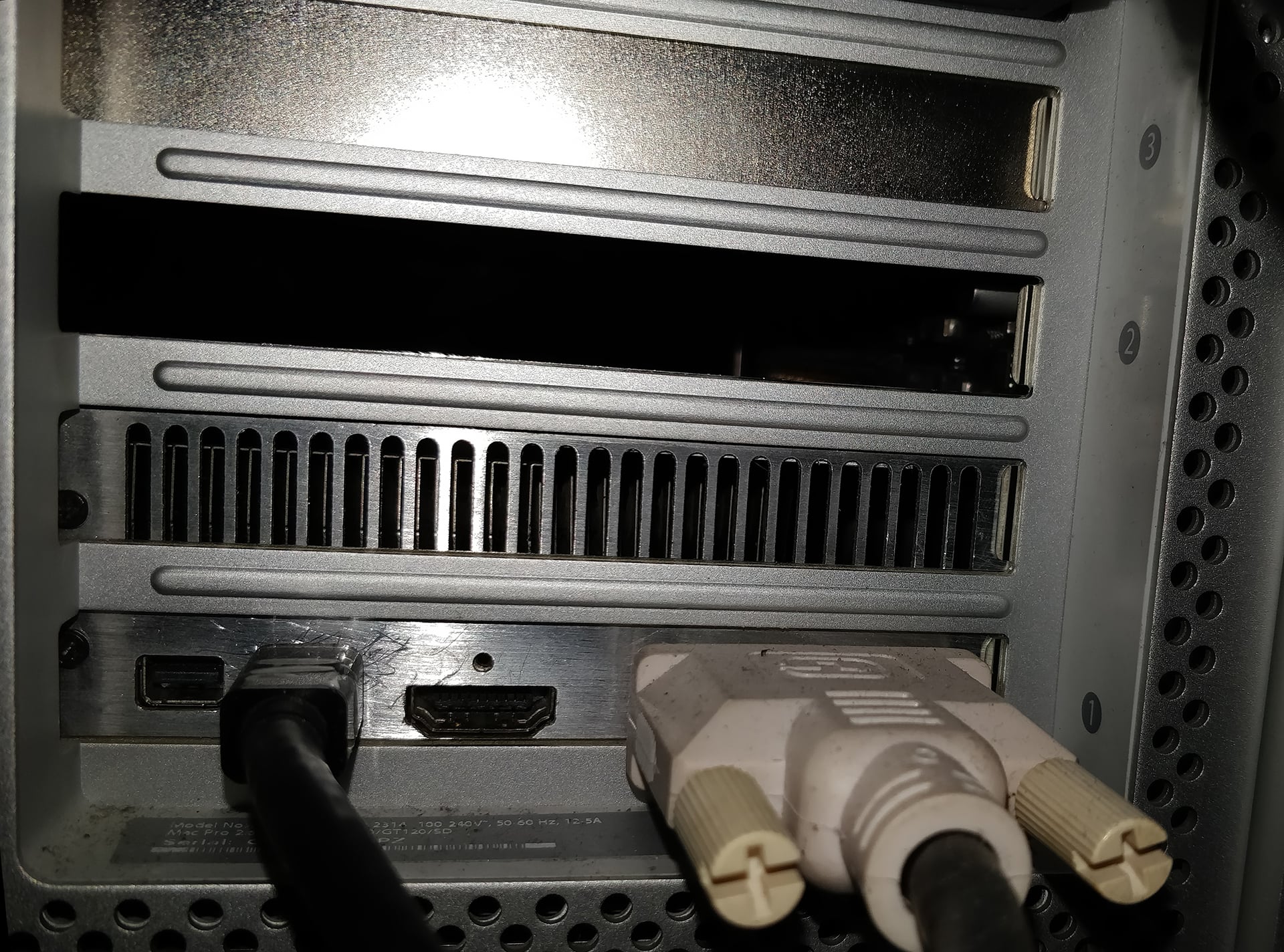

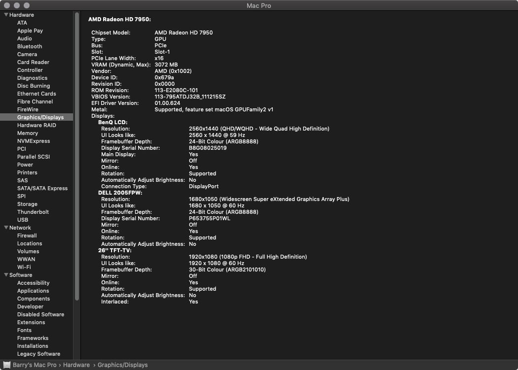

I have a Radeon HD7950 and have run 3 screens off it no problem one DP, one DVI and one HDMI, so I don't see why the newer ones wouldn't do it
can you tell which subvendor and which model (serial?) of your card please? and can you show your screen with 3 monitors and the connection of your cable back of your mac please ? thank you so much

With my Vega 56 (from my Mac Pro) on my Hackintosh: 4 screens
cool, thanks, i hate to wait for the slow expedition

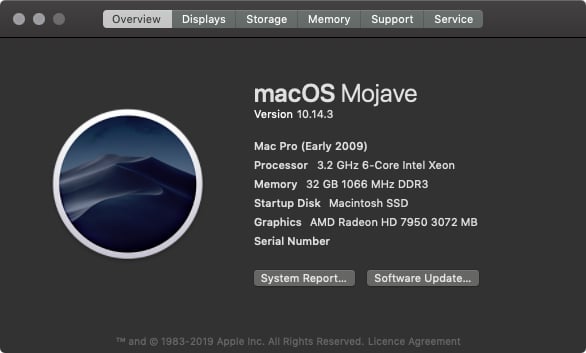

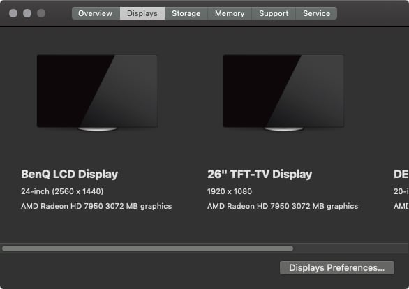

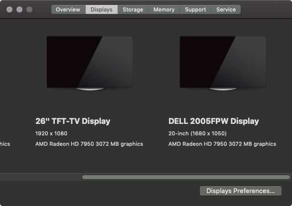

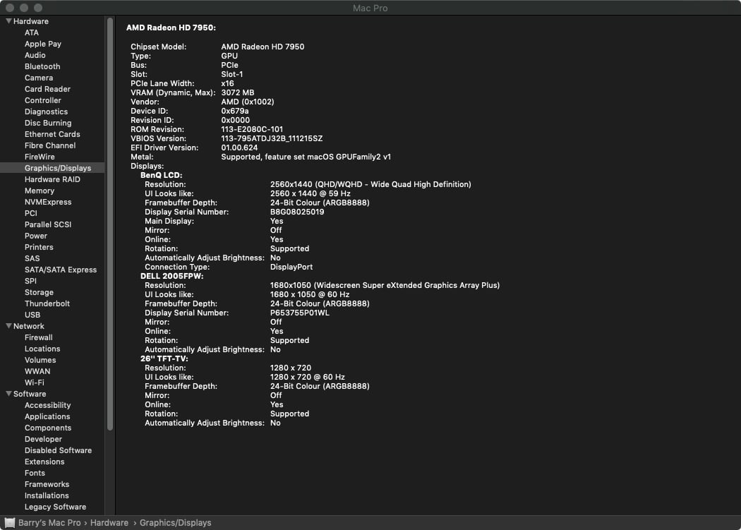

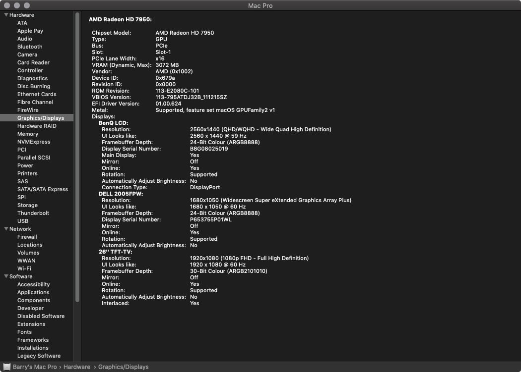

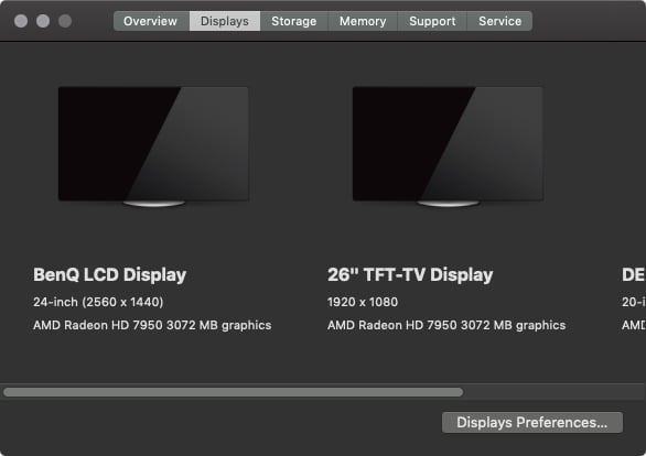

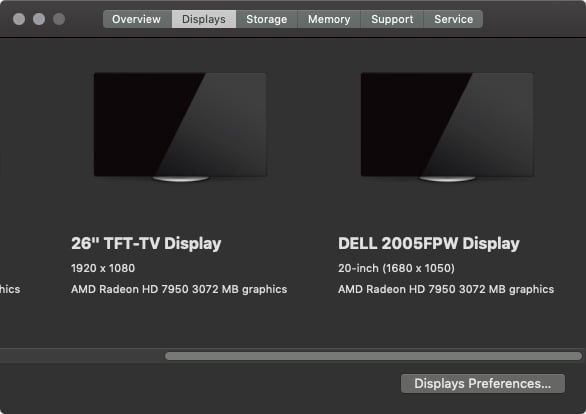

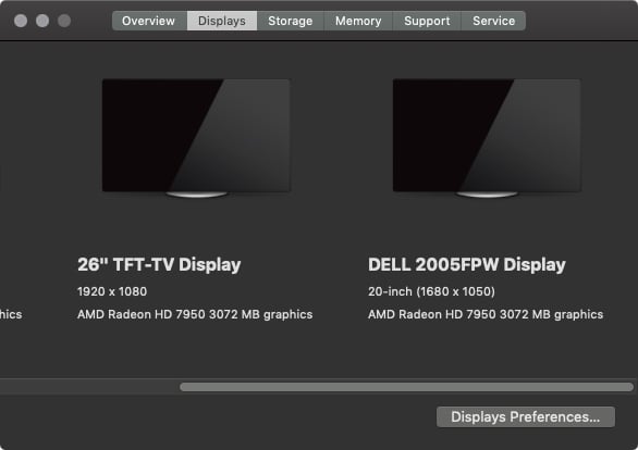

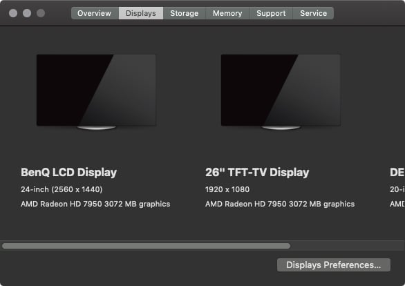

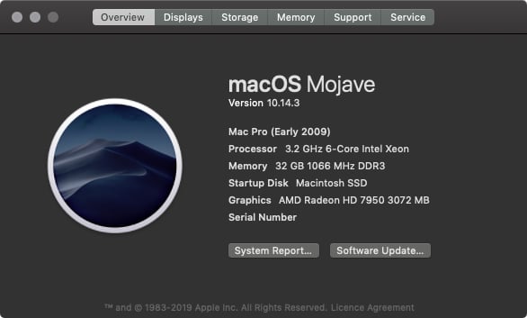

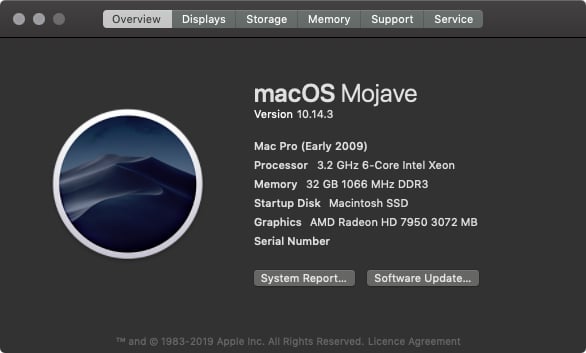

3rd screen is just a 720p/1080i TV as it's all I have about at the moment, and I just use it for Final Cut viewing of in progress edits, planning on getting something 4k soon, and probably an rx580, but here's your requested images. I can't tell you a whole lot about the exact card other than it's reference design, it came to me without the full cooler shroud on it, just the heatsink as it'd been used for mining and had a different rom on it, now has an XFX cooler, rear outputs as you'll be able to see are 2xminiDP, HDMI and dual link DVI
about this mac.jpg displays 1.jpg displays 2.jpg pic of rear.jpg Screenshot 2019-01-31 at 23.39.08.jpg system report displays.jpg
View attachment 819339 View attachment 819340 View attachment 819341 View attachment 819342 View attachment 819343 View attachment 819344
thank you bazza for your photos, i think the most useful infor is the vbios version, i gonna try to find this, but it doesn't mean we can copy your method connect 3 monitors, i've just received my 580 8go, and it is indeed working with 4 monitors, thank you for your help, should be useful too for others
