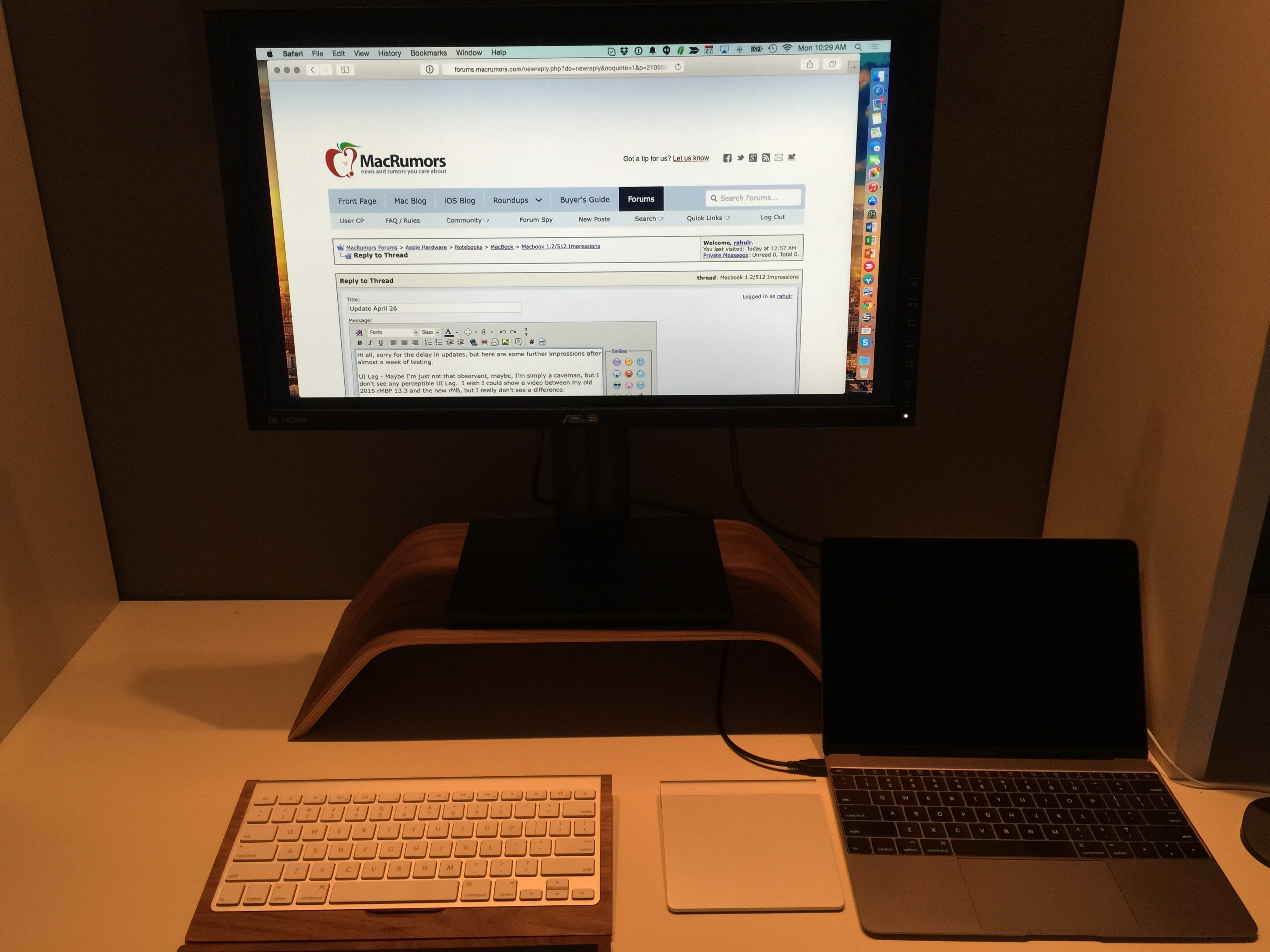

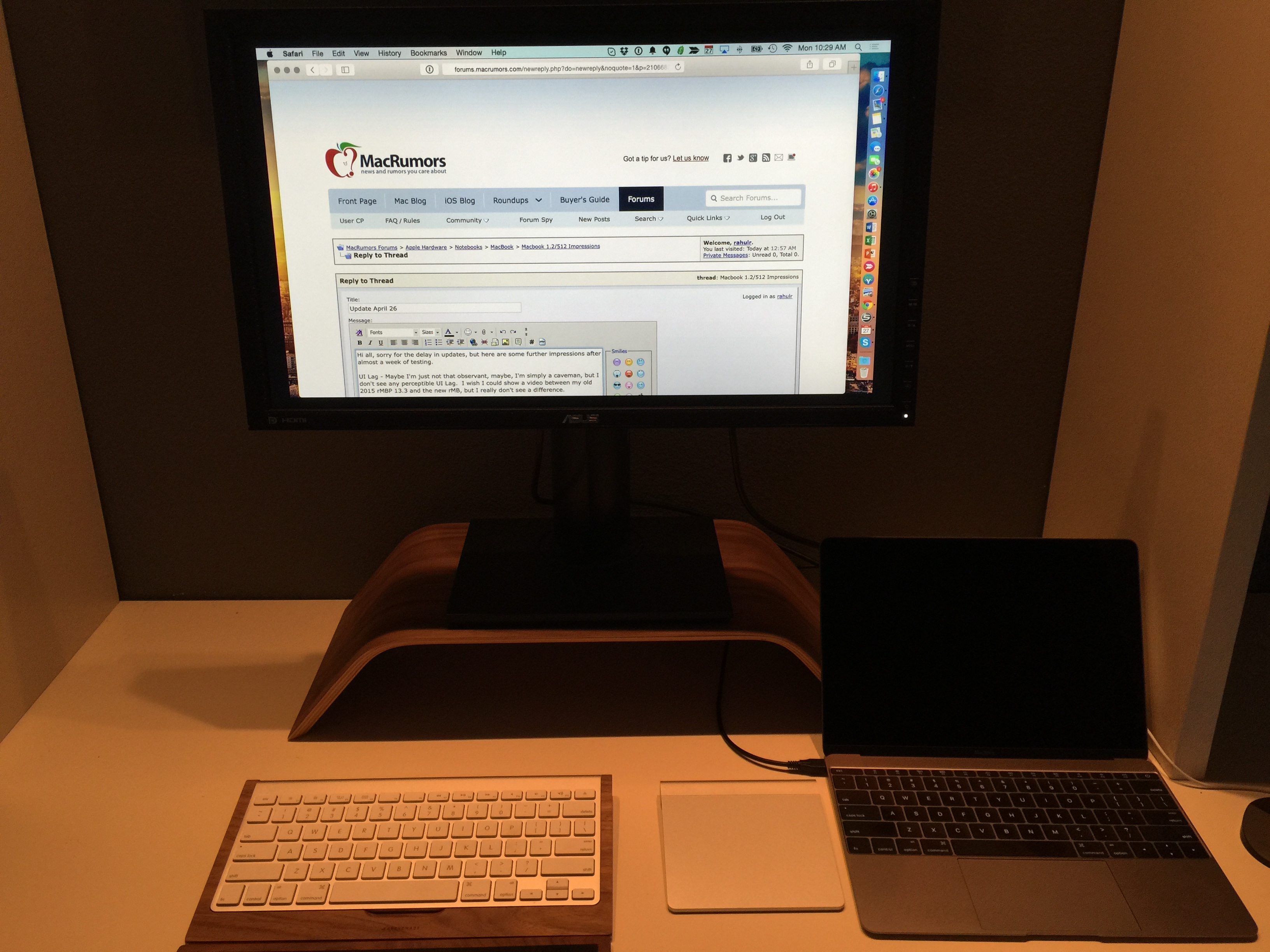

Here's my jerry-rigged solution. I have my rMB plugged into an in-wall USB outlet which while not charging the rMB under load, it maintains the charge. Then, when the lid is closed, or brightness is turned way down does begin to charge. In order to deliver a picture to my external, I use airplay mirroring with an apple tv.
It's not ideal, the picture on the monitor is a little grainy, but it's more than enough for regular office work.
I'm just waiting for the AV plug and then I'll be golden.
