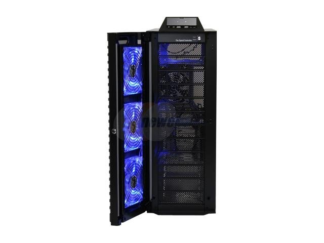

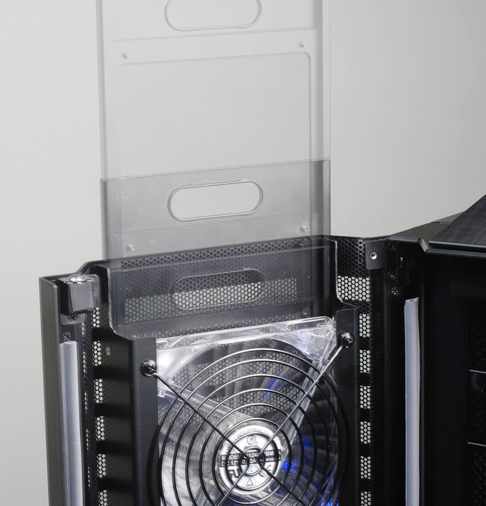

Here is the case I have, works well. Just clean out once every few months and done, no need to even open the case. Would have been nice to see this on the Mac Pro. Oh well no big, well see how much of a task it will be once it arrives and I have some use on it.

Having a filter on the front is not a problem for the cooling. I resorted to a piece of anti mosquito netting on the front to stop the dust clogging up my '08.
