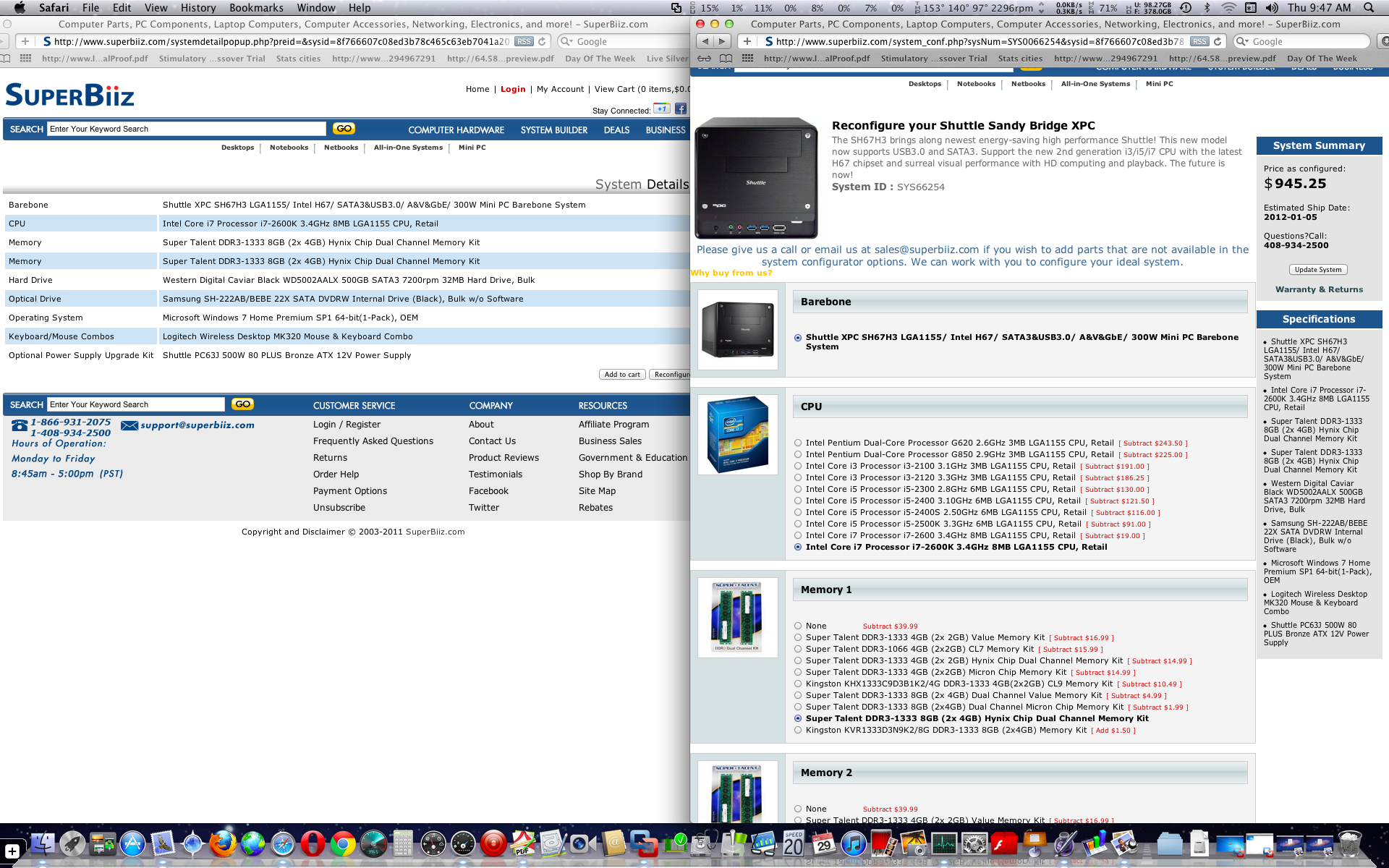

yes and as a former mac pro owner and user it is sad that I may need to build this for my ht.
this is 950 add a decent gpu is 150 or so like a 6870 around 170
add a blu-ray drive is 100 total of 250 like a pioneer bdr-206dbks
plus the 950 is 1200
i can add a gpu and a blu ray drive and have a 1.3k system that spanks most any mac except the mac pro.
I can fit this in my ht rack I can't fit a mac pro and an iMac is useless due to the small screen (27 inches is small for ht)
this machine is a very nice ht/gamer machine. so at a 1200 to maybe 1400 range i have what I want.
the only machine that can do this from apple is the mac pro cost more then 2600 with the blu ray player and the mac pro is too big.
