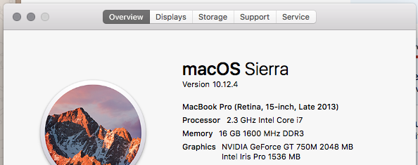

If you need more help. Please let us know the exact configuration of your Mac from "About this mac". How you have monitor connected (direct to Thunderbolt, HDMI, etc). And whether you are using the macbook with the screen closed or open. All of these effect performance.

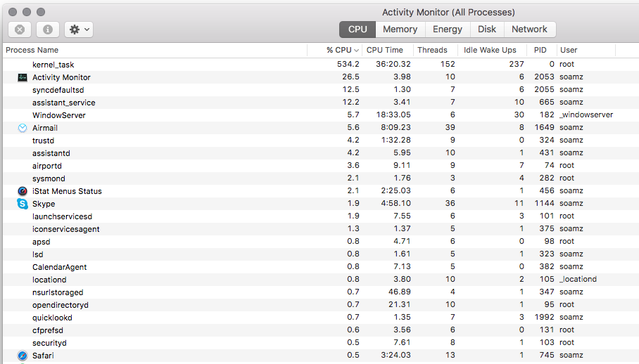

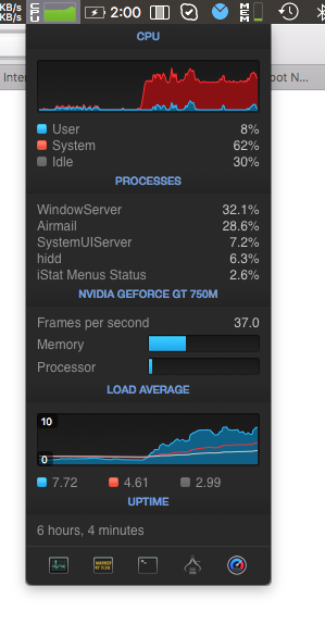

Here are the screenshots I took, when it dies 🙁
Here it is bro.
Please let me know.
[doublepost=1493738536][/doublepost]
Here it is bro.
Please let me know.
It looks like your system overheats. This happens due to high load on the system running external display in combination with inadequate cooling. If your laptop sounds like it's about to take off, then your fans are running normal and you just need to clean the system inside to remove any dust that makes cooling inefficient. If you don't hear any sounds, then you likely need to replace your fans.

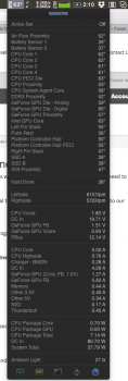

I would definitely try cleaning out the dust to see if that helps the situation. What temps is iStat reporting when this issue happens?
iStat images I attached above.
Shall I install something else to make the details more clear ?

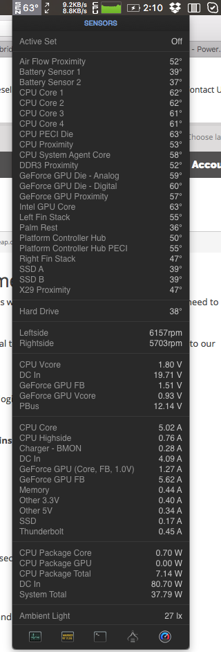

Under the 'sensors' tab iStat should show the CPU temperature. Just curious to see if it is indeed heat causing the problem.
here is the CPU and sensors details when it dies.
Based on those numbers it is not a heat problem. My machine idles with higher CPU and GPU temperatures when plugged into my 4K monitor. The fans are going full speed on your machine and there doesn't appear to be a reason based on the temps. Maybe make a Genius Bar appointment (if you have an Apple Store close by); even if out of warrantee, they can perhaps make a diagnosis.
Its 2013 retina, no warranty left
The Genius Bar will still provide diagnosis free of charge assuming they can replicate the problem. May be worth a shot to see what they say. Someone else here my be able to give better advice, but I really don't think the problem is heat-related given the temps in the image you posted.
