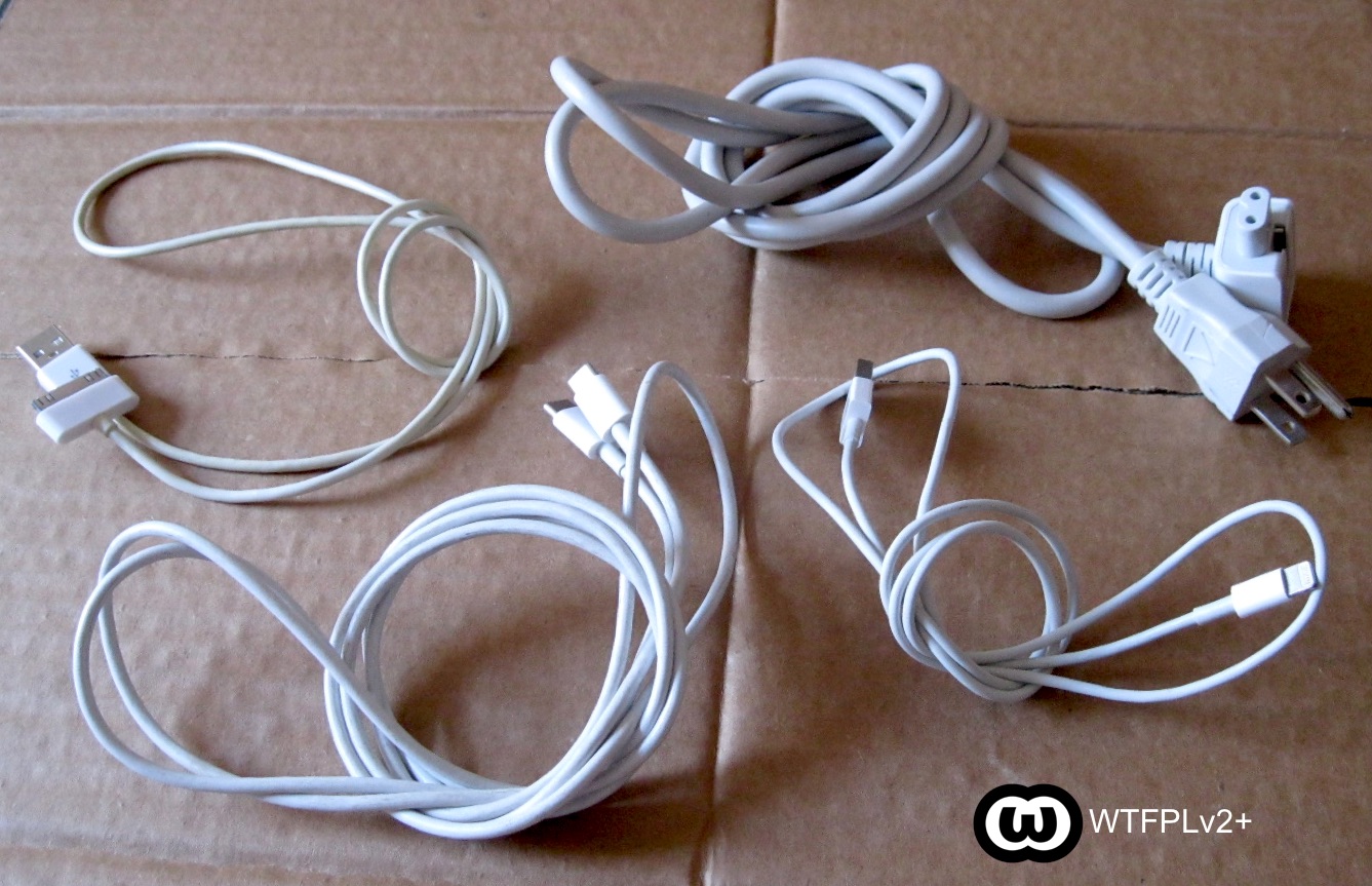

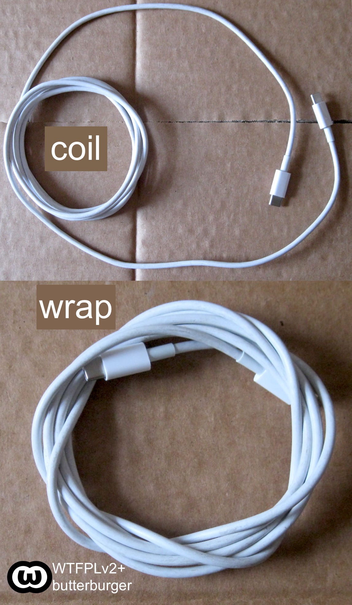

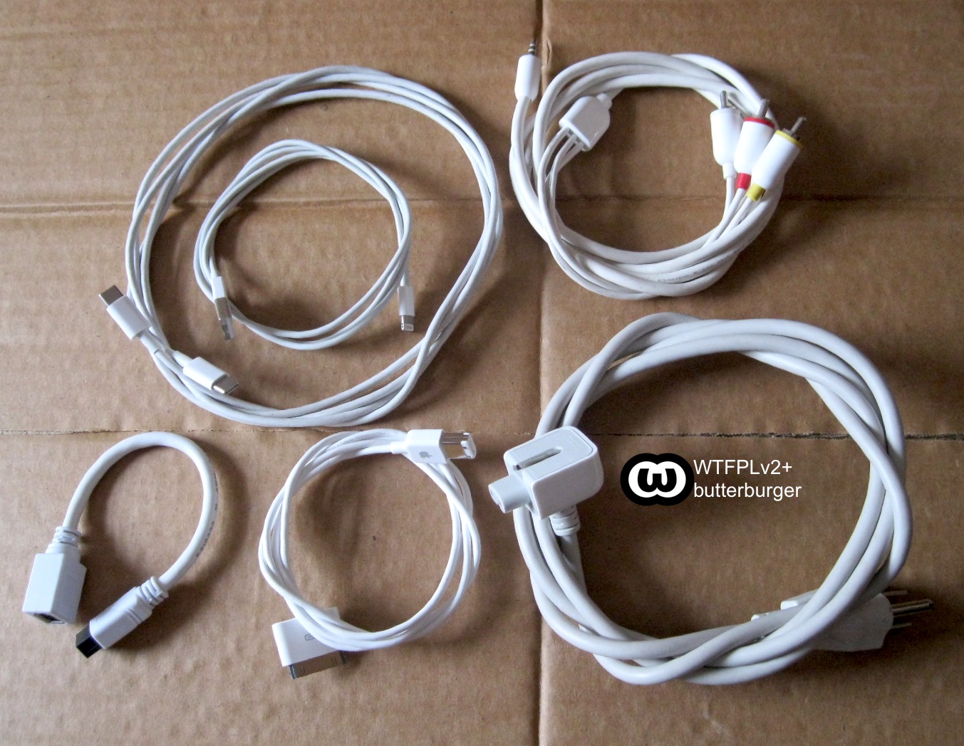

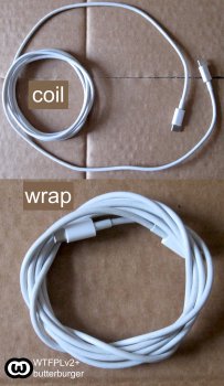

Yeah but you'd have to use a rubber band or something

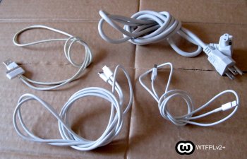

Yes, one may choose to use an accessory to aid in cable management: a little string to tie a bow, rubber band, button and loop (such as Bongo Ties), stretchy belt/strap with button holes (like Dell 5T339), twist tie wire, hook and loop (Velcro), self-sticking tape (such as bandage tape 3M Vetrap). There is a wide selection of fashionable cable accessories including: cable clips (such as Nice, Inc. Snap CableKeep), cable "tacos", straps like bracelets with magnets or snaps, frames to wrap around like a spool or yoyo or skeleton.
I want to not appear snotty with an opinion "how to accessorise an accessory (cable) is a First World Problem". Some of those retail cable management solutions are really neat. Whatever floats your organised boat.
Here, I'll tell you how I wrap my cables, manage to keep them relatively tidy. This simple idea does not use any tools/parts to buy or loose. Using your hands, coil-up your cable. Leave twenty cm (eight inches) not coiled off both ends. Then wrap both ends around coil; like a corkscrew, like a spiral-striped pole, like wrapping a ribbon around a wreath.
You can make it a small, thicker, coil; or a large, looser, coil. This is not a good plan for earbuds or similar cords which are thin and limp. Limp cable will not hold its coiled wrapped shape, will tangle. This method will not help manage a dongle parade. (One short converter cable is pictured at bottom left.)
Some will prefer to simply tie their cables like this:

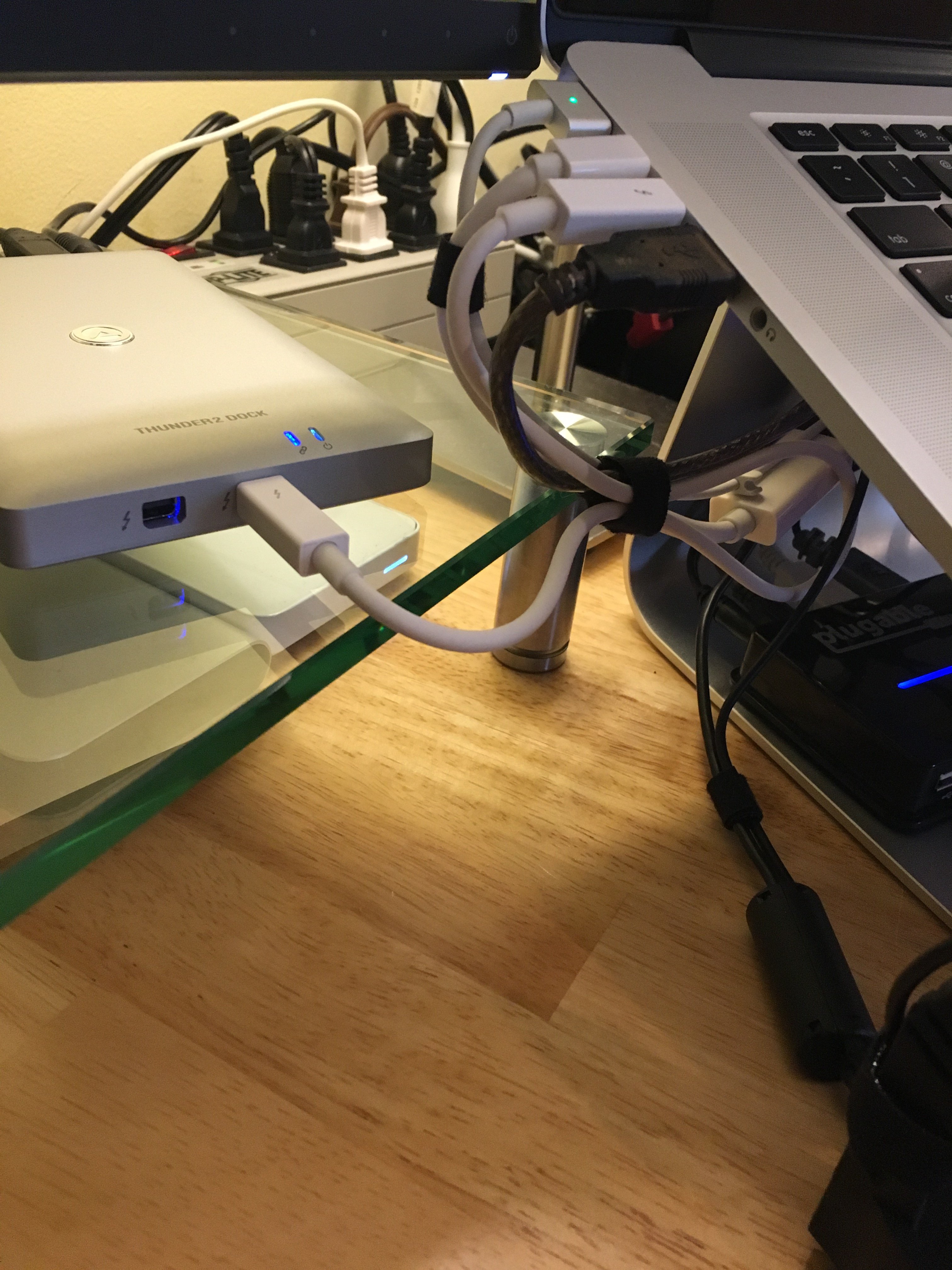

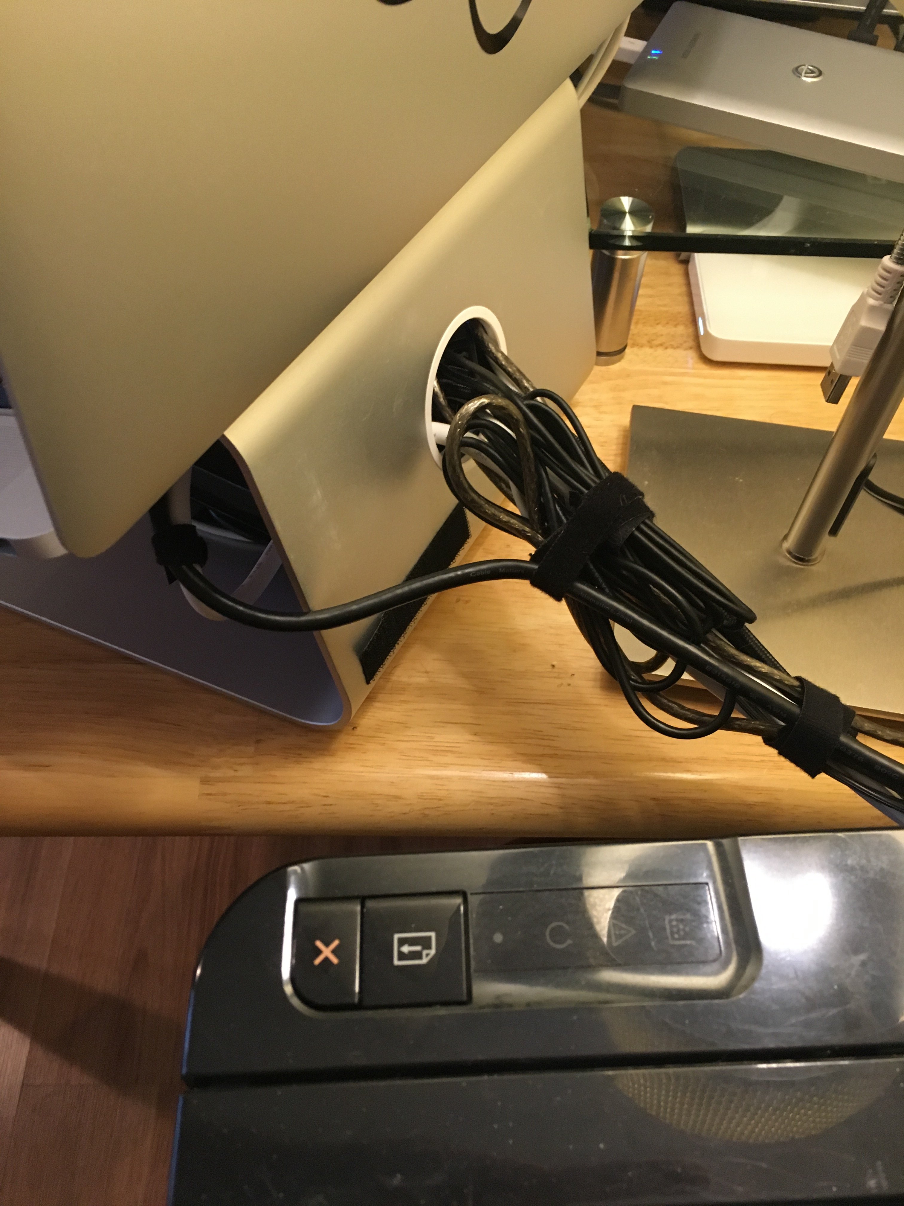

I'd rather use the plain velcro rolls, not the small separate strips because you can cut them to any length you need. Velcro is the material to use if you need to do cable management (especially in racks where it is not uncommon to add yet another cable).
