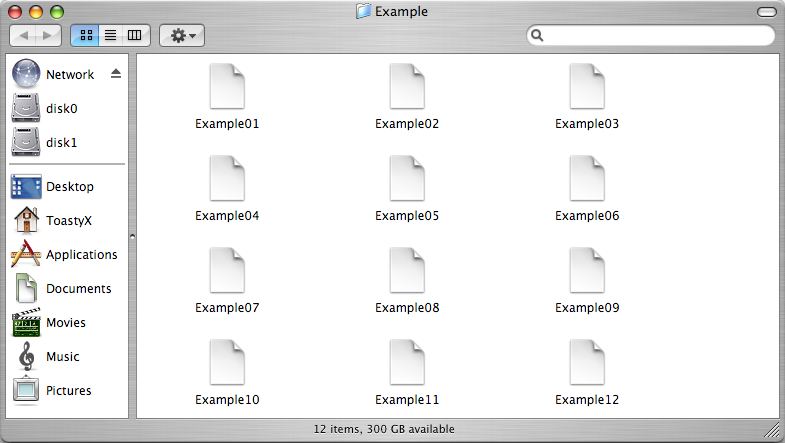

Okay, I'll give an example of one of the little bugs and glitches I run into all the time.
Here I have an example folder with 17 files named Example01 through Example17: http://www.toastyx.net/images/finder1.png

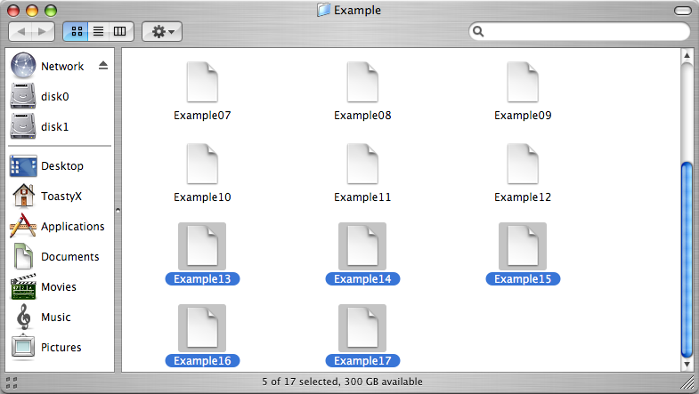

Let's say I want to delete Example13 through Example17. Here I scroll down: http://www.toastyx.net/images/finder2.png

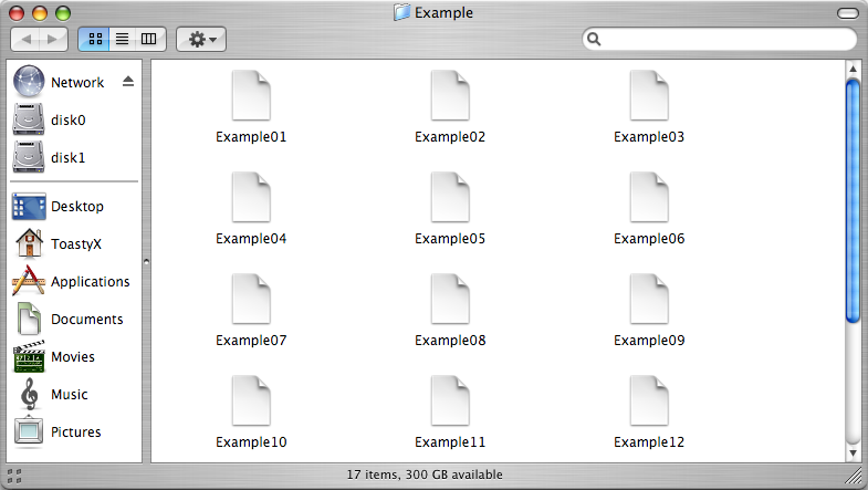

Then I select Example13 through Example17: http://www.toastyx.net/images/finder3.png

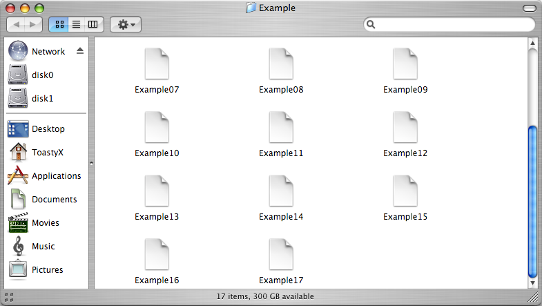

After I drag the files to the trash, the scroll bar disappears! http://www.toastyx.net/images/finder4.png

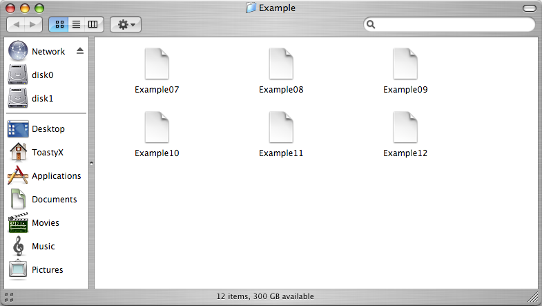

Now I can't scroll back up to see Example01 through Example06 even though the files are there. After closing and reopening the window, it's back to normal: http://www.toastyx.net/images/finder5.png

I could reproduce the Finder bug, removing the scroll bar, but it's nothing that rearranging the icons by name from the menu couldn't fix. Amusing, though mildly annoying at worst. I have slightly bigger fish to fry, though.

I can't immediately duplicate this since I'm not on Tiger, but would agree this could be moderately annoying. Try using Cmd-1 after doing the deletion to see if the scroll bars come back.

Really? I just spent 5 minutes duplicating this procedure on both 10.3.7 and 10.4.2, and it just doesn't happen. No matter what I do, I can't get the scroll bar to disappear when it's not supposed to. I wouldn't consider "rearranging the icons by name from the menu" to be an acceptable solution, either. I would expect it to not happen in the first place. Fortunately, it doesn't...at least not here. I don't know what to suggest, except maybe it's a bug only in a certain OS revision. Make sure you're running 10.4.2.

I just figured out it only seems to happen if you have "Keep arranged by" enabled, which I have enabled for all folders.

BTW, I was able to reproduce the bug with the disappearing scrollbar in Finder, but only by exactly adjusting the window and icon sizes to the same thing you showed in your screenshots. The scrollball on my Mighty Mouse still allowed me to scroll up and see the other files. Clicking the zoom button (green button with plus sign at top left), as well as dragging a file up to the top to force a scroll also fixed the problem. It's annoying bug to be sure, but incredibly minor, especially compared to the kinds of things Linux does to you.

Hmm, tried that and I still can't get the scroll bar to disappear. I must be doing something "wrong." 😉 I don't doubt that this bug exists, but it apparently only happens under really specific circumstances that I can't seem to reproduce.
