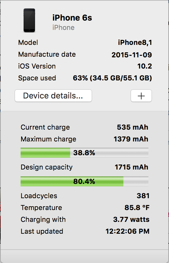

When I got the phone I never put a backup on it for 2 reasons. 1 being that going from iOS 6 to 9 would've been a major pain to deal with. 2, I didn't really need to put a backup on it because I could always grab my old phone and get what I need, not to mention that I didn't have much on it anyway. I have never restored and I probably won't anytime soon, unless iOS 11 looks that good. Then I'll restore to a fresh install of 11, that is if I haven't picked a new phone by then, which is being debated between my whole family from possibly switching carriers. The only thing that I can think of that might be eating my battery in the background is Hotspot Shield VPN that I run on my school's network. I have a jailbreak on 10.2, but as far a I can tell, it hasn't affected anything at all. It runs the same as it did before. The tweaks installed aren't really running all the time. It's just visual things like a theme and round dock. The battery itself isn't in great shape for being a year old, which is disappointing compared to my Dad's almost 3 year old iPhone 6. His battery life cycle is around 92% where my 6S is only 80%. I knew that my device wasn't effected by the battery issue as for it was manufactured in November. I just don't understand this phone at all.

I think I used an App back in the day. I'm sure there are still some around that tell you if you google it. If you have a Mac Coconut Battery will tell you as well (in addition to providing information about the condition of your battery.

In regards to the battery life, if you are still within warranty (or AppleCare) you're borderline for a free battery replacement. That additional 20% capacity would help make a difference.
When it comes down to WHY your battery is degrading, well, you're probably wrecking havoc on the poor thing. Heat is an enemy and deep discharging is an enemy to the health and longevity of your battery. I get the feeling that your dad doesn't use his phone as hard or as long as you do, and it probably doesn't discharge all the way to death like yours, and that would account for most of the difference in health %'s.
