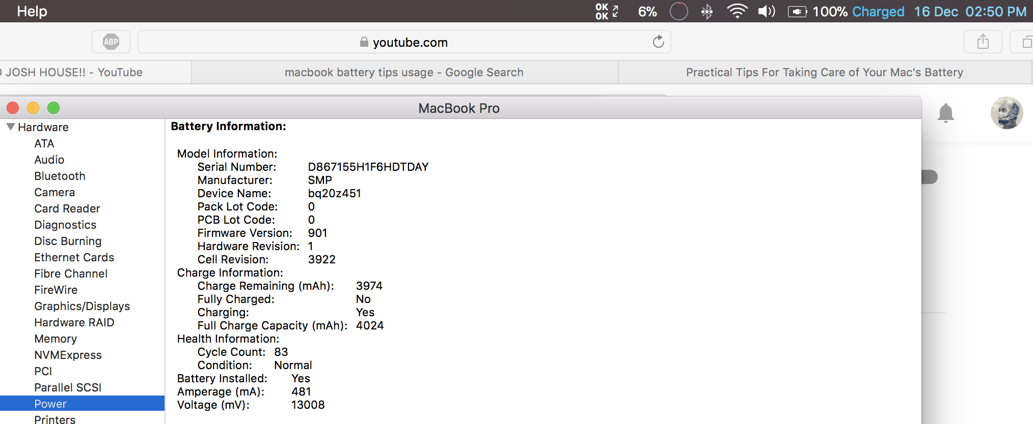

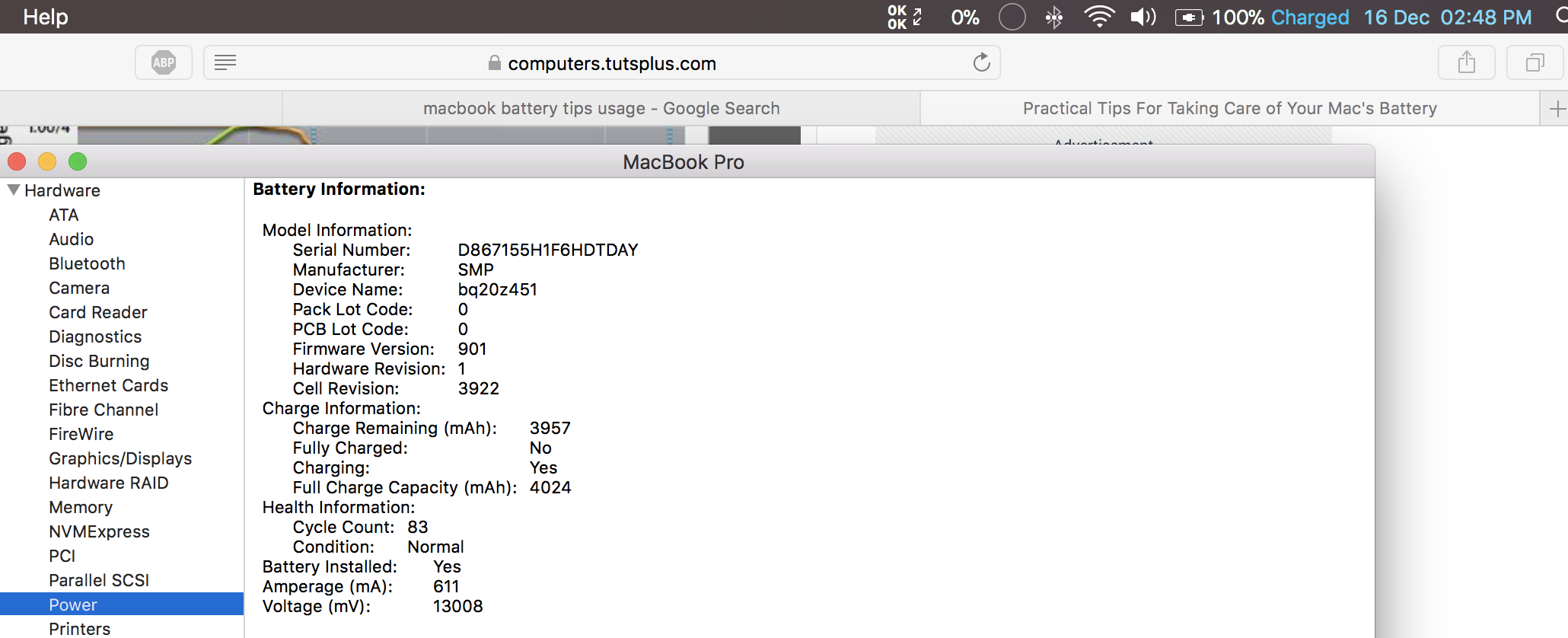

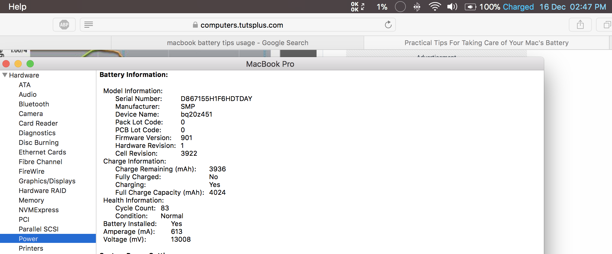

[doublepost=1513417002][/doublepost]Hah.. found something interesting that I didn't know about. Now I see even though the menubar shows 100%, it's not actually 'fully charged'. Also I can see that the voltage increases very very slightly but the amperage drops quite a bit.
