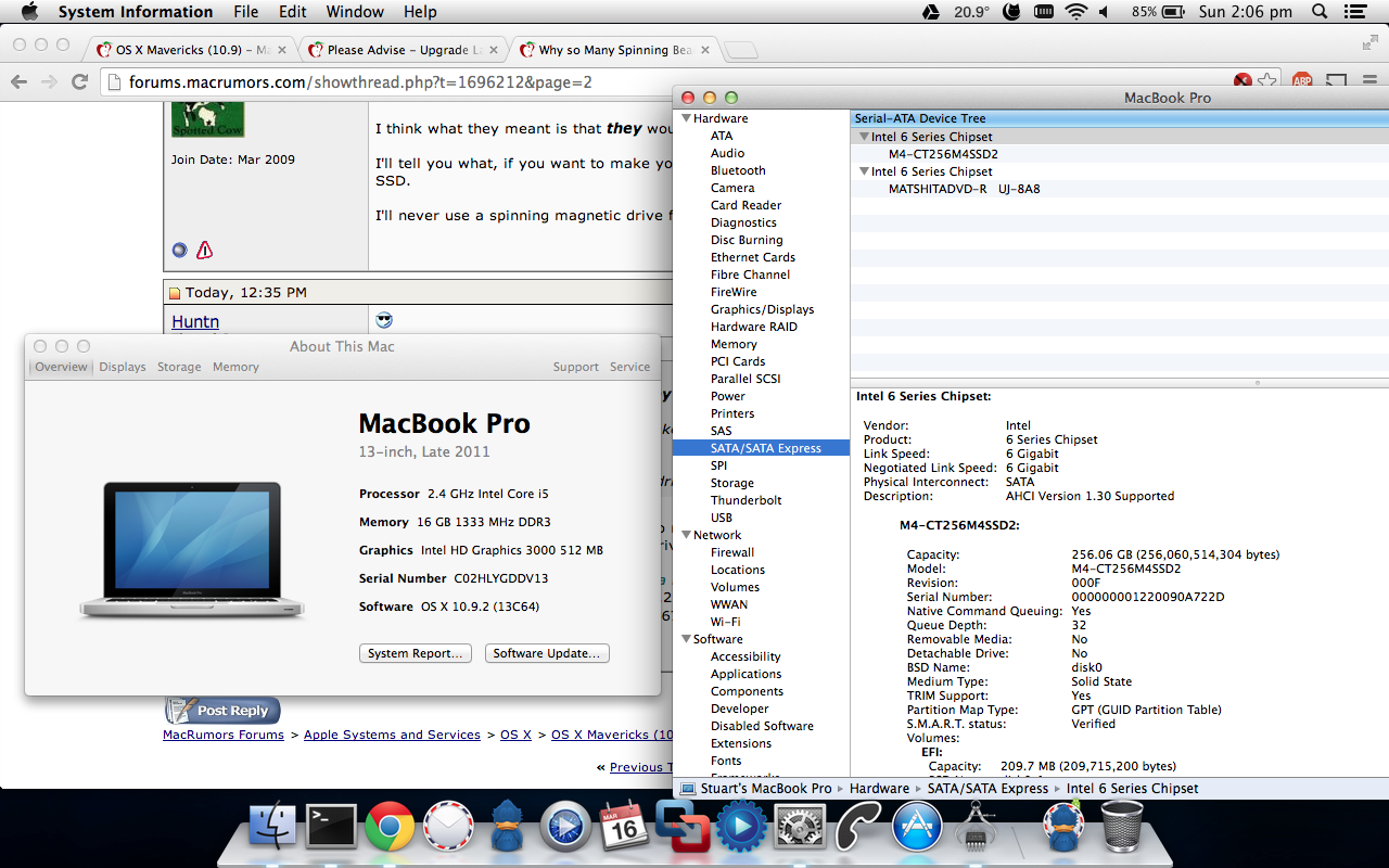

I installed an ssd 128gb , with mavericks I only get a spinning ball when the external drives wake up

Interesting. They gave me some techno mumbo jumbo about specs and compatibility and said it was not possible. Anyone with a 2011 MBP stick a SSD drive into it?
Yep, and it is dead easy to do and makes the system very responsive!
I've done it on a 2008 MBP and on my mid-2013 MBP.
In fact, on my 2013 MBP, I was so happy with doing it on my 2008 model that I opened up the box, booted it, made sure it worked, and immediately swapped out the HDD for an SDD.
It's *that* *good*.
It simply transforms your Mac into a responsive beast.
