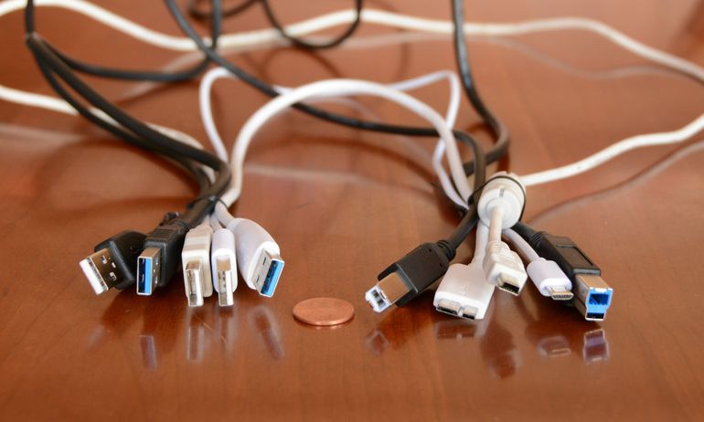

Is anybody using a USB-A to USB-A connection anywhere? Or is it a USB-A to any number of connection types?
That's irrelevant, because you're not - have never been - supposed to use a USB A-to-A connection.
The original architecture is master-slave, masters - USB computers & hubs - had Type A sockets and slaves - peripherals - had Type B sockets.
Cables were always supposed to be A-to-B. A-to-A cables certainly exist, but I'm not sure they ever had an officially-approved use. I have one no-name drive enclosure with a USB3-A "input" that came with an A-to-A cable but I suspect that breaks the rules.
Mini- and Micro- USB connectors also came in A- and B- varieties, but most of the ones in the wild are the B-version. I don't think I've ever seen a Mini-A or Micro-A connector in real life.
Phones started as purely peripheral devices - so they have type-B slave connectors and need dongles to act as hosts. USB on-the-go - and Mini/Micro-AB connectors are a later addition to allow phones to act as both master and slave.
USB-C has done away with the physical distinction between A and B connectors, and left the electronics to sort it out - which is probably progress, but hardly an argument for dashing out and upgrading.

That's very uncommon. Most USB 3 hard drives use USB Micro-B 3.x cables (like this one), which can be replaced by USB-C versions if it doesn't come with it.
While I agree with you, I did purchase a USB 3.0 enclosure that was USB-A to USB-A, and use it with my Xbox One. I still find it weird.
