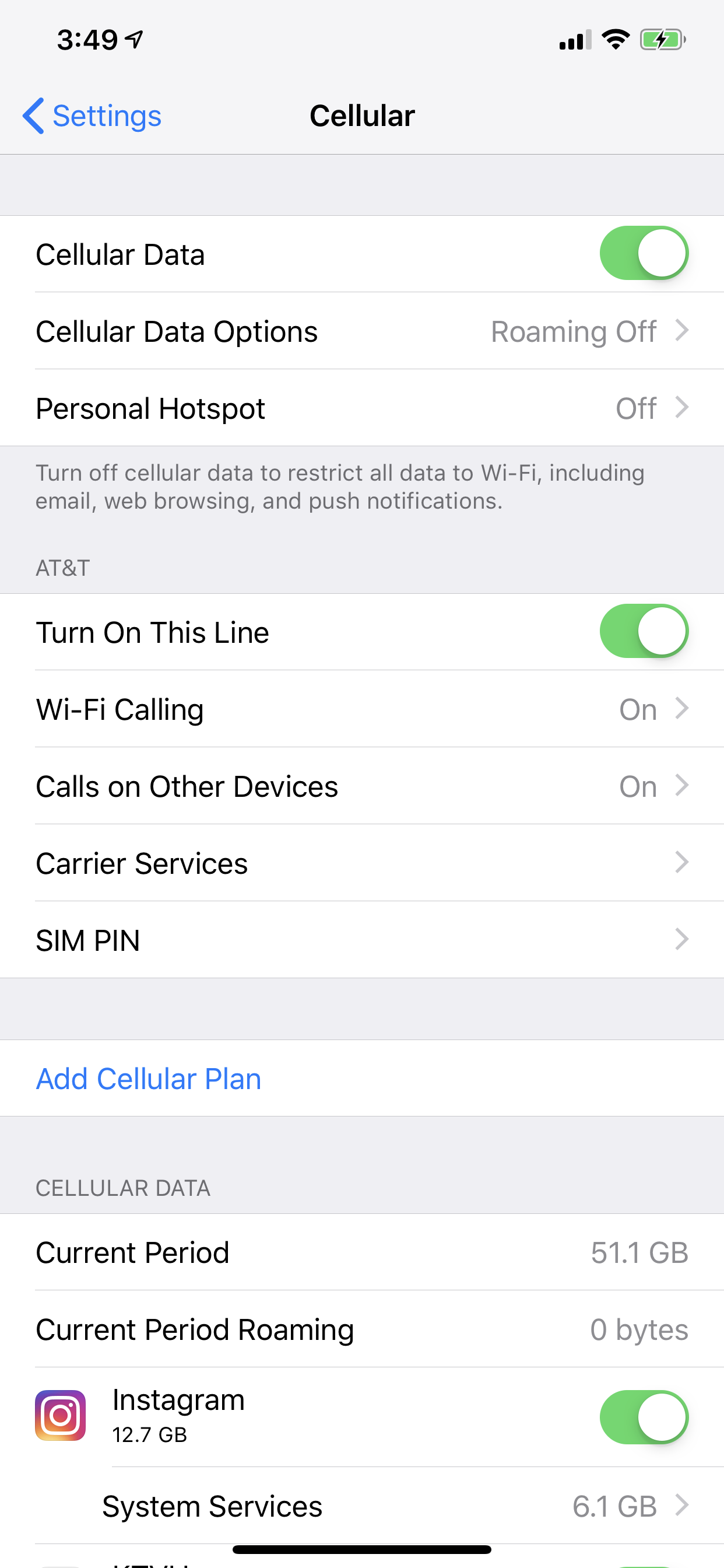

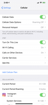

Pardon the newbie question, but what is wifi calling and how do you set it up on a iPhone X?
WiFi calling is usually for people who have bad service wherever they are. So instead of going off your provider for service for calls it uses your WiFi signal. Just go into settings > cellular > WiFi calling and turn it on and set it up.
Thanks for the quick response. I checked the settings you gave me and I don't have one called WiFi Calling. I have one called wifi assist. Is that the one your referring to or is the WiFi calling carrier specific?
WiFi calling is more carrier related and would be under those settings, if available (might need to be enabled on the carrier side and/or might need a particular plan or feature on account to be available).
Some recent discussion relating to it all at https://forums.macrumors.com/threads/has-anyone-else-disabled-wifi-calling.2145837/.
No there should be a tab called WiFi calling. Not sure if your carrier has it or not.

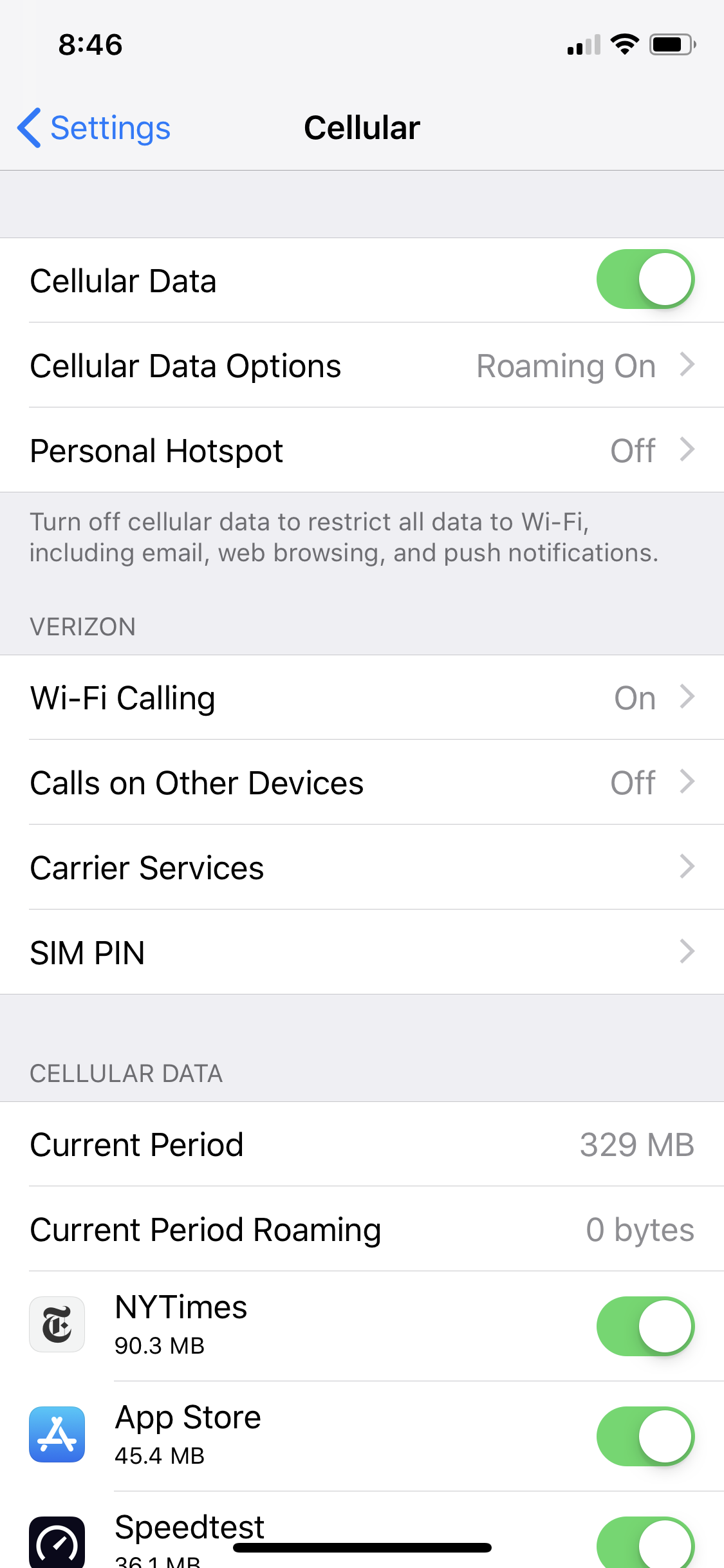

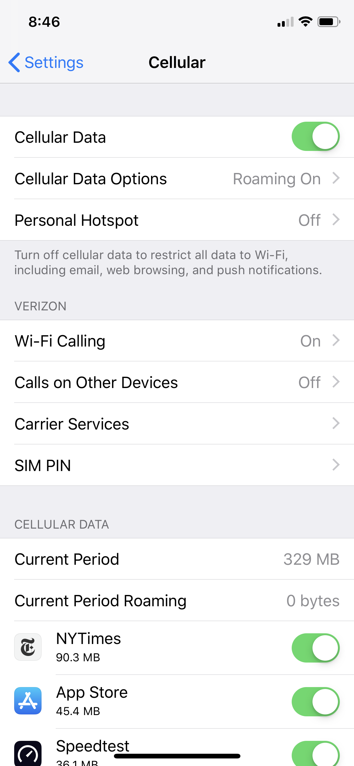

I use WiFi calling a lot, and it’s always worked well for me. Cellular coverage is spotty at home and at work. I used to use a Verizon network extender at home. Now I just use WiFi calling. At home or work, I usually keep I my phone in airplane mode which saves battery since the phone isn’t always hunting for a cellular signal. Calls on WiFi calling are crystal clear and 100% reliable for me, whether incoming calls or calls I make to others.
WiFi calling is carrier-specific. I’m on Verizon. It might work differently on other carriers, or not at all.
Good luck.
