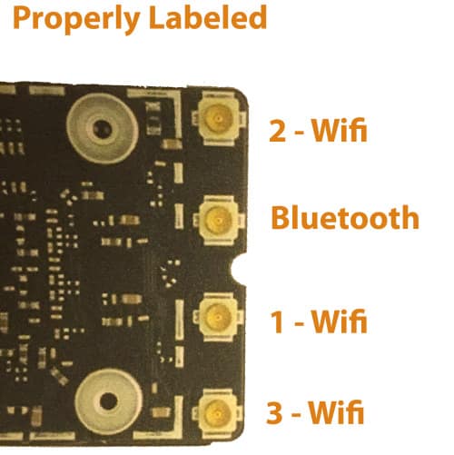

Where do each of the 4 antennas go on the BCM94360CD wifi/BT card for a MacPro 3,1 ?
Is it 100% confirmed that the correct Bluetooth antenna wire is not the BT U.FL plug ? Is there a good thread detailing this confusion in detail. Which #plug do you guys use for the BT ? Does anyone have first hand experience playing with different combinations just to confirm if there is a issue with labeling from the factory? Was the labeling ever corrected at some point making it HARD to determine which is the correct plug to use? Can we track down the correct antenna by tracing the coax back if there is any question at all about correctness of the antenna being used?
What is the extra (not used) antenna on the MacPro 3,1 ? A 3rd wifi antenna ?
What are each of the U.FL plugs on the BCM94360CD allocated for just for cross reference? A0,A1,A2,A3

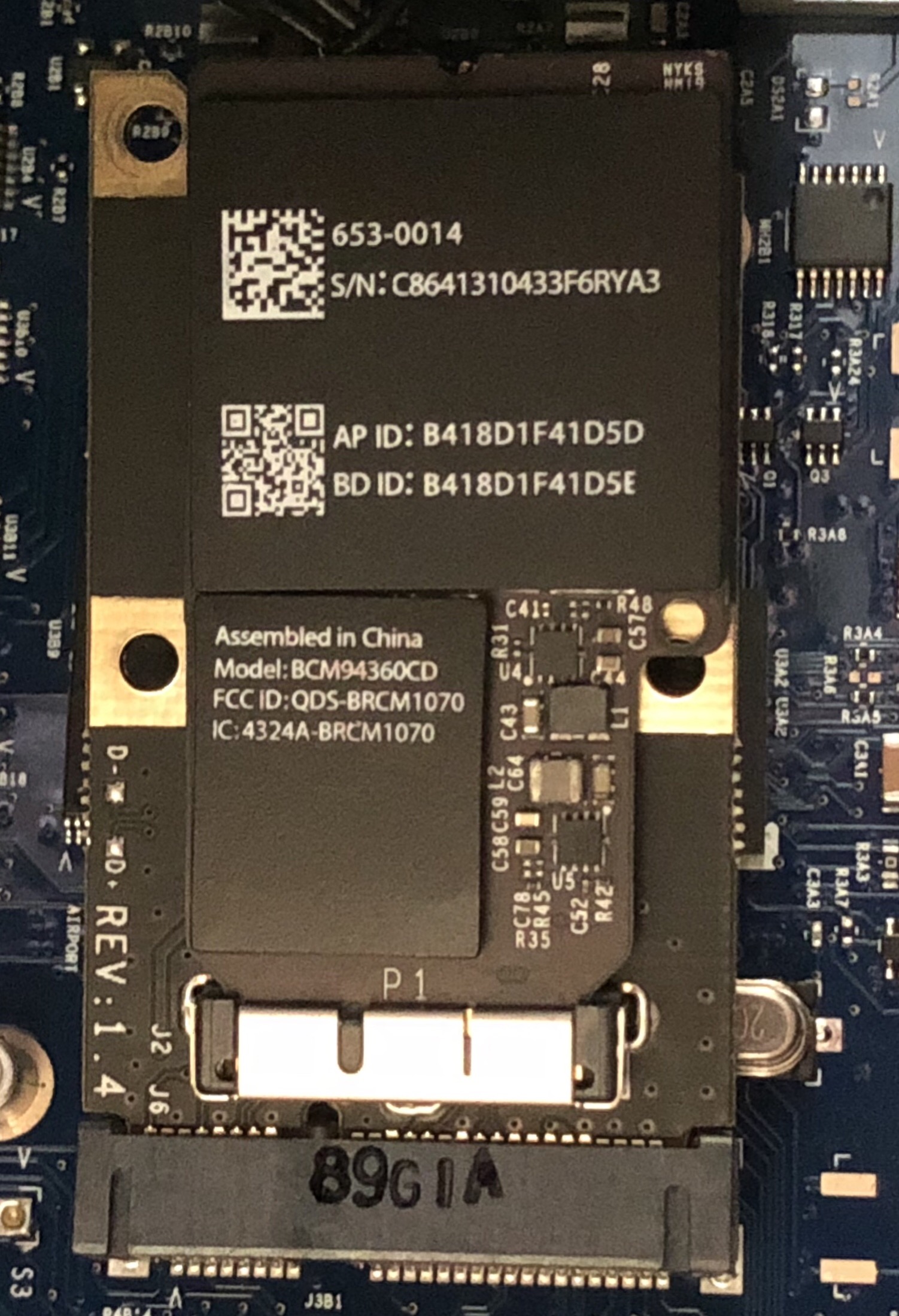

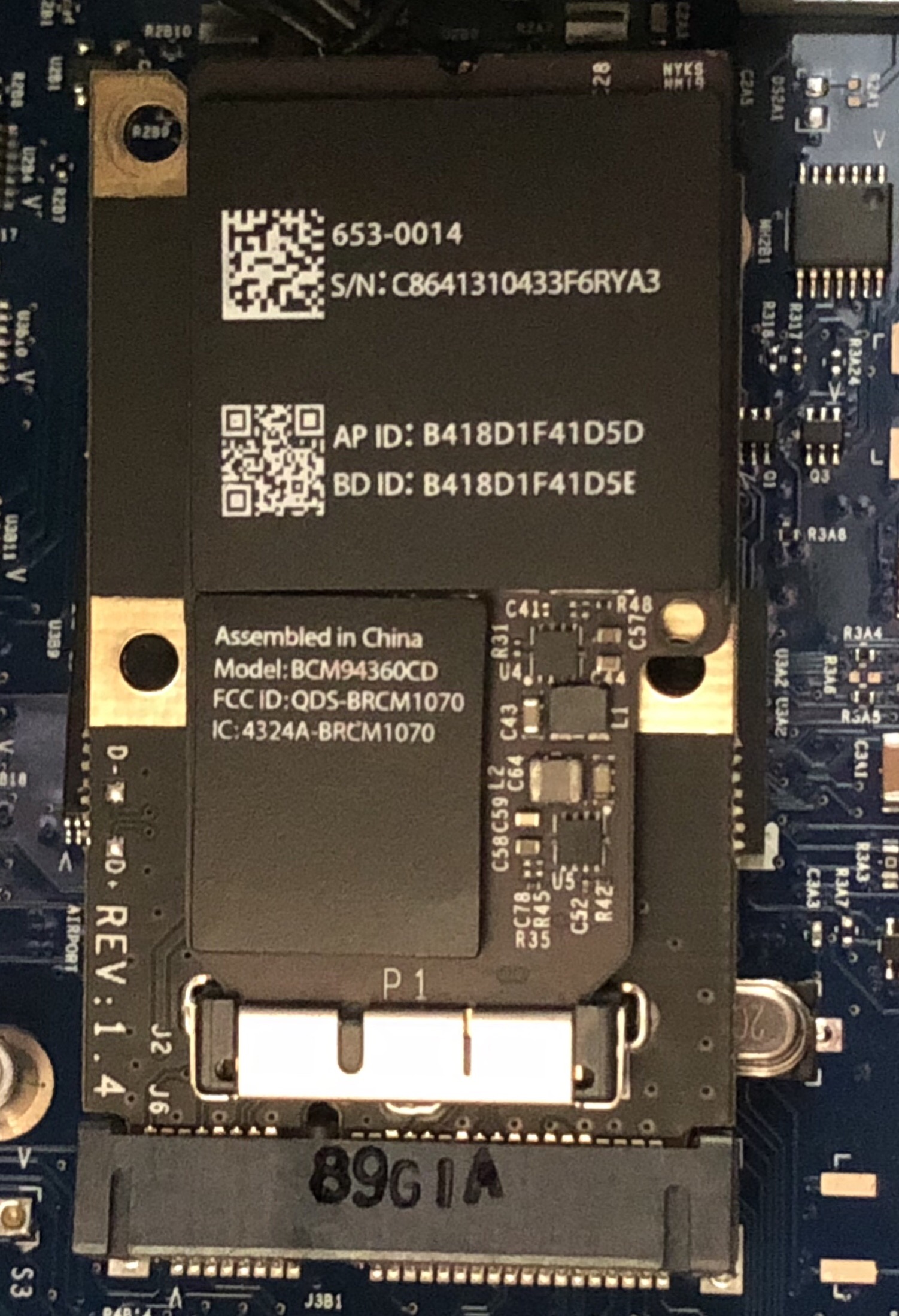

I now have reseated the antenna cables according to the attached image and replugged the BCM94360CD into the adapter (read somewhere that this could help).
Didn´t help either.
I am not sure if it has something to do with the settings I have chosen in the patcher tool from "dosdude1".
The first time, I have marked the model "MacPro 3.1" with the "Broadcom wifi card" option checked.
I reinstalled the whole OS and patched again, to get a clean install and left the "Broadcom wifi card" option "unchecked" this time. As the Model mentioned in the patcher tool is not the BCM94360CD.
Wifi and bluetooth work. The issue that the Mac won't boot with the card plugged in, is the same as before.

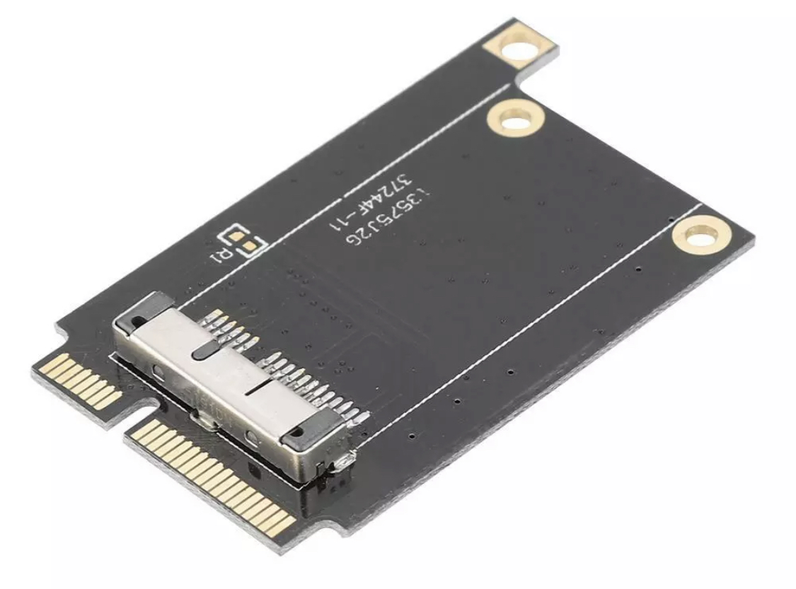

I have a different Adapter and card. I've uploaded two pictures. The second picture shows both plugged in the Mac Pro 3,1 Mainboard. Right underneath the hdd2 Slot.
This is the description for the new Adapter I've ordered: "This adapter converts the BCM94360CD / BCM94331CD module to a PCI-E X1 (36Pin) interface." Hopefully this new one will work.

I'm waiting for the same adapter as yours(mini pci-e, to the original Wi-Fi place on the board). and will check with him. I hope the module itself is fine. just interesting, I saw a few messages that the wi-fi module does not work in the adapter in the “big” PСI-e slot (as in my photo).
