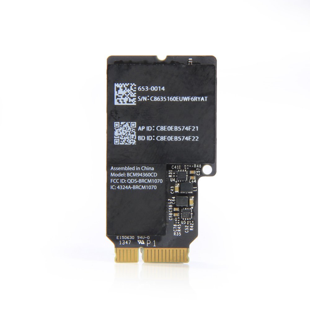

You need to buy the following Broadcom BCM94360CD (which is made for a newish iMac I believe) card, this is WiFi AC and bluetooth 4.0 combo card.

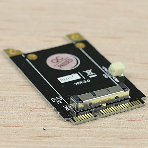

And an adapter to allow you to plug this into the mini-pcie slot on the motherboard of your MP3,1. Even if you had no WiFi when purchased new you will have this slot above the CPU heatsinks / below HDD bay 2 and there will be 4 antenna wires typically tucked in behind the top of the motherboard, 3 will be used for WiFi and 1 for BT, the original WiFi card only used 2 wires for WiFi and 1 for BT 2.0 as a separate card.
As the BCM94360CD is an original Apple part there is no need for driver (kext) changes it will work out of the box.
These are the two parts I bought back in October 2014 and have had zero issues with the card since being installed.
I updated to macOS Sierra as well using the unsupported thread. This card does give handoff and continuity functions in 10.10 / 10.11 in a 'supported' release, it still works in 10.12 as an 'unsupported' release.

You need this:
and this:
This is what it will look like when you've installed it.
The adapter + WiFi card and the 4 antenna wires connected to it.

Some of these have the USB jumper, what is this USB jumper used for exactly ?
Example the OSX WiFi one uses the 2 pin header
http://www.osxwifi.com/apple-broadcom-bcm94360cd-802-11-a-b-g-n-ac-bluetooth-4-0-with-adapter-for-imac-2007-and-imac-2008
Yet some of the generic ones seem to omit the USB jumper ? Why? Does this omission change anything ?

That's a 2008 iMac kit, not a 2008 Mac Pro kit, which I think is why you are seeing an inconsistency.
Also, it's not a jumper, it is a connector used for a cable to run across to the other side of the computer for USB on the 4,1 and 5,1. But the 1,1 through 3,1 don't need to connect anything to these pins since they already have USB in the slot itself. This is why some kits for the earlier Mac Pros don't have the connector at all.
