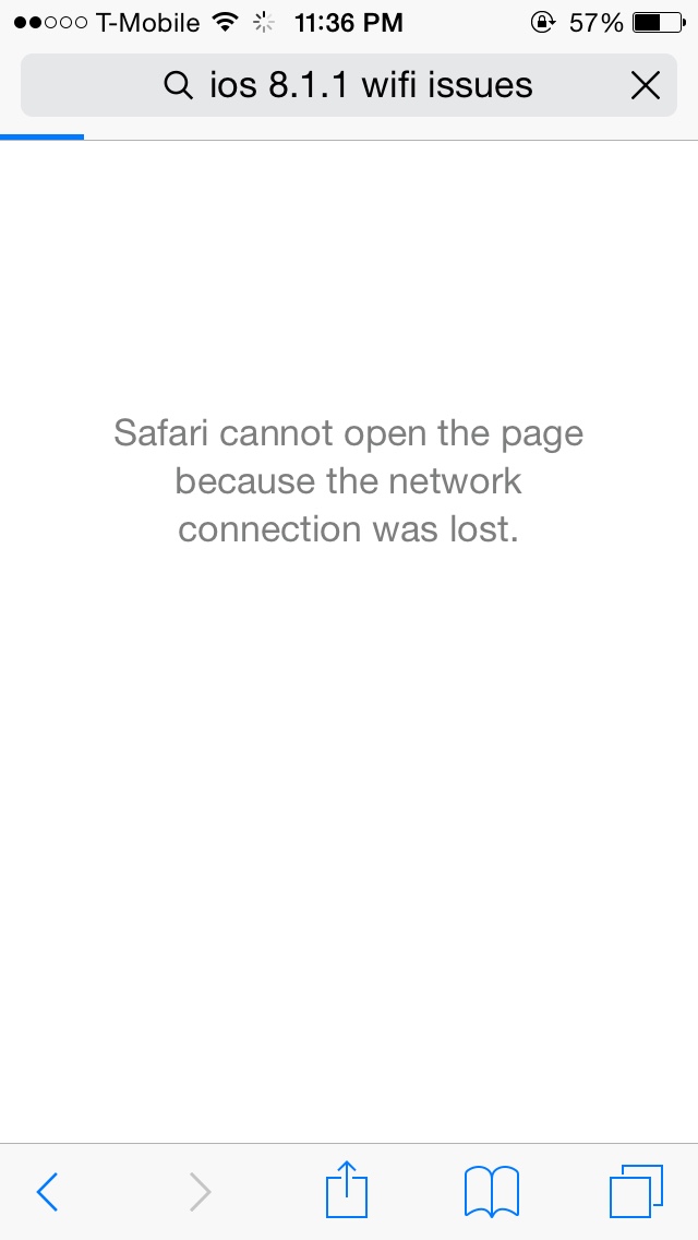

Getting real mad right now..... ImageUploadedByTapatalk1417073853.171480.jpg
