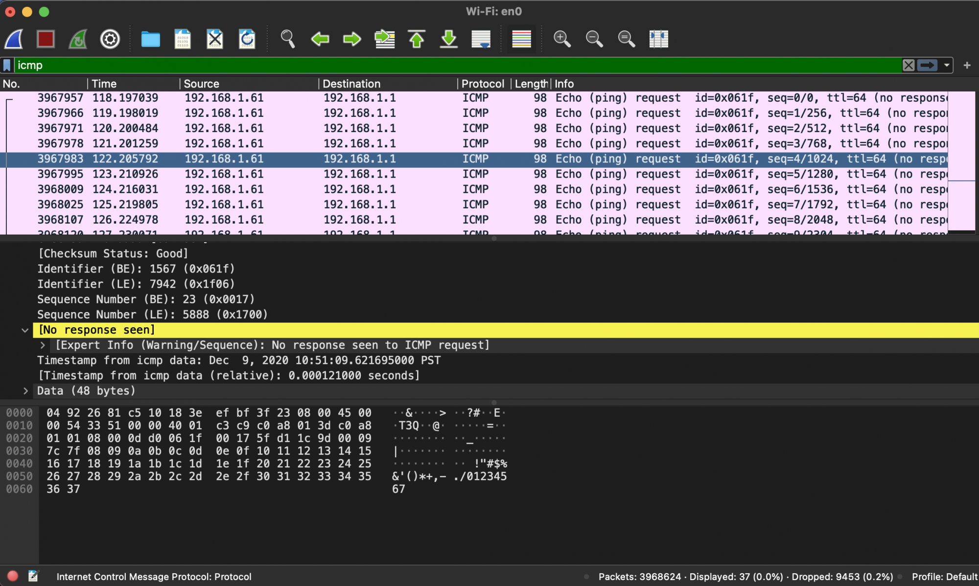

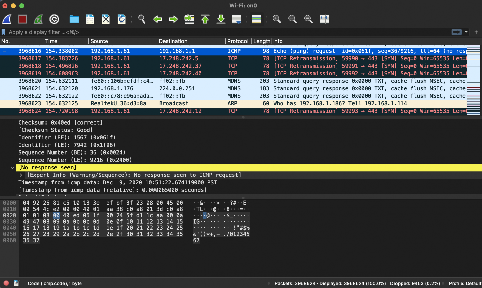

I ran Wireshark and was able to reproduce the disconnection issue by installing Xcode from the App Store. Downloads for awhile and then stops. It's weird, though -- traffic still seems to come in on the interface. Mostly mDNS broadcast requests from other devices on the network. I can see my outgoing ping requests to my router but they don't get a response. I also see a fair number of TCP retransmissions from the MBA to destination. Seems more like a driver bug than anything.
