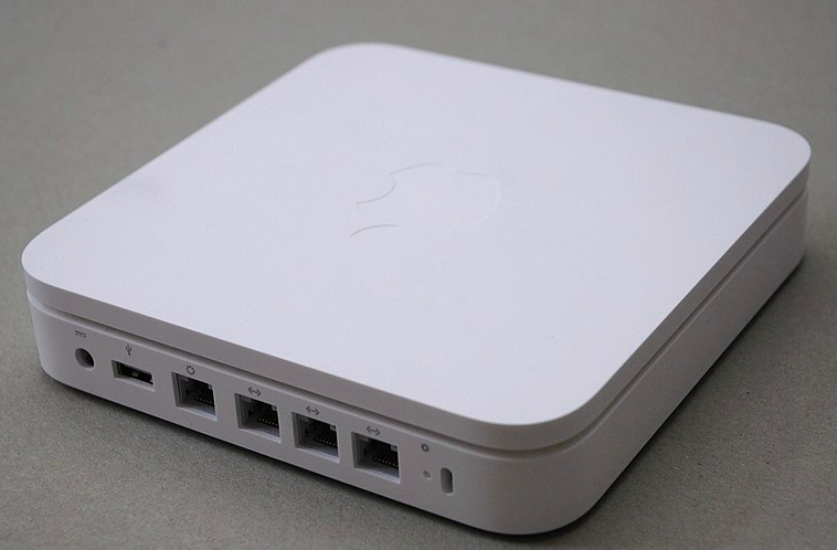

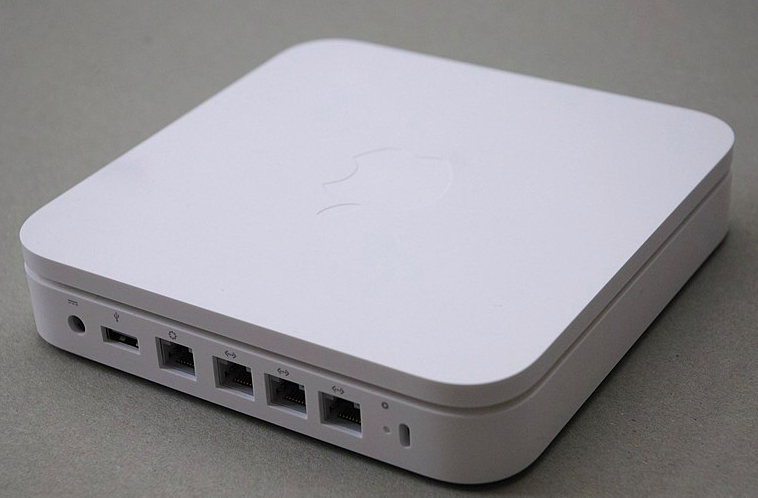

I use a 5th generation airport extreme.
https://support.apple.com/en-us/112440
Reactions: eyoungren

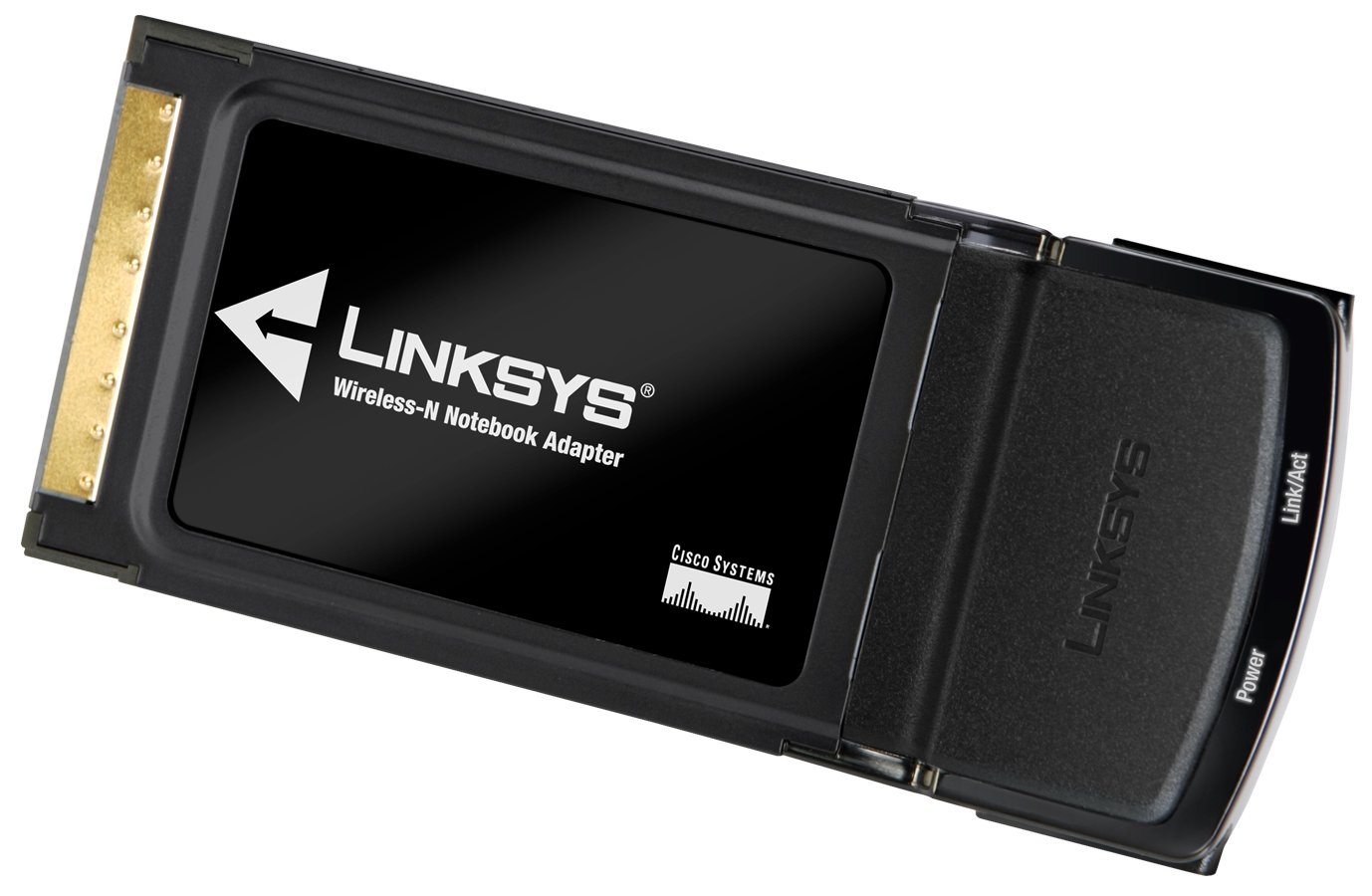

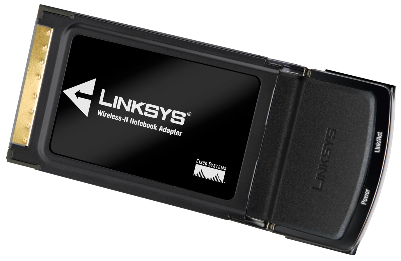

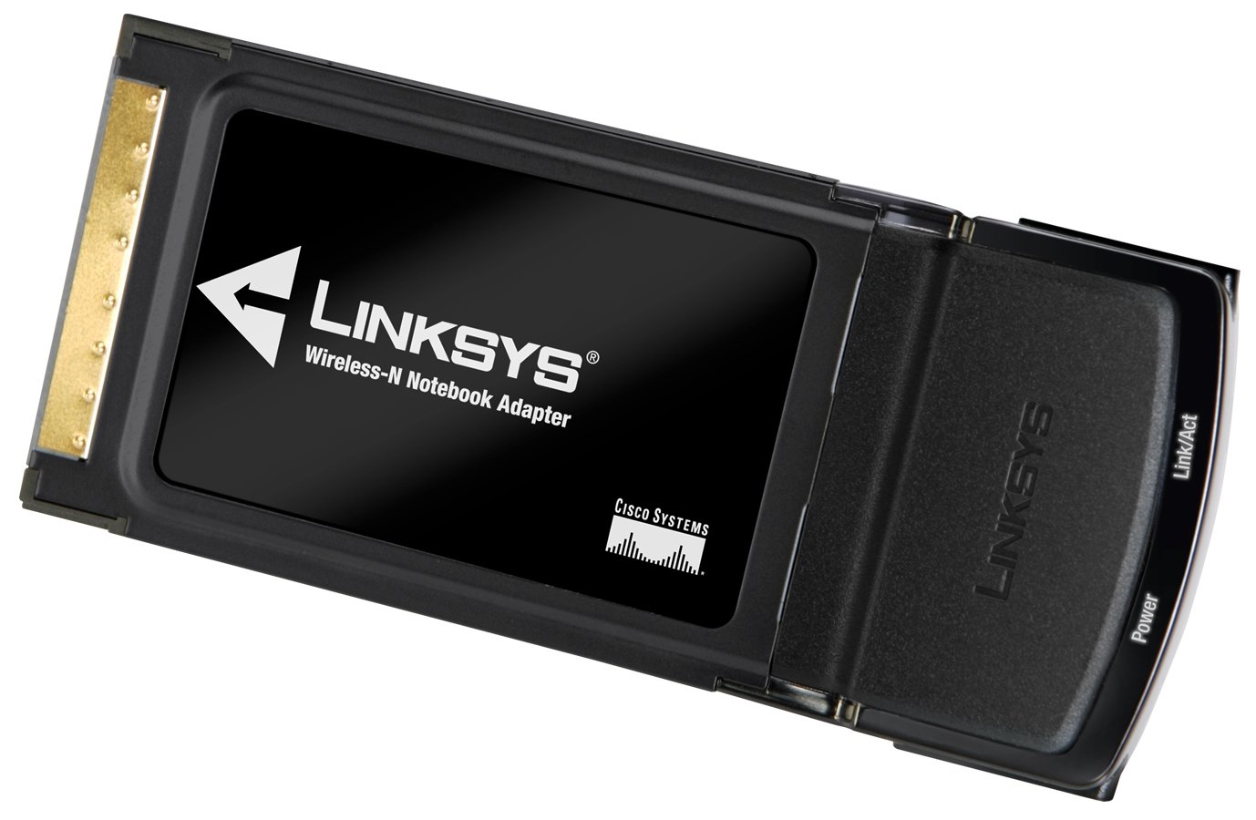

This one works. No driver installation required and full Airport support:

Thanks! I can’t quite make out the details of that card from the image? Would you be able to share them please? Would probably prefer the card one as there’s no driver hassle but failing that will snag one of those little USB dongles 🙂

I have three of these, one found for $25 at the Goodwill. I have it active, but not necessarily so my older Macs can use the network. Just to share the load around the house. With my primary router and this one we have six networks, 3 - 2.4Ghz (includes one guest network) and 3 - 5Ghz.
The other two AEs were included in a $60 purchase of two Mac Minis from a user here. I got those about two years ago or so and have yet to turn them on. I don't have any reason to yet.
Interesting, just it need drivers? Or will it work like an airport card? Thanks
Plug and play. The system will see it and control it just like a normal Airport card, i.e., from the menubar. There was a thread in here on this somewhere and I didn't see it so asked about a card that could access 5GHz WiFi. I was directed to that thread, which had that card.

Watch out when using the 600N. From my experience, it has only worked in Leopard and modern systems (Linux) and is completely nonfunctional in Tiger and earlier. I pulled it from the Companion because it's Tiger-primary.
(It may just need a kext but I haven't been able to find one.)
These are so cheap nowadays. Last time I checked on ebay these were like $5-10 + shipping so folks really just about giving them away. I picked mine up years ago in a $10 tech corner grab bag from a local thrift. They are handy for legacy networks as theyre easy to stand up, they're era correct & native and include that USB2 port for NAS. That is subsequently where I keep all of my own retro win/linux/mac files hosted on that network.
