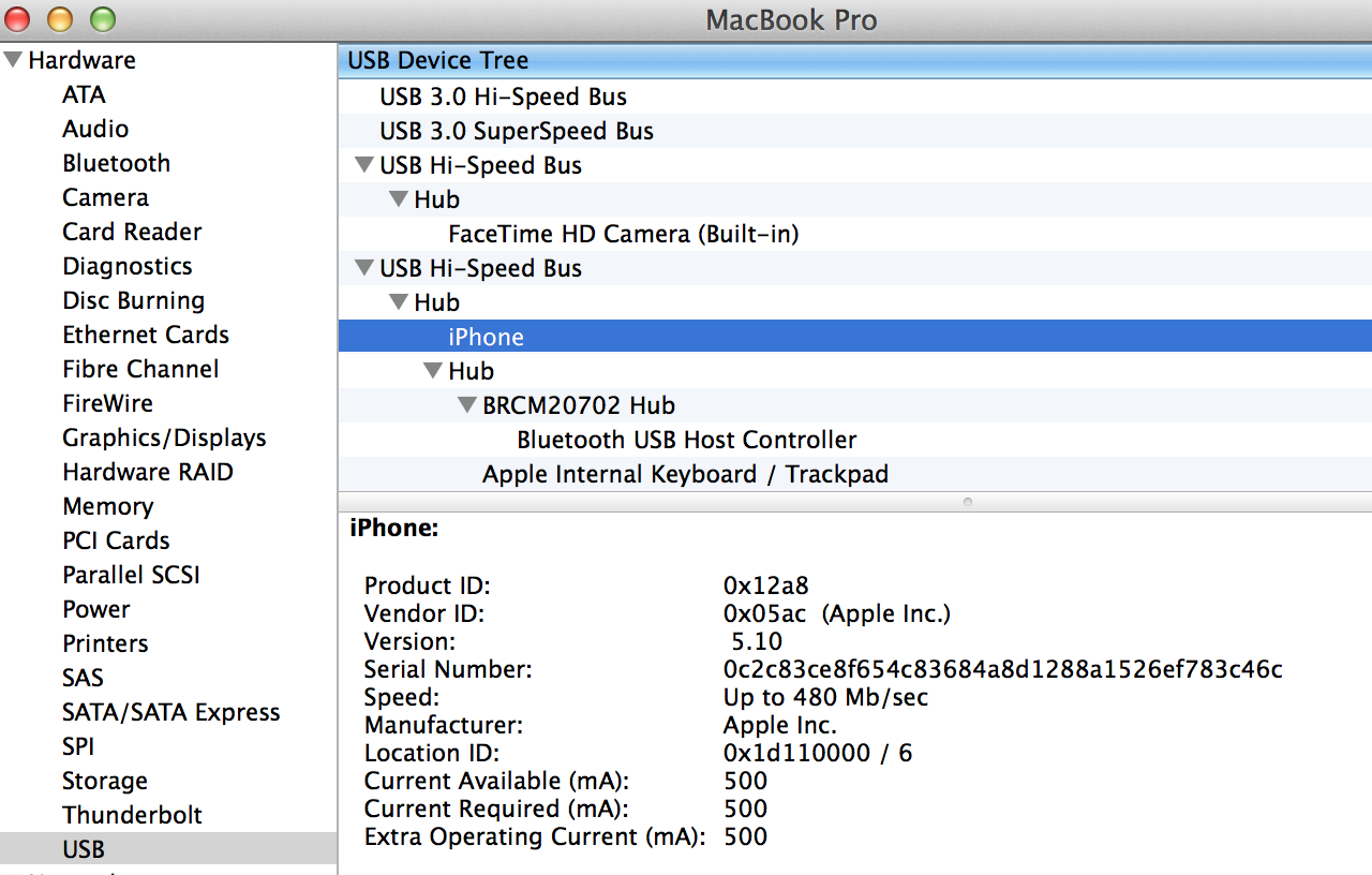

iPhone plugged into a Macbook Pro. 500mA (standard USB max) + 500mA (extra) = 1000mA
1000mA * 5V (standard USB voltage) = 5 watts

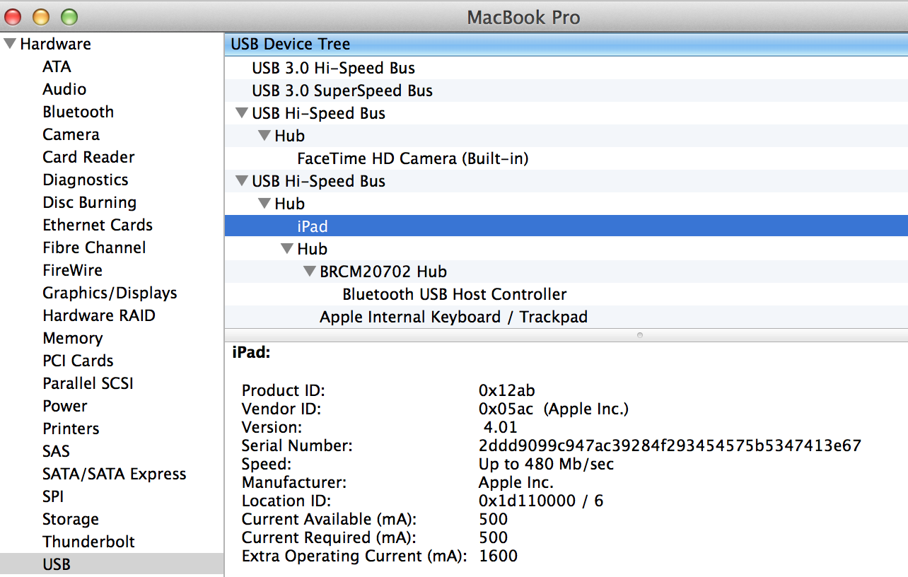

iPad plugged into the Macbook Pro. 500mA (standard) + 1600mA (extra) = 2100mA
2100mA * 5V = 10.5 watts, maybe the iPad can take more but the Macbook can't provide it. But this shows that the Macbook is capable of providing extra current but the iPhone (5) doesn't want it.

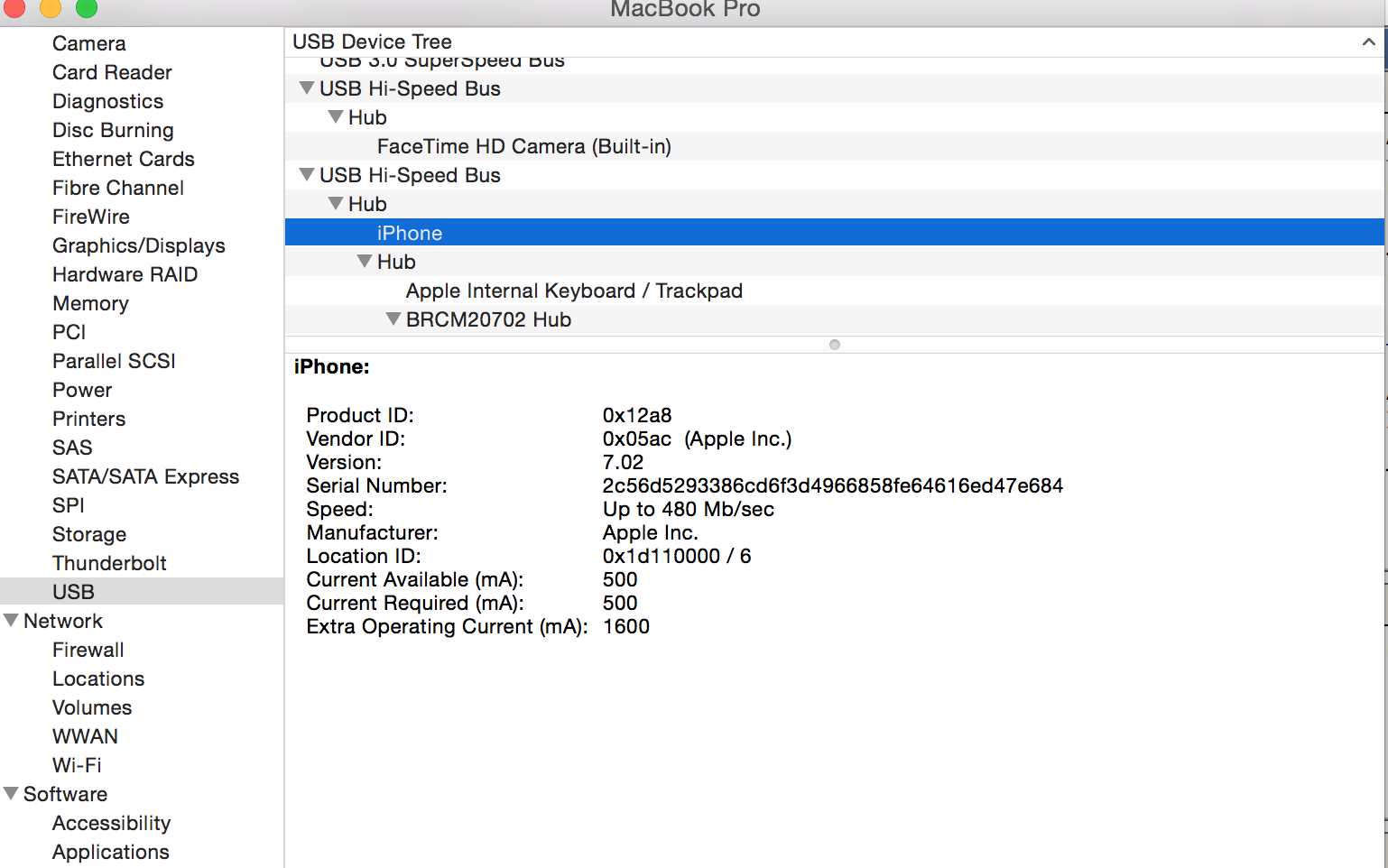

Updated with iPhone 6+ screenshot (courtesy of ToroidalZeus) - confirmation that iPhone 6(+) charges faster from Macbook or iPad charger versus 5W wall charger!
