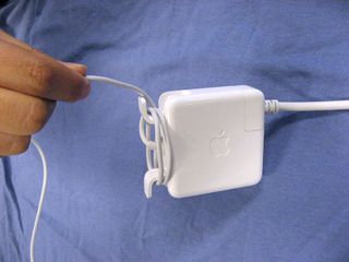

The reason this usually happens is that the cord is put into a bag or somehow the cord just coming out of the converter is at a sharp angle causing the cord to bend more than it was designed to at the joint, causing the fraying.
That's what the little wing things that pop out on the converter are for. Pull those out and wrap the cord around it being sure that you first let the cord go straight for the first inch. I had no idea until an Apple Genius showed me.
It's still a poorly designed converter. You shouldn't be forced to wrap the cord around those wing things so that the converter doesn't break.
Like this:
Why shouldn't you be "forced" to wrap the cord around those wings... they were included with the cost of the adapter, not like you have to buy them extra. I have always wrapped mine on the pull out prongs with a 1" loose loop first... just kinda common sense seeing the stress it puts on the cables without first making the loop. >.>
