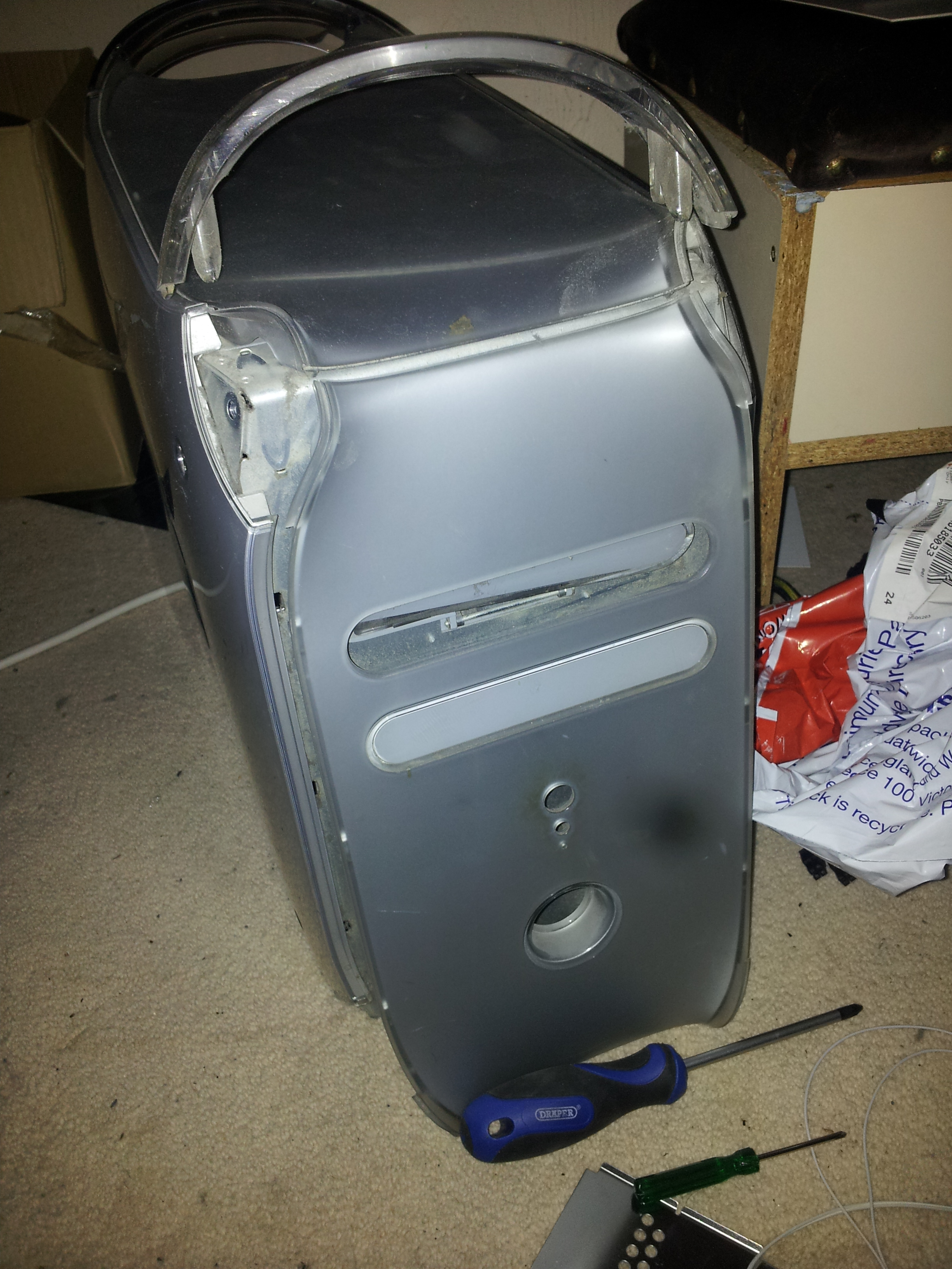

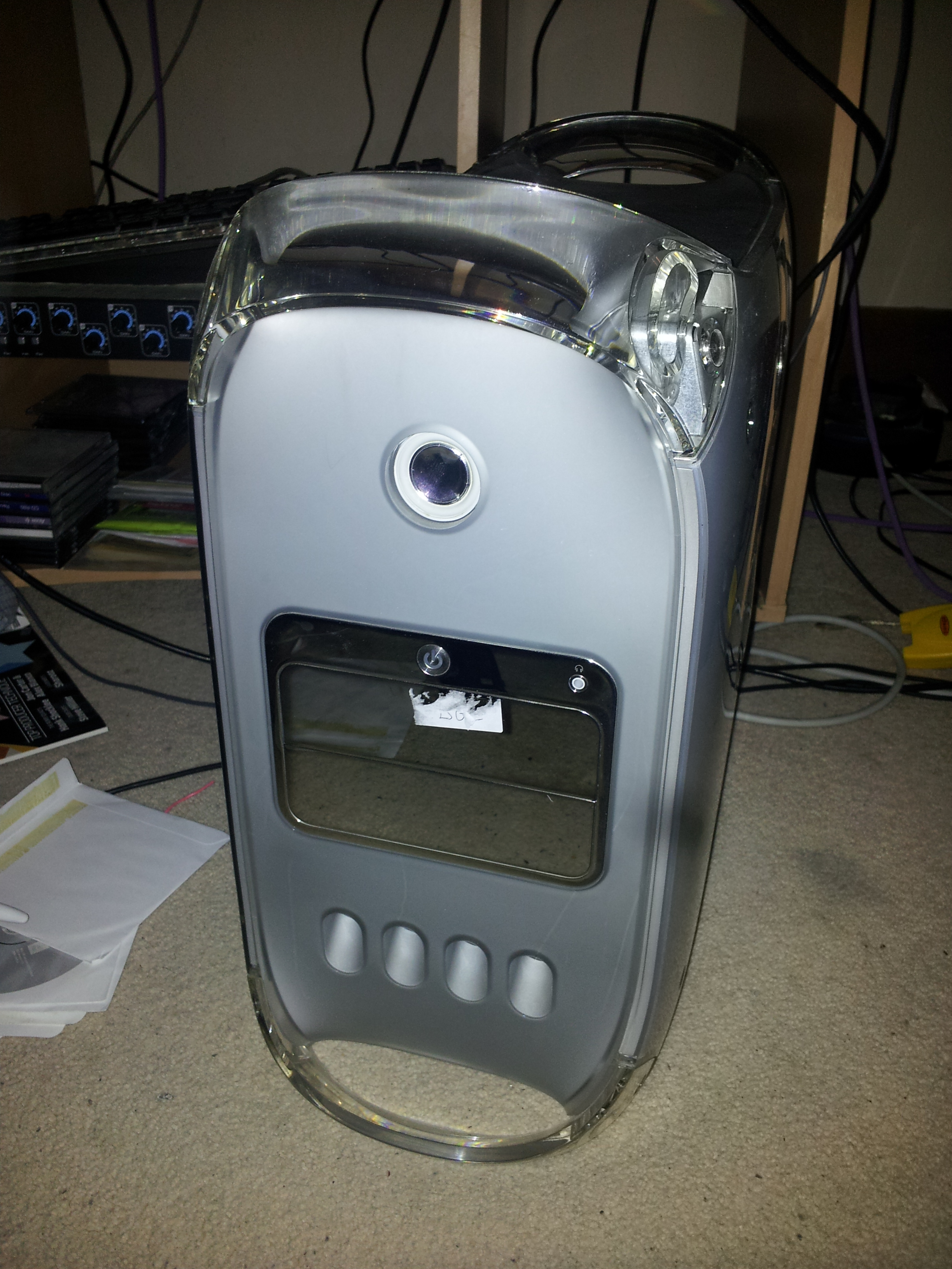

Cheers for the recommendation there. I admit that these old Macs are hardly my specialist area, so no doubt I'll have some more uninformed questions to ask!
Speaking of which, seeing as the model I linked to clearly won't run OS9.2.1, I'm a little baffled, as the G4 I once had (I'm trying to recreate an old setup) looked very similar indeed, as you'll see from the photo of the partially-disassembled original below. I imagine that Apple, in their infinite wisdom, released various differently-specced iterations in those cases, but which one could mine be, do you think?
The reason that particular Quicksilver will not run 9.2.1 is because it is known as a QS 2002 and came out after 9.2.2 was released. It also had some hardware enhancements not included in the retail 9.2.2 releases hence the machine specific disc. Plenty of other hardware that could boot OS9 also fell into this area of post 9.2.2 requirements: MDD Powermacs, eMacs, iMacs and TiBooks amongst them.
Earlier QS models were released with 9.2 and could in theory boot off retail 9.2.1 disks (I have only the 2002 models so cannot confirm). This page on Everymac has a list of all the Powermac G4 models released and the details on each model include the base OS released with each.

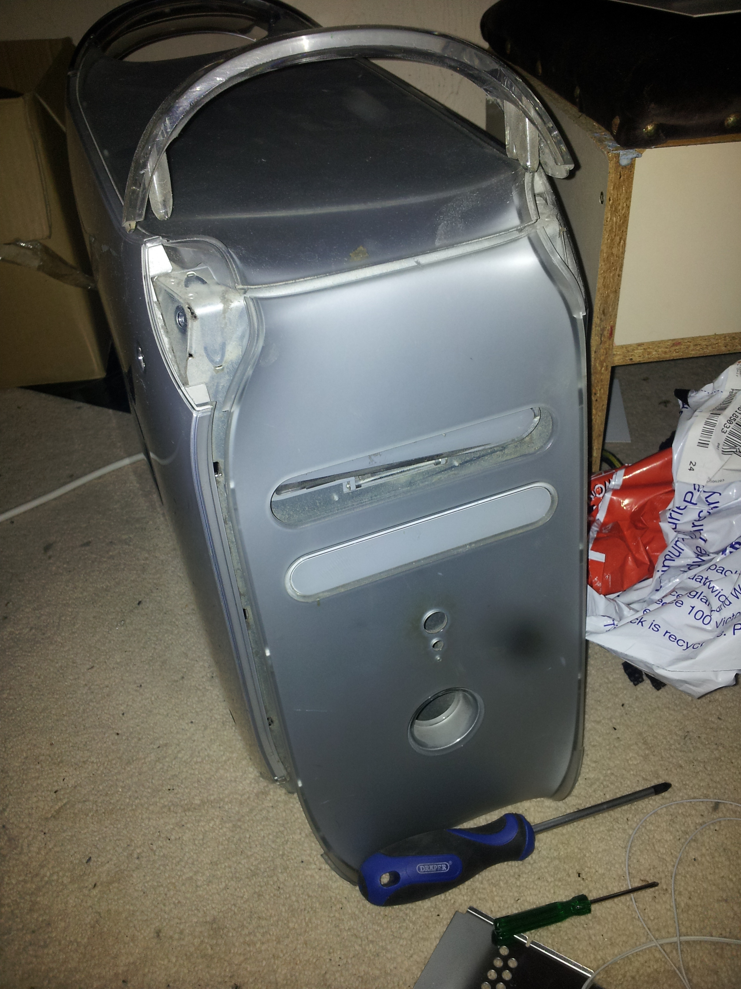

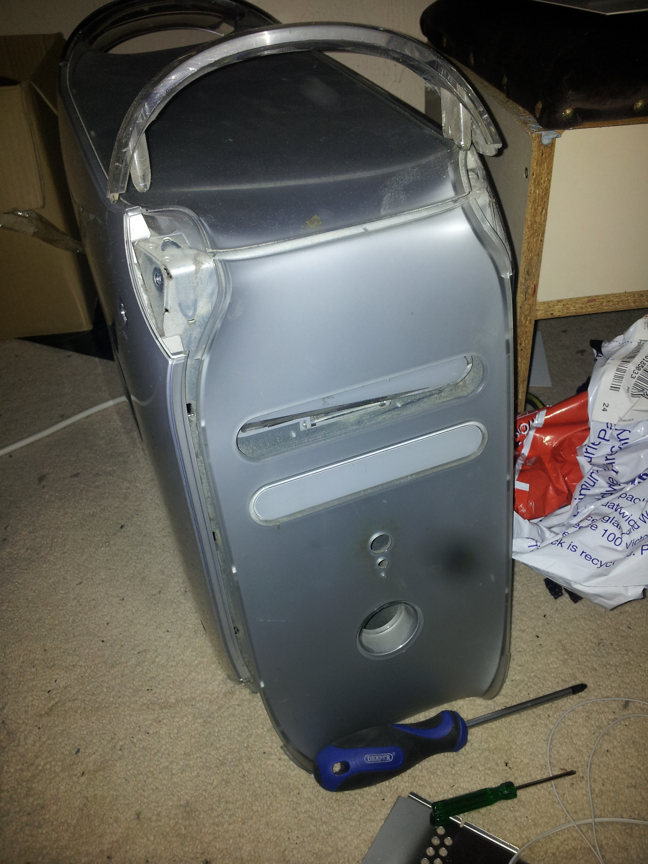

The first photo I've attached is of my (partially disassembled) original G4, which I think dates before the QS models to 2001 (a Digital Audio model, maybe?). I have all 5 software restore discs for it, plus OS 9.2.1 and OS 10.0.4

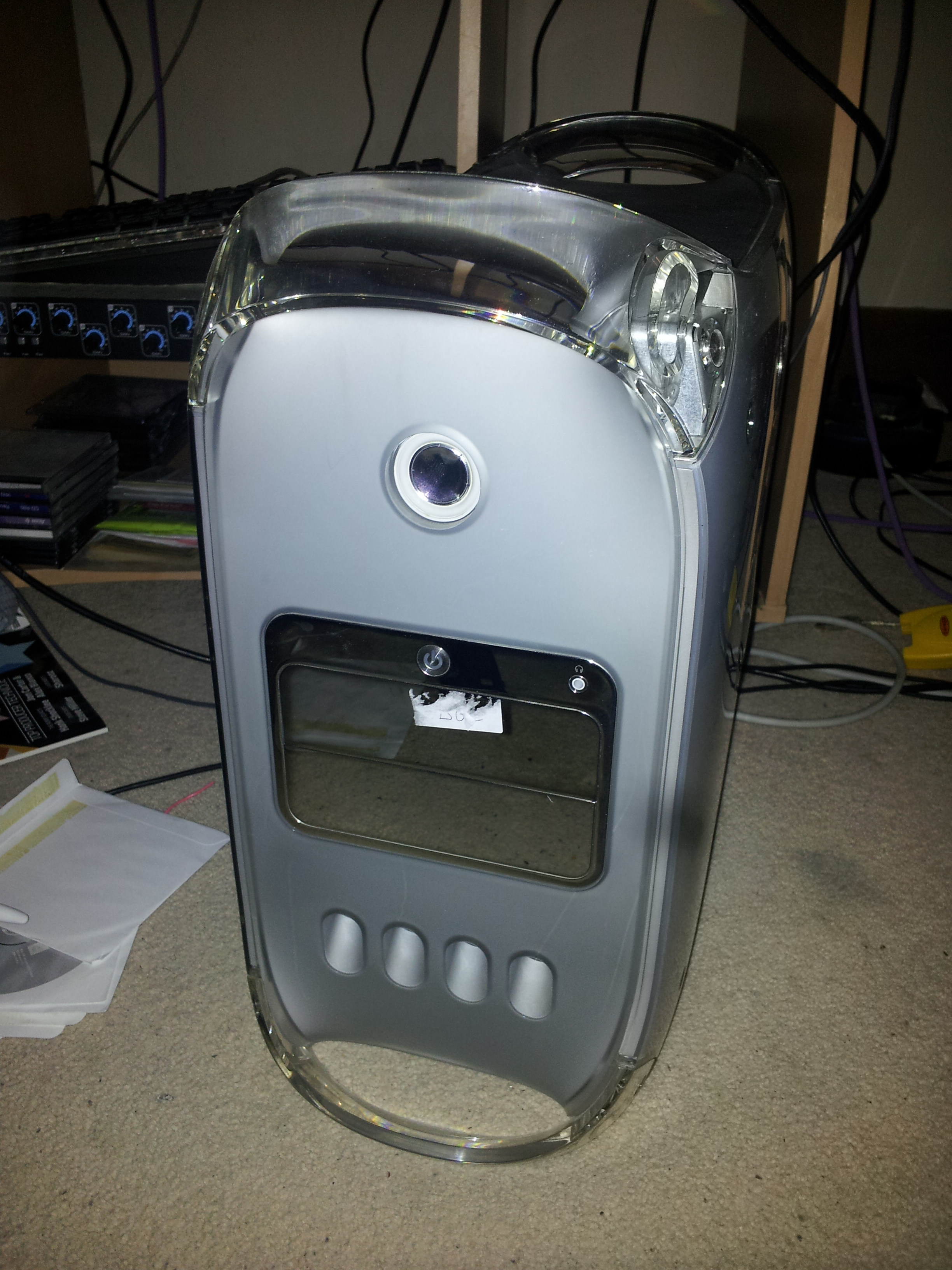

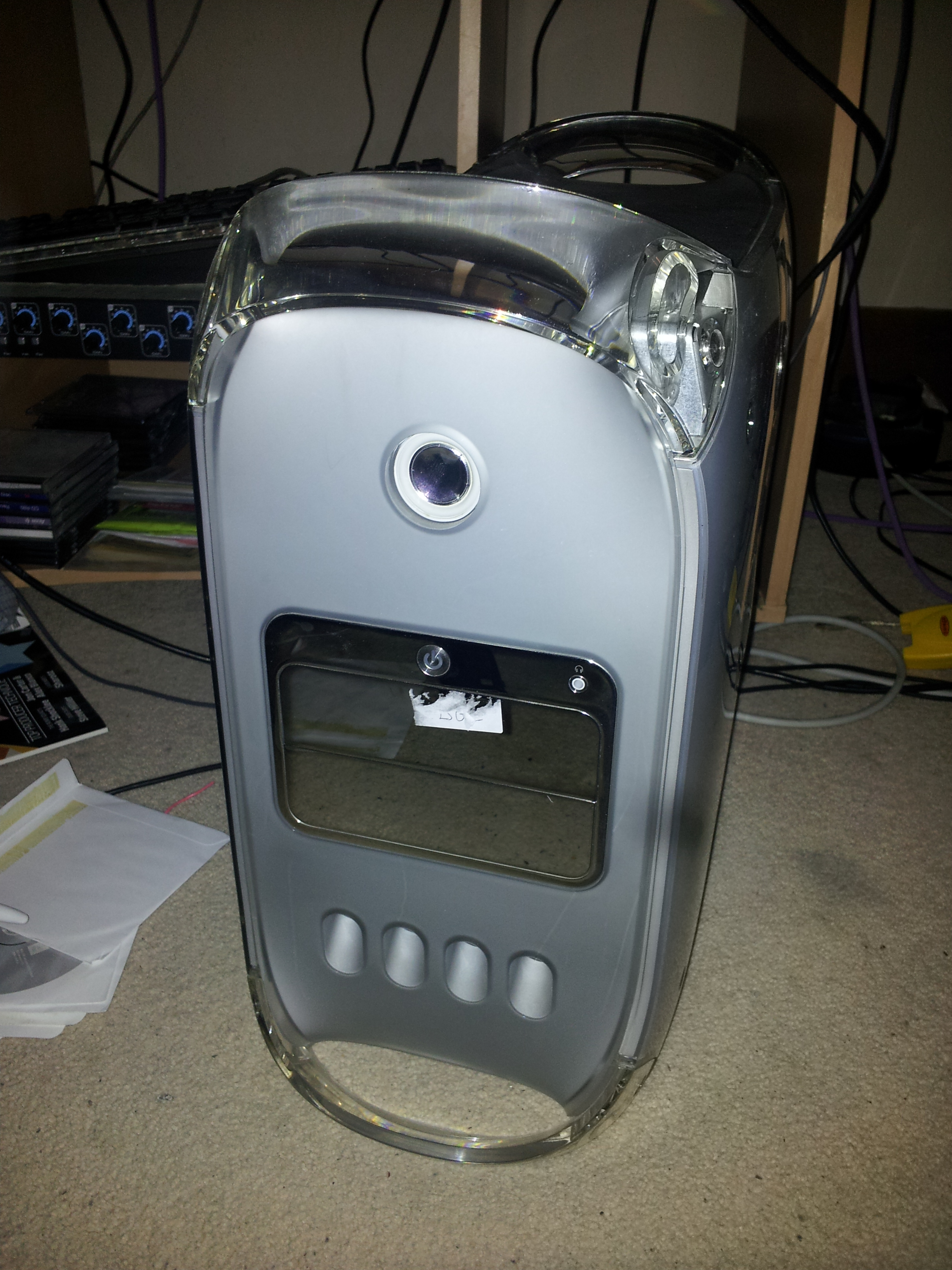

The second photo is the refurbished MDD, which I bought without understanding the complexities of the range of G4 models. I got no discs with this at all. It also came without an HD, but with everything else inside, including an optical drive.
Just to run down what I've tried so far; I took the HD from my original G4 and put it inside the MDD (I have all the data from that drive backed up in its entirety on an old outboard external HD), with the intention of wiping it, installing 9.2.1 on there and setting back up again. I found I was able to boot into OS9 using the software install disc, but could not get the installer to run (obviously). I couldn't even boot off the OSX disc, getting a 'the installer has unexpectedly quit (error 1)' message. I've also tried downloading an OS9.2.2 DMG and installing from that, but the MDD hasn't recognised either the boot disc I made, or the memory stick with it on.
The ebay link was to a machine which looked a lot like my original G4 and which I hoped would solve all my problems, but as far as OS 9.2.1 goes, it seems not. Logic Audio 4.8.1 (which is the application I need access to) may run under 9.2.2, but I have no discs for that, and the DMG download I haven't managed to make work with the MDD, as I mentioned.

OK.
What you have on the left is a Quicksilver. There were several iterations of this as you saw on the Everymac link I gave earlier in this thread. The final versions known as QS 2002 need custom OS9 disks. You can use any retail OSX disc post 10.1.5 to install OSX on any Quicksilver.
As for MDD, you will need to check Everymac for the exact model you have to see what version of OSX shipped with that. Any retail version of OSX higher than what shipped with yours will boot/install. It stands to reason that any version earlier will either not boot or fail to install as it will lack the necessary hardware drivers.
As Quicksilvers predate MDDs, using your previous HD in an MDD is unlikely to work unless you have already updated the OSX on it past the version that shipped with the MDD. Your QS version of OS9 might work in Classic mode but might possibly not boot. Even if it does boot, it may not recognise all the hardware.
