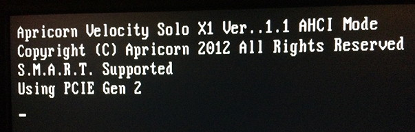

I picked up a Velocity Solo X1 dirt cheap and while it gives a nice boost in SSD speed, it seems incompatible with Windows 10 via Boot Camp. Velocity doesn't make any claims of compatibility with Windows 10, but I thought I'd try anyway. When I try to boot into Windows I get this command prompt...
There is no way out of this prompt, the keyboard is nonfunctioning at this stage.
I tried two possible work arounds,
- install the Windows drivers from the Velocity web site, but that produces a Windows version install error, although it does appear to complete the install
- remove the SSD from the card and install the card empty, to see if Windows would load drivers, but I can't get past the above command prompt
So I guess I'm asking (in my longwinded way), has anyone gotten a Velocity Solo x1, or X2, to work in Windows 10?

I also noticed that the PCI fan ramped up to 1800 rpm with the Solo X1 installed. A known bug with an easy fix.
I could downgrade to Win7, but I think I'm going to send the Velocity Solo back for a refund. It was very inexpensive, but I get tired of troubleshooting after a while. 😵

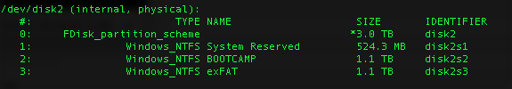

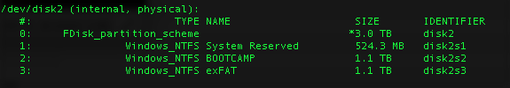

Interesting. I now have ”FDisk_partition_scheme” (i.e. MBR) for the working Windows 10 installation now in my MacPro5,1 that I did on a PC:
Since it seems to work fine now I think I'll just let it be. 🙂

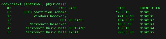

At the moment i'm in legacy installation (BIOS/CSM mode) and the partition of the HDD looks like this
Windows HDD partition in UEFI mode will look like this

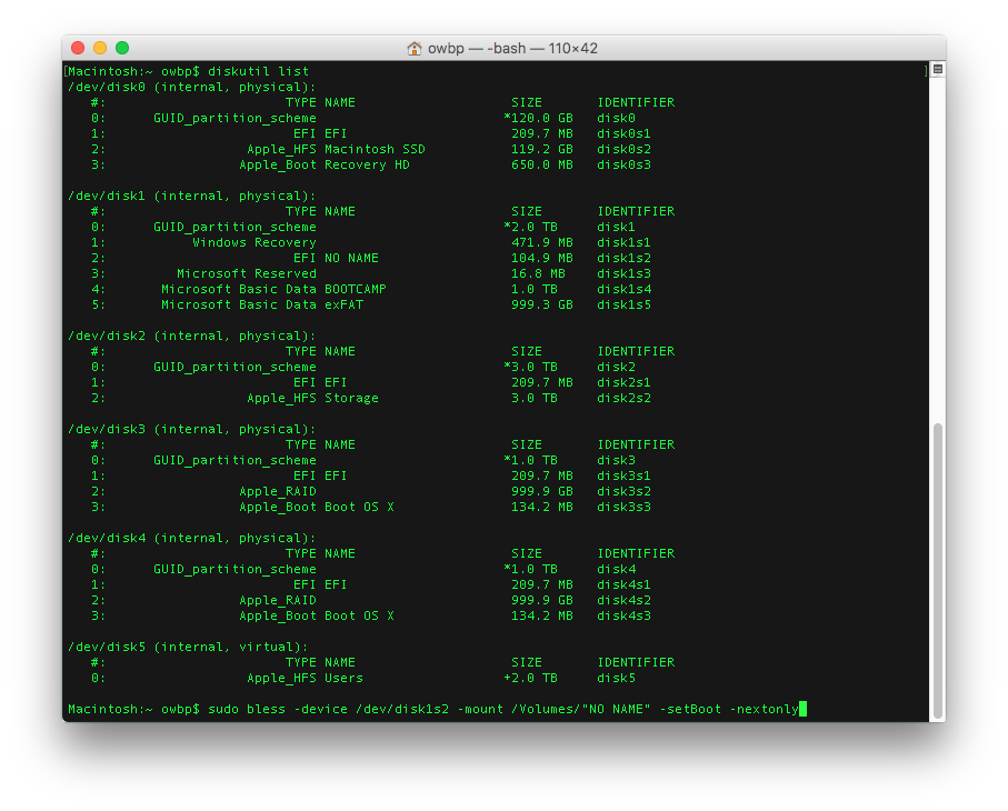

Aside from msinfo32, even before the installation you'll know if you booted into UEFI or Legacy just by looking at the setup resolution. Legacy will give you 800x600 (or something like that) while UEFI will give you native monitor resolution.
If you burn Windows ISO on DVD and hold Option at boot you'll see two new boot option:"Windows" and "EFI Boot".
"Windows" is legacy boot and that is where Bootcamp boots after restart on pre-UEFI Macs (5,1 cMP can boot UEFI Win).
"EFI Boot" is UEFI boot. I cannot boot into (U)EFI Boot with my flashed AMD R9 280X but can with original nVidia GT120.
I can also install Windows in UEFI mode, install drivers for the R9 280X, remove GT120 from Device Manager, remove it from the Mac and then boot with R9 280X, BUT ONLY if GPU's bios switch is in UEFI BIOS position (HD79xx have dual bios). I cannot boot that Windows installation with Mac EFI ROM.
Also, when you try to boot into Windows from Startup Disk, it will try to load boot file from disk1s4 (on second picture) but UEFI boot files are located in disk1s2 so you have to boot blessing that partition from the terminal (SIP disabled).
So before i get totally lost let me answer
if you’re actually booted via UEFI when in Windows 10 with your non-flashed GPUs inside?
Yes, i can boot into UEFI Windows with non flashed R9 280X, but only after installation of Windows and drivers is finished.
And, i can boot into it only by blessing EFI partition in Terminal.
GT120 EFI works and boots into Win UEFI but R9 280X EFI won't boot into it, it reports Error on the BSOD.
You would have the same result if you used Bootcamp for Windows installation.

Didn't use Bootcamp at all, and I'm in legacy boot:
/dev/disk2
#: TYPE NAME SIZE IDENTIFIER
0: FDisk_partition_scheme *256.1 GB disk2
1: Windows_NTFS Untitled 256.1 GB disk2s1
So far, it works well for me. I have sound, and it normally boots to OS X, but by holding alt/option key, I get a choice to boot OS X or Windows, and it boots very fast, maybe faster than booting to OS X... after holding alt/option and selecting Windows volume, that is.
