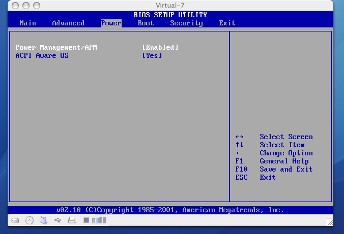

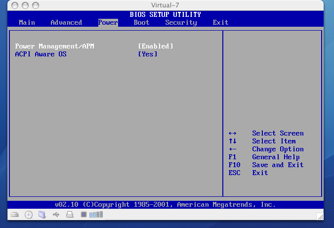

Windows 7 needs an ACPI enabled BIOS , this is done in Virtual PC 7 (Microsoft) by pressing Fn-Delete when the PC starts.
You will then enter the BIOS like on a PC and there you have a setting ACPI aware/enable (see screenshot) ,then save your settings and exit the BIOS.

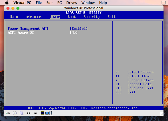

Hi,
here is my screenshot. I have taken these settings. But it still follows the same error message 😡 ?

I've set in bios the same settings as described in my last post. But even in this case VM does not boot from CD too?

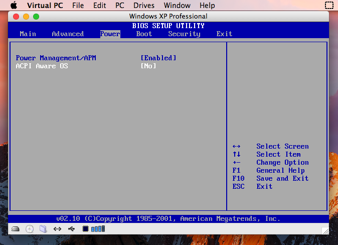

Hi,

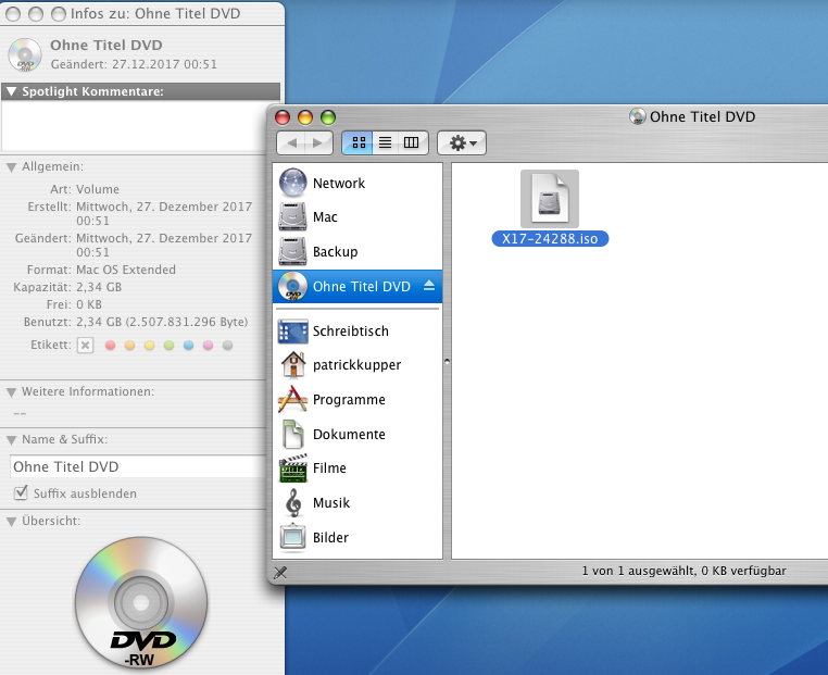

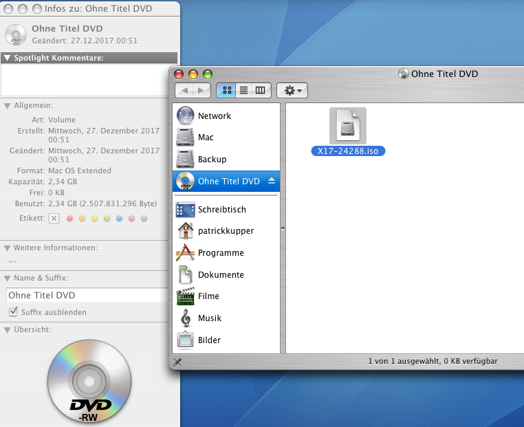

That's the 32 bit version. Attached a screenshot. The DVD has a volume of 2.34 GB and it is an ISO file

You burned the ISO disk image to a DVD-R? It looks like you burned the ISO file to a disc, so that's not going to work...
The Windows 7 DVD should look like this:
I'm not sure, the other forum members might be able to confirm this, I've never been able to boot an ISO bigger than a CD (800mb)
The file is on a DVD. I work with OS X 10.4.1
[doublepost=1514743929][/doublepost]
As you are trying to boot an .ISO you need to go to Drives/Capture CD Image....this will grab the ISO as if it were an actual disk.
