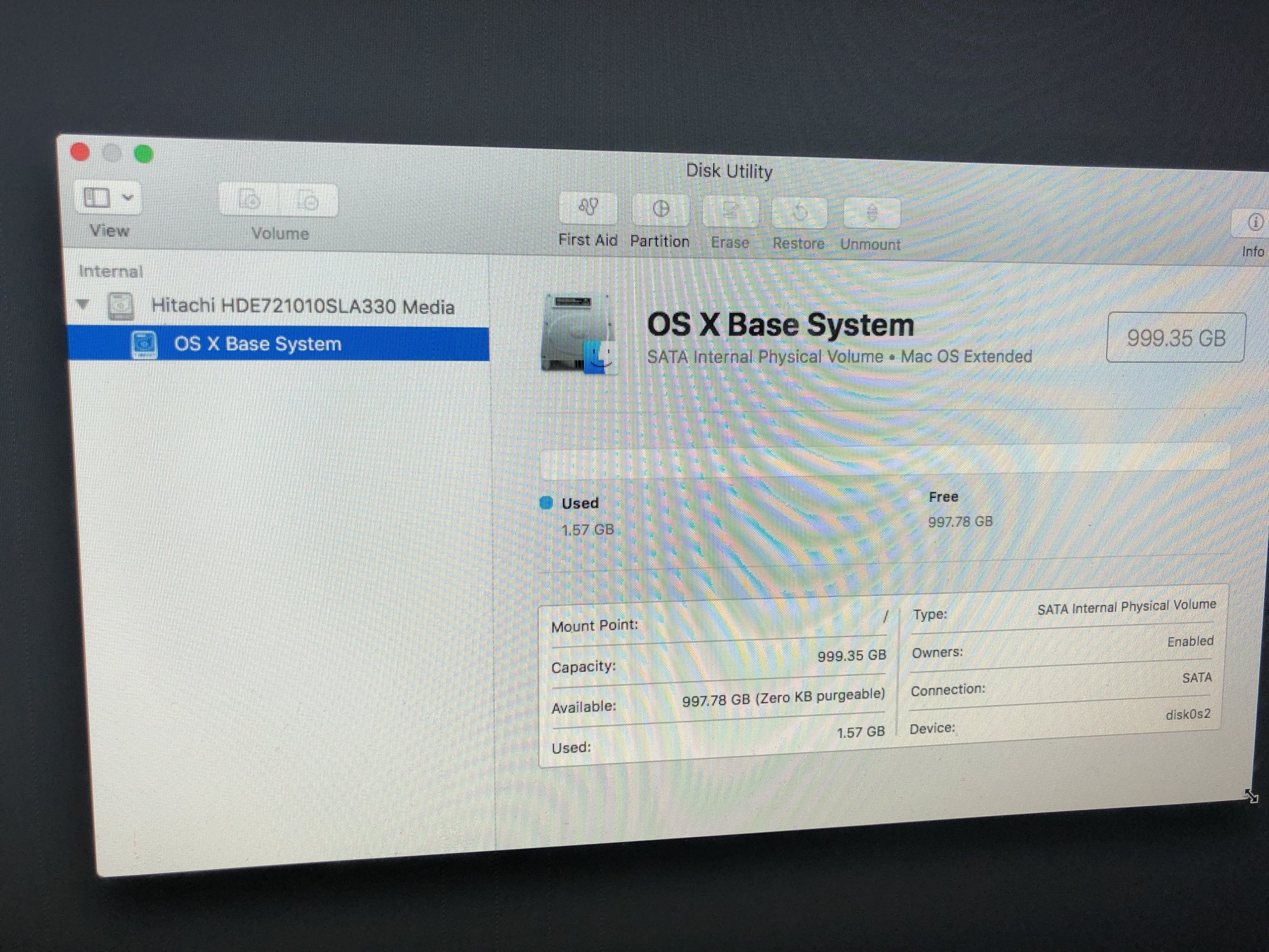

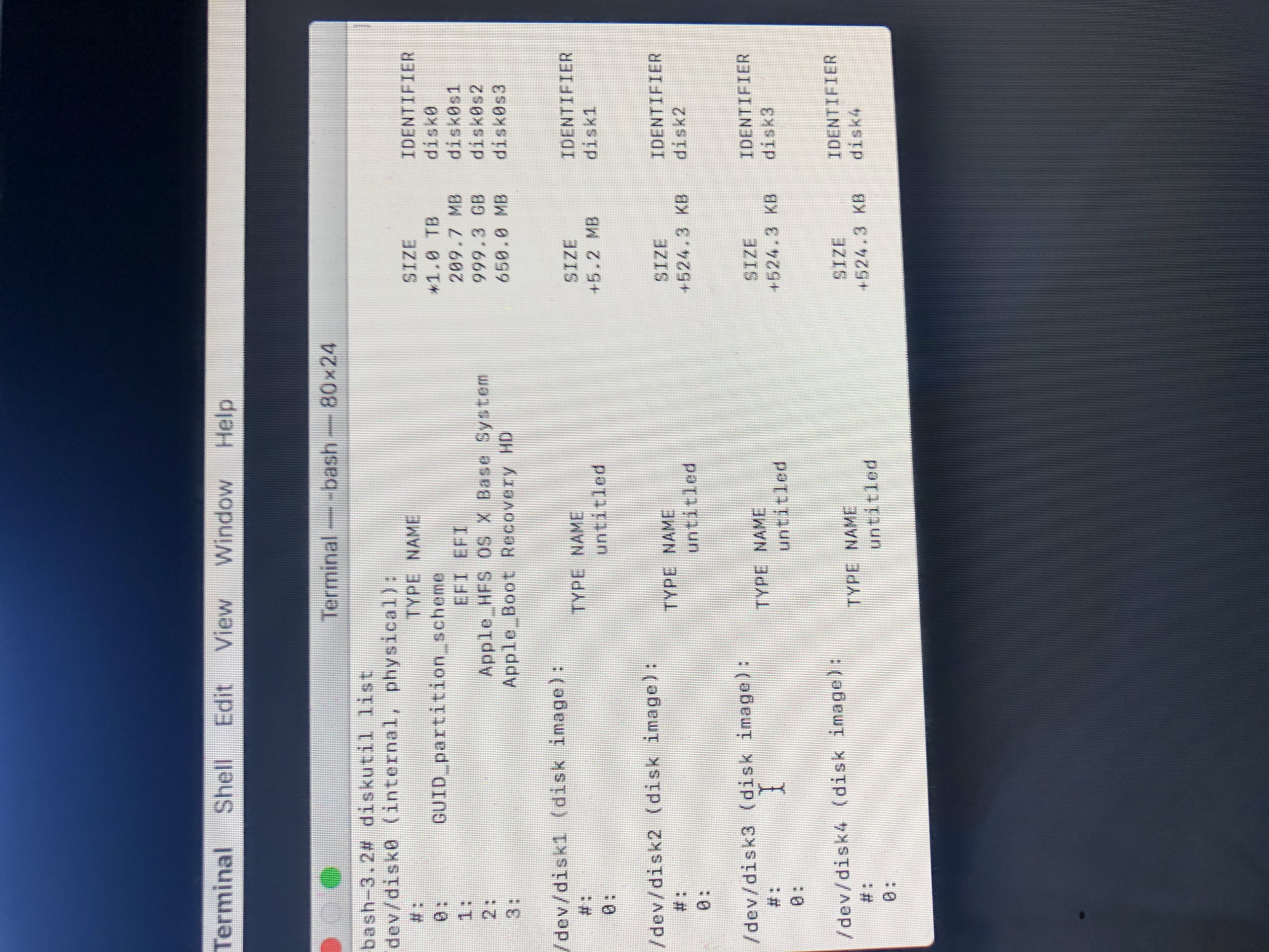

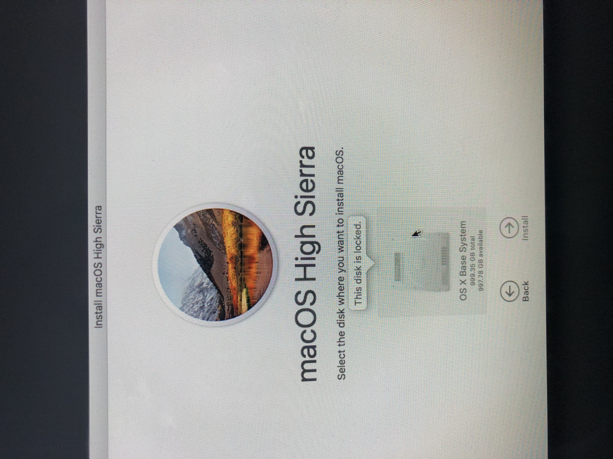

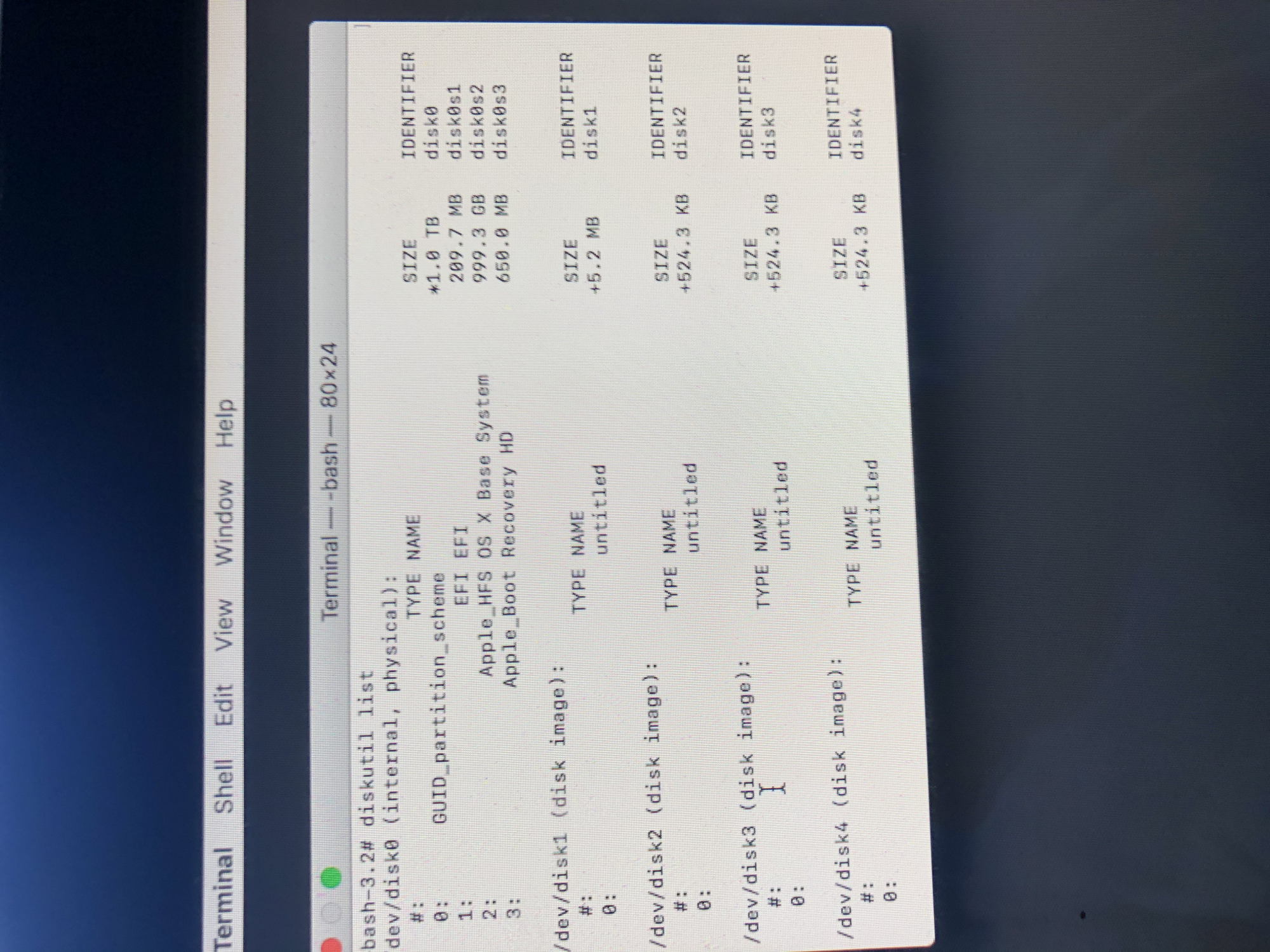

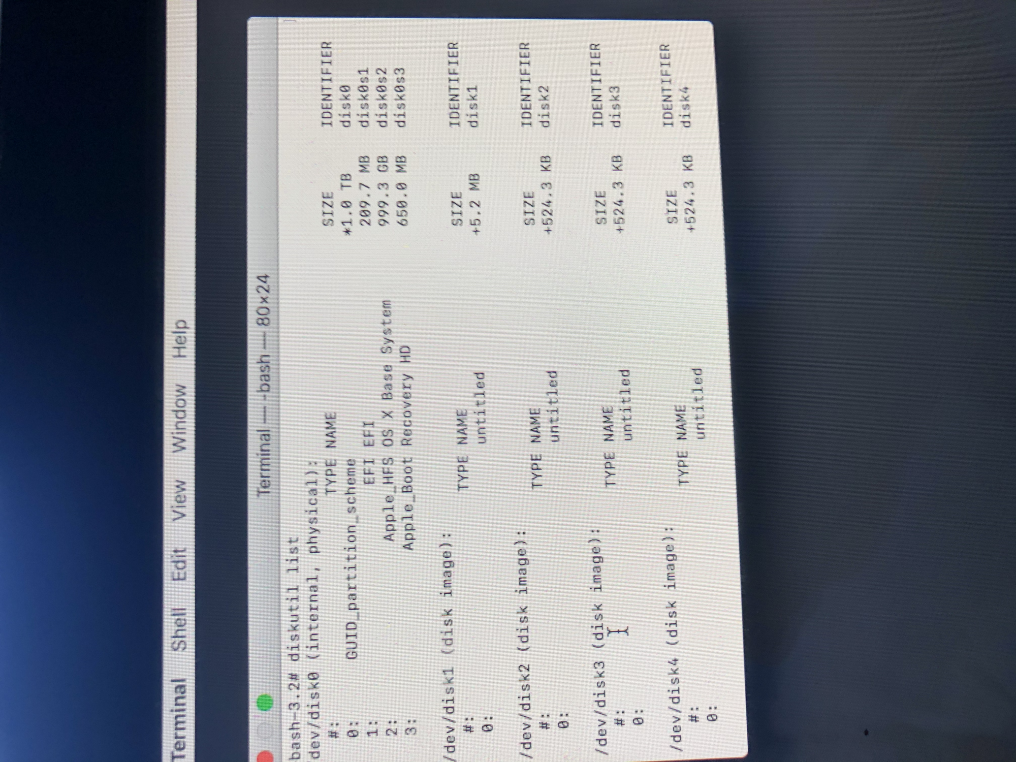

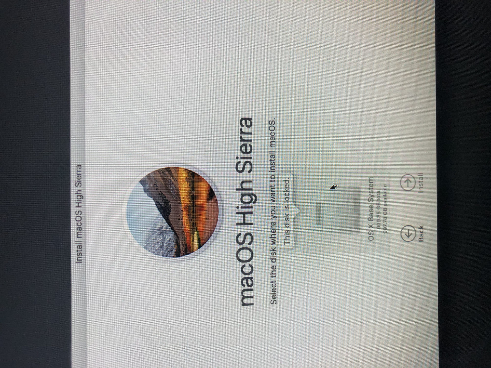

Sorry I am snookered despite following above. reformatting High Sierra iMac - erased HD and now no HD is showing to re-install from TimeCapsule or internet. Tried root directory

Which iMac do you have?
I assume that you have an iMac with the base 1TB, as that shows in your terminal window.
But, there's not a valid system installed...
Go to your Disk Utility.
Does your 1TB hard drive appear in the list on the left side of that Disk Utility window?
Select that, then try to erase again.
If the drive does NOT appear in the Disk Utility window at all, then your hard drive has likely failed.
And, this would be a good time to replace that spinning hard drive with an SSD.
Even if the erase works, and you can successfully install your macOS system again, you still should consider replacing with an SSD. There's just too many advantages over a spinning hard drive!

2009 iMac with a Hitachi HDE721010SLA330 Media HD which is in the Internal drive. Present in the Left hand slot
Rebooting so I could access the backup drive let me unlock the HD and reinstall High Sierra on the Hitachi. I’ll see in 90min if that works!
STILL would recommend replacing that spinning hard drive.
Partly because installing High Sierra will modify the drive format to APFS -- and APFS format is not particularly happy running on a spinning hard drive.
Reactions: wil_thornton
