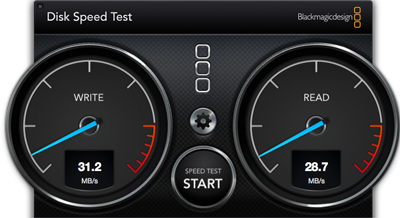

The 802.11ac is only ~30MB/s which isn't too bad for wireless.
40MB/s (x8 for bits)= 320Mb out of 1000 (gigabit connection) is terrible. The 802.11ac is only ~30MB/s which isn't too bad for wireless.

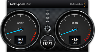

Here is what I get on gigabit ethernet
And this is 802.11ac wifi on my 2013 MBA

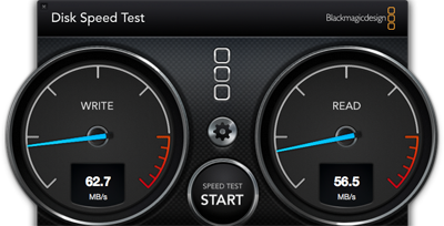

I don't really agree that 30MB/s "isn't too bad" though. Here is what I get on the same network connecting to my Mini on 802.11ac wifi. It is twice as fast as the time capsule, and even faster than gigabit ethernet on the time capsule. Not really complaining, the Time Capsule does what it should. But it ain't no speed demon. 😉
thats about what I get if I capture the screen at peak.
But still if you could maintain 49MB/s constantly thats only 400 Mbits/s through a gigabit port, can't be that much over heads.
Wow connected to the mini is fast. Im starting to think its just a dumb router and doesn't have the processing power or something to go faster.

The Mini is connected to the Time Capsule with gigabit ethernet, so there doesn't seem to be any speed problem with the router function, it's just a slow disk (or slow disk interface?) in the Time Capsule. Sorry, I don't know how to view S/N ratio. But these tests were done in the same room, about 3 meters from the Time Capsule, using the 5ghz band.
I have several Seagate Desktop Backup Plus USB3 3TB drives. They clock around 160-170MB/s on my MBA. I have a bus powered USB3 Passport Ultra drive that does a little better than 100MB/s. But my old USB2 Passport bus-powered drives only get around 35/MB/s.

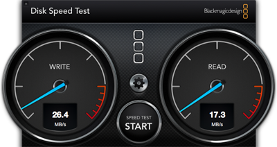

If you think the Time Capsule internal drive is slow, try connecting an external disk to the USB port. Using that same 100MB/s disk, this is what I get over gigabit ethernet. 😱
It's not the drive as I took it out and put it into a HDD dock connected to comp via USB 3.0 - it's definitely the time capsule and it's interface. Makes it sort of pointless to use as a back up if speed is important since a USB 3 connected directly sends/receives data much faster.

I have a Mac Mini running file sharing. It is connected to the Time Capsule with hardwired gigabit ethernet. I used a wifi connection from my 2013 MBA to the Time Capsule which is in the same room. I mounted one of the Mini's disks on the MBA and ran the disk speed test. The Time Capsule was only being used as a router.
